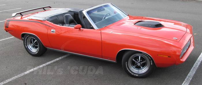

The tire size are BFG 255/60R15s on the rear and 235s on the front with 15x7 Magnum 500 wheels. 727 auto w/3.23 rear

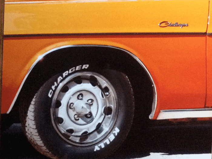

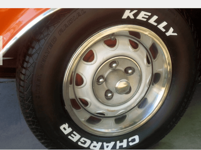

Pretty simple for me on my SL6 '70 Challenger. I'm still running the same 14"X5.5, Rallye wheels that the car rolled off the assy. line with. Except for a 10 year hiatus with some General Lee type American Eagle Vortex aluminum's in 14". I'm back with the Rallye's restored w/ P225X60x14, RWL, Kelly Chargers in front and P245X60X14, RWL, Kelly Chargers in the back. They look good and give it that nostalgia back in the day look. Thanks, Al
