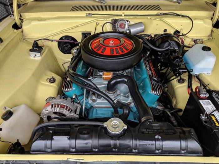

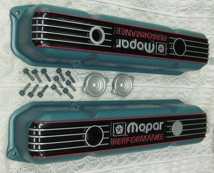

Your valve covers look great.
Powdered coat sucks for a restoration. This is why. I’ve been told the person who applied it did it wrong. That may be true but I can tell it on cars and I don’t like it.
it’s too thick
it’s not smooth
It changes the look of the surface of parts
It changes the shape of parts
It doesn’t get in tight spots
It doesn’t build up on the sharp edges of metal
Brake cleaner will discolor it.
It cracks off suspension parts when bolts are torqued.

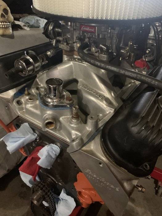

I powder coat just about everything that fits in my oven. I even bought the wrinkle black powder and did the air cleaner on my Challenger.

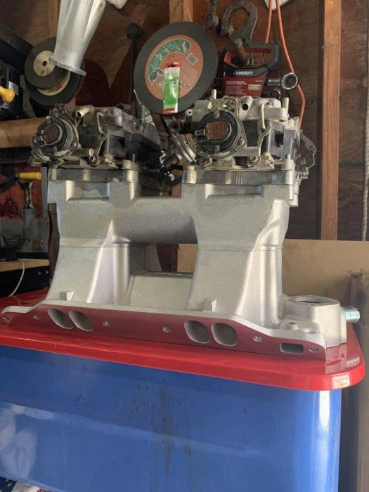

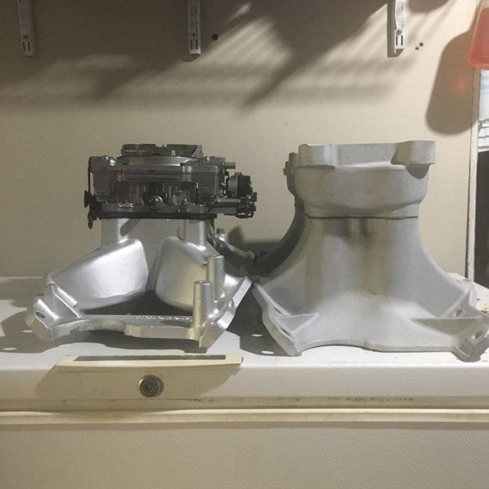

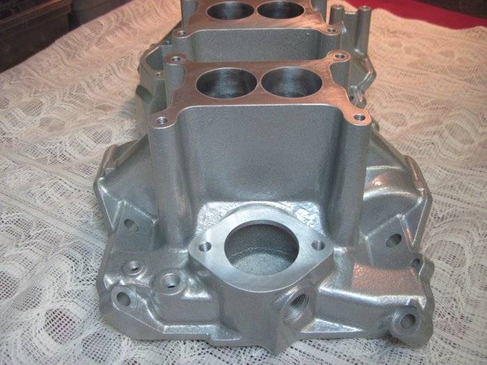

A rattle can painted Victor, a sand blasted TR and below that, a never used W2/TR. A well used Holley Street Dominator. Note the color variances.

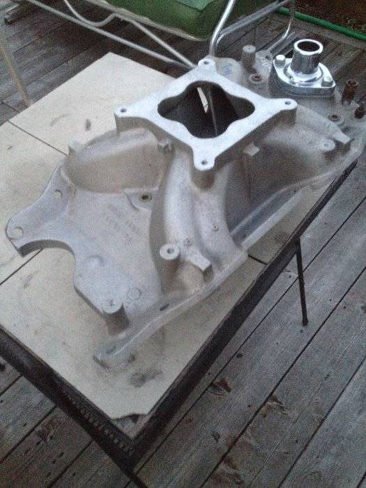

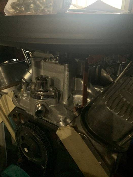

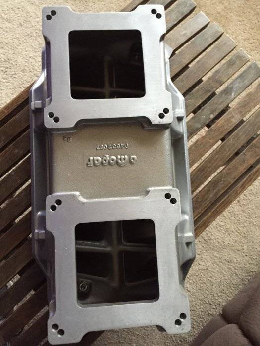

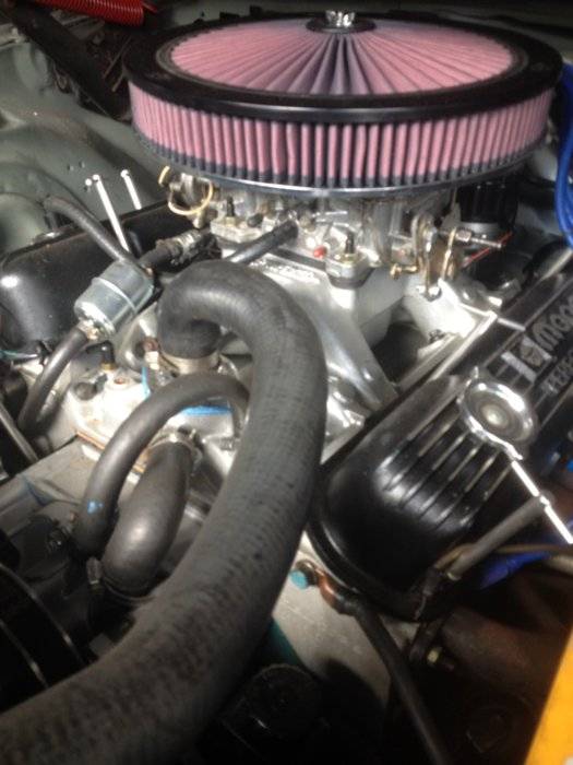

Top picture is when the RPM-AG was first done when LeAnna first opened up her doors, second picture was just taken to show how it is today. Not even cleaned after some (years of) usage.
Leanna, your going to have to date when I had this intake and the W2 Holley Street Dominator done. And if you happen to have a picture of the finished Holley, which is not on my phone.
