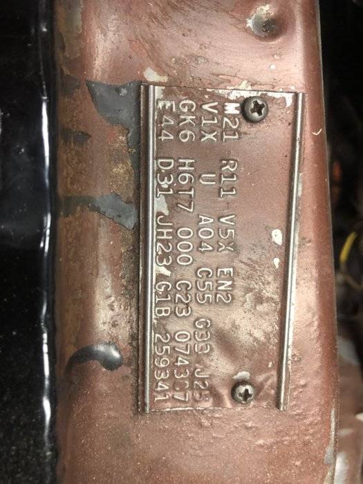

Can you post your fender tag, I like to decode tags.

Here is the tag....what are the moldings you speak of?

V5x are the black moldings that run the center line of the car on the side. They are what protect the car from other door dings.
Usually they don't get put back on. And torn up during the removal process. V5x is what is on your tag but your not going back with GK6 autumn bronze metallic.
If your making your interior black instead of the tan that is on the tag I would be more than happy to work with you on the saddle tan colored parts as well. Instead of you painting/dying them black

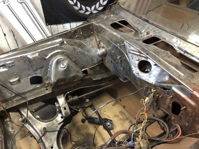

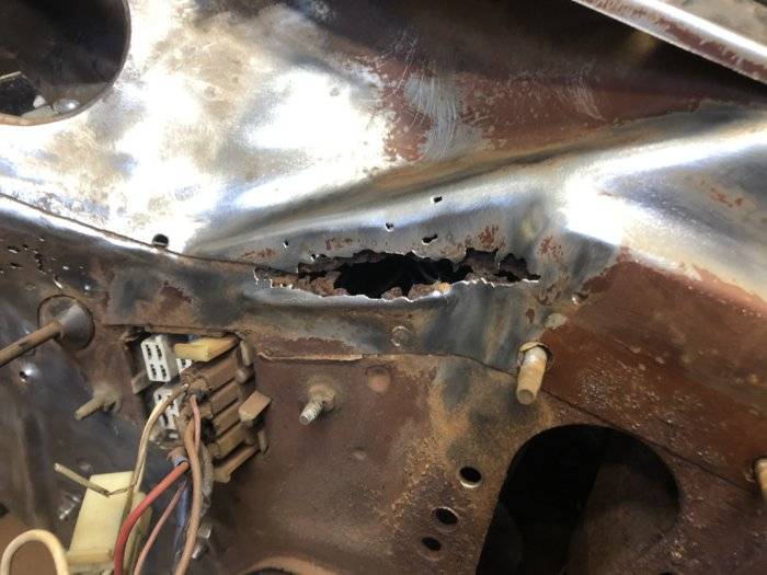

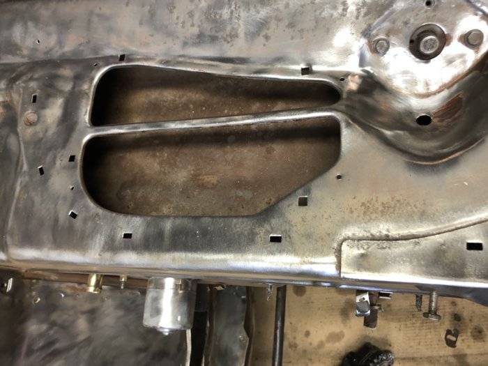

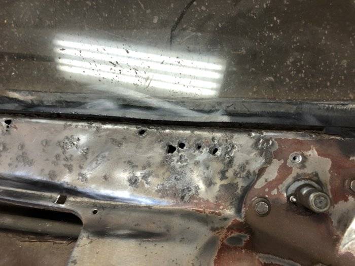

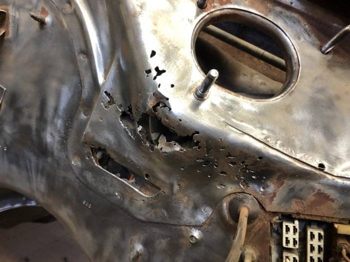

Engine Bay Progress....looking for ideas to patch the areas around the wiper motor....don't want to rip out the entire fire wall. I am on a budget like all of us....any ideas???
Cuda Hunter
3,564
1,376
high mountains Colorado
Your going to have to form your own pieces there.
Or you find someone with a parts cuda and purchase just that part cut off the firewall.
I think you have to buy the whole firewall from AMD. Someone correct me if I'm wrong. I can't find just the WW motor section alone.

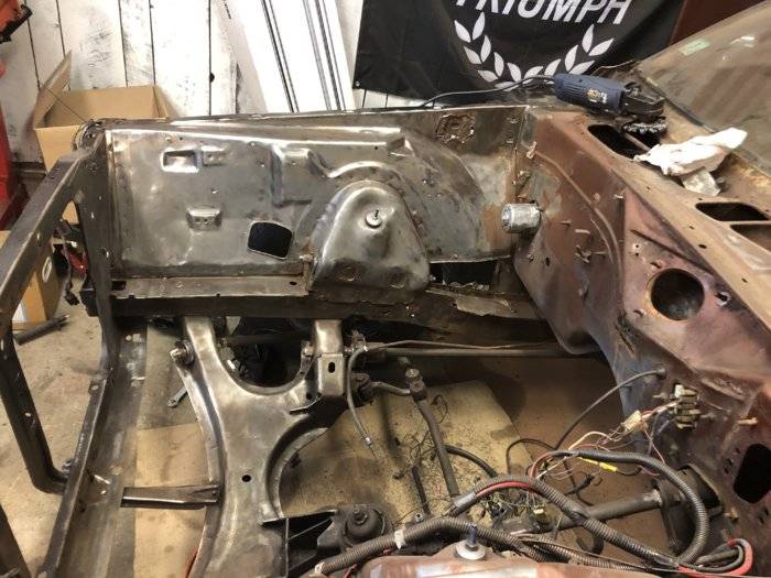

I have my engine bay and front frame rails coming along down to bare metal. I was planning to do a POR 15 treatment on everything including the K Frame, then have it painted. Thoughts on this approach? TJ
Cuda Hunter
3,564
1,376
Don't do it. Por15. opinion of course.
I've had rust issues under por15.
I know, I know, musta been a non cleaned surface under there right.

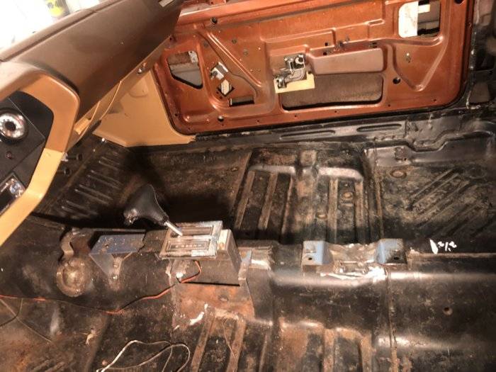

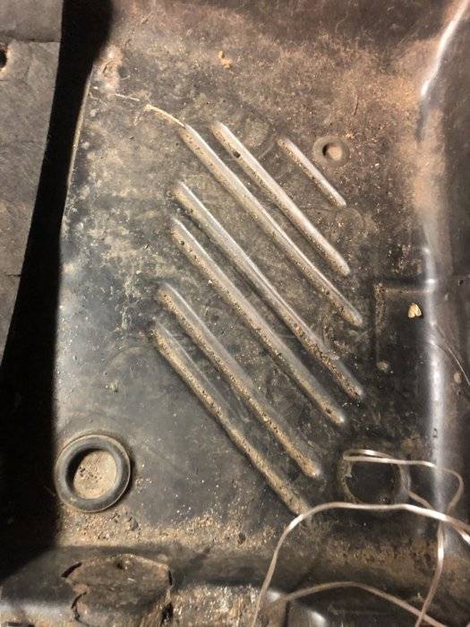

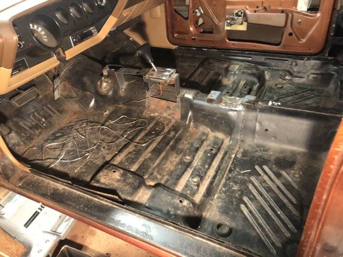

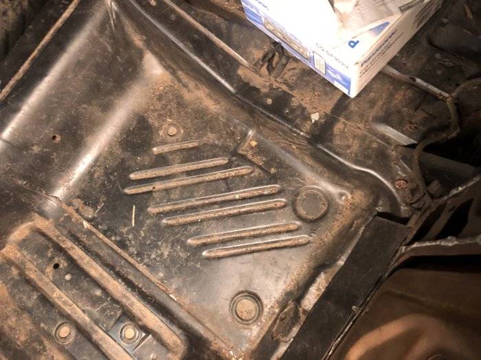

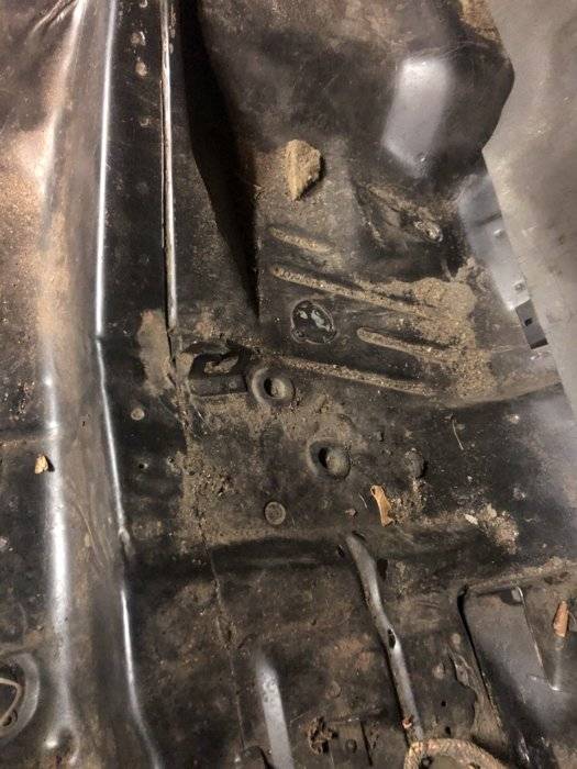

2 good days while off work. Engine Bay stripped. And ripped out the interior as well and all carpets. Floors are an B+. Need about 5 patches the size of my hand....
