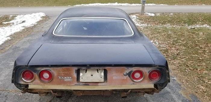

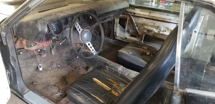

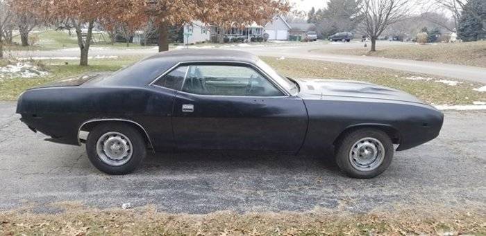

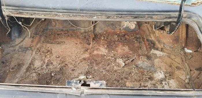

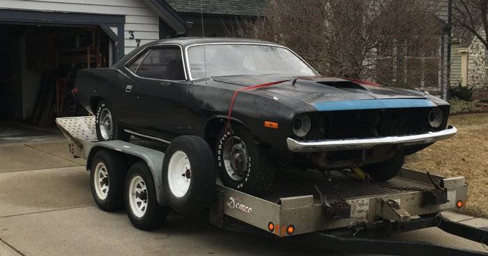

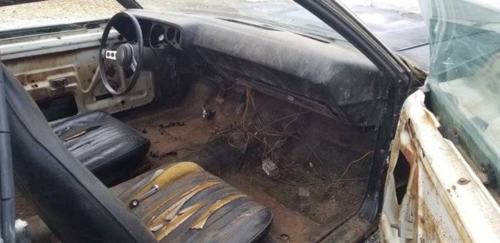

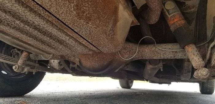

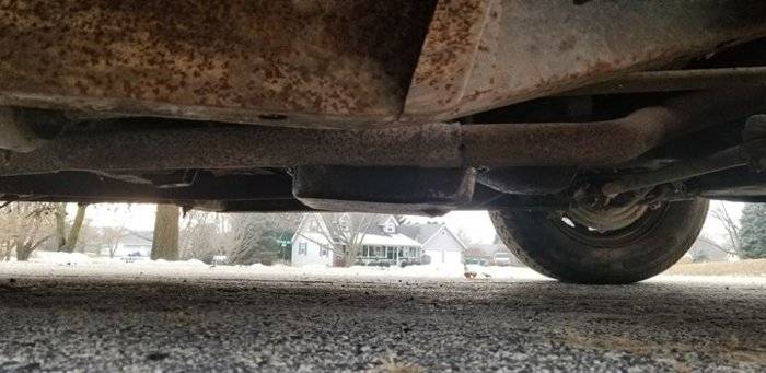

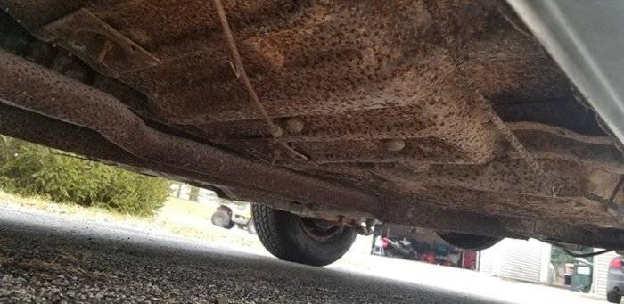

Here is all the pics of condition and current state. Lots of surface rust, dirt/dust. Lot of long hours coming but well worth!
moparmike1974
Nov 12, 2018
9
Must have been sitting in a field or in grass. The bottom of that car looks scary.
Interesting to see a column shift E body.

You know, the pictures make it look worse than what it looks like in person. We vacuumed it out before we put it on trailer and it changed look of it a lot. Underneath a lot better in person. It was just a really dirty car. I was scared too, but most is surface rust. Suspension parts, tank, are all rusty, but brakes looked good but I never planned on keeping any of it. It just needs a lot of grinding and surface treatment. Cleaning. Most of those parts but shell mainly, are getting replaced.

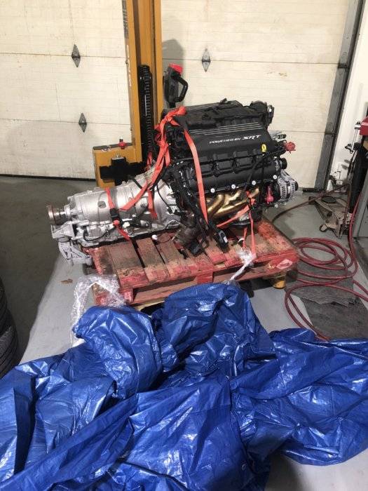

She is doing well in body shop. Got engine ordered and in. 2017 challenger 6.4 srt engine with 8 speed. Getting a custom standalone tcm to work with mopar plug and play. Ordered front suspension and oil pan. We are about a month out, from starting putting her back on the road!

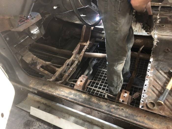

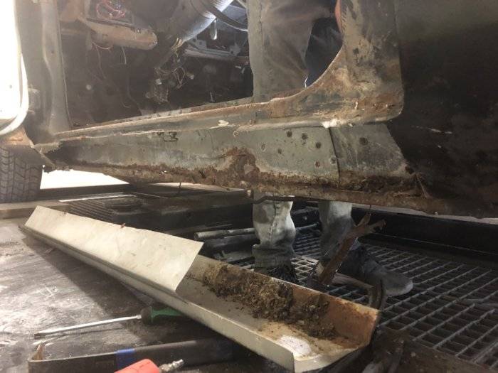

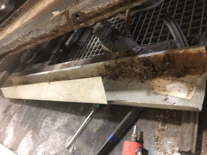

So car is in body shop. She is in better shape than we all thought, but spending some extra time and effort to get her perfect. Added some extra work to the body since we are there. Here are some update pics!
1/8/2019 1/28/2019 2/01/2019 2/15/2019 and 2/27/2019 3/21/2019 order dates for all the major stuff.
Following parts are ordered and already started arrived and being installed by body shop.
US Car Stools Stiffening Kit
Two Quarter panels from AMD
Rear Balance from AMD
front bumper from AMD
Rear bumper from AMD
Bumper and valance Bolts
Floor Patch Panel, Front, 1-piece, correct Flanged Edge from AMD
Rear Floor Patch Panel left and right from AMD
Under Rear Seat Pan from AMD
Rear Trunk Floors from AMD
Driver Rocker Panel from AMD
Waiting to be put on but ordered:
Seat Brackets by Planted technology-In
Front Chin Spoiler spoiler-In
Painless Wiring Harness-In
Optima Yellow Top Battery.-In
6.4 Gen3 with 8 speed-In
Hotchkiss Rear suspension-In
Milidon Oil Pan and Pick up-Not Delivered
RMS Alterkation front suspension-Not Delivered
Mopar 392 Crate Kit-Not Delivered
Custom 8 speed StandAlone Controller-Not Delivered
