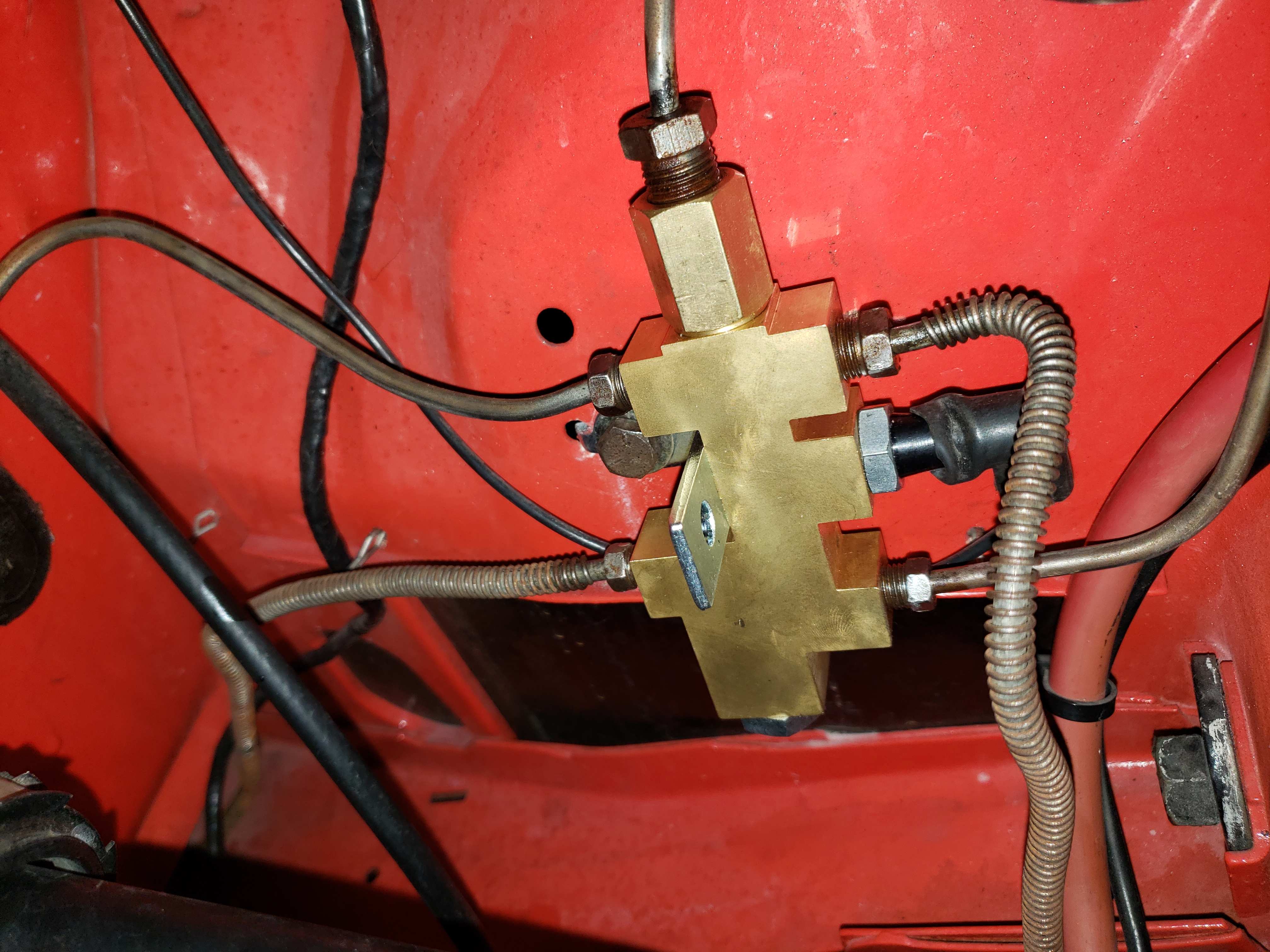

I found the distribution block on the car was for drum brakes, so I replaced it with the disc/drum one. Same result. I would consider an adjustable prop valve but am squeamish about cutting/running new lines for it. Would a different master cylinder be better? Not sure what is currently on the car.

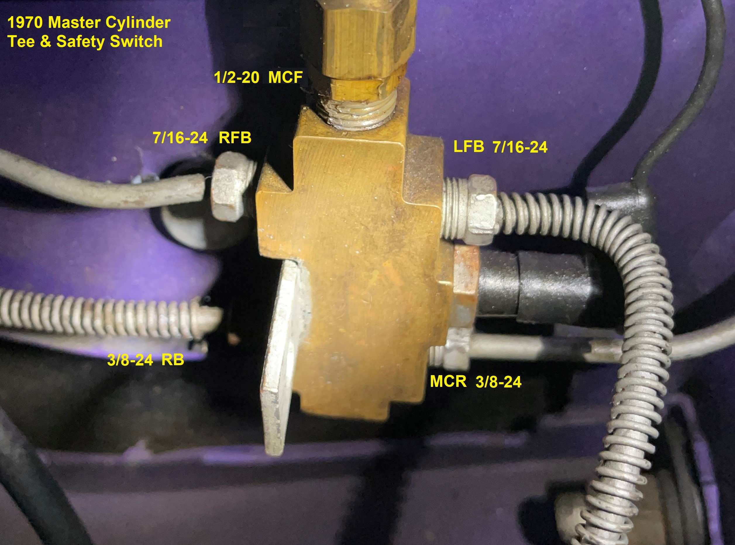

Ok need a picture of proportion valve meter block. let see what you have. Did you reset you brakes before bleeding? https://www.forebodiesonly.com/forum/attachments/brake-valve-jpg.82222/

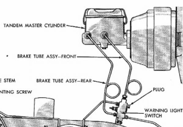

72 I'm going say you don't have a front block with the reset. as in the picture I posted. 73 was a different proportioning valve as I remember. The master cylinder has to be the correct one too. The master cylinder has a residual valve that keep 5 to 7 psi in the rear system. if it is not working correctly the brakes will lock up. I am not saying that the proportioning valve is good or bad. It can be taken apart carefully and cleaned and inspected. If there ever was water in the system even a drop. the valve will not work right. Dot 3 will attracts moister . It might be just stuck! The are a few post on brake problems here. If I find them I will link it. Or others may jump in.

72 I'm going say you don't have a front block with the rest. as in the picture I posted. 73 was a different proportioning valve as I remember. The master cylinder has to be the correct one too. The master cylinder has a residual valve that keep 5 to 7 psi in the rear system. if it is not working correctly the brakes will lock up. I am not saying that the proportioning valve is good or bad. It can be taken apart carefully and cleaned and inspected. If there ever was water in the system even a drop. the valve will not work right. Dot 3 will attract moister . It might be just stuck! The are a few post on brake problems here. If I find them I will link it. Or others may jump in.
Thanks. The original distribution block on the car and it was for a drum brake car, so thinking maybe the car came with drums. Dunno. I got this one just this week new from Dr Diff. I'm using DOT4 fluid also.

Being a new proportional valve I wouldn't think that would be the problem. but you never know. I would look at the master cylinder residual valves or pinched line.
