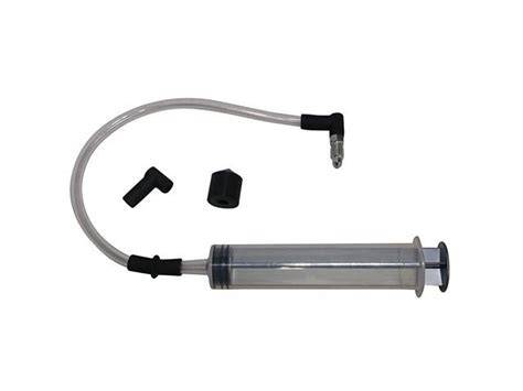

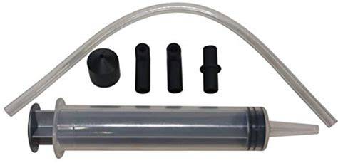

Force bleed next. there are other tools.
