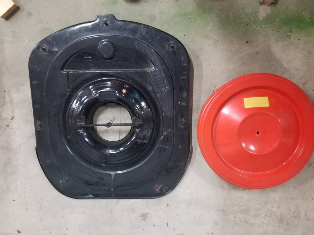

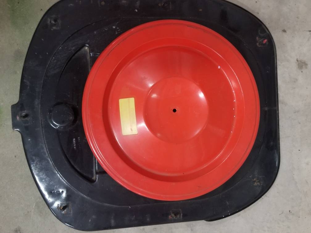

My buddy in PA has an original stock Shaker base plate and cover off a 70 Cuda.
I am told these originals were made in Canada by Fram.
Not a reproduction. Very rare, original paint, for 4 bbl.
He would sell for $1000.

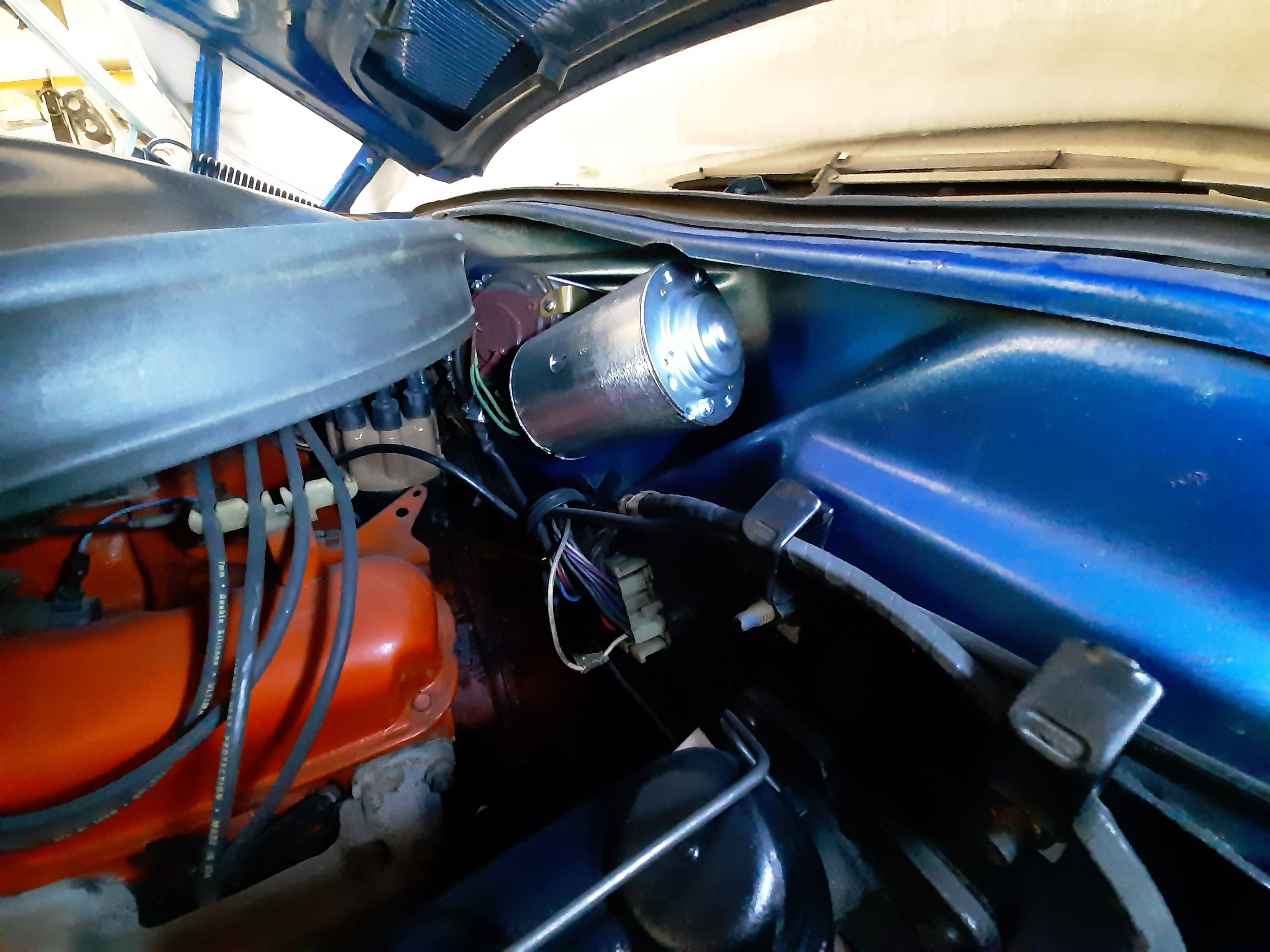

Why 3 speed because of clearance?
terrywalker
Aug 31, 2013
392
214
Yes, because of clearance of 2 speed wiper motor. Here's a side shot of my 340.
