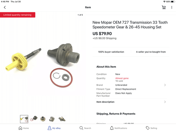

If fluid is coming out of the cable it means the cup seal on the gear shaft is bad. I wound up buying a whole new gear assembly since the shaft was worn. Drain tranny fluid before removing unit. Bought mine on eBay.

I'll take a look on Ebay. I know the gear is green. I'll count the teeth.
