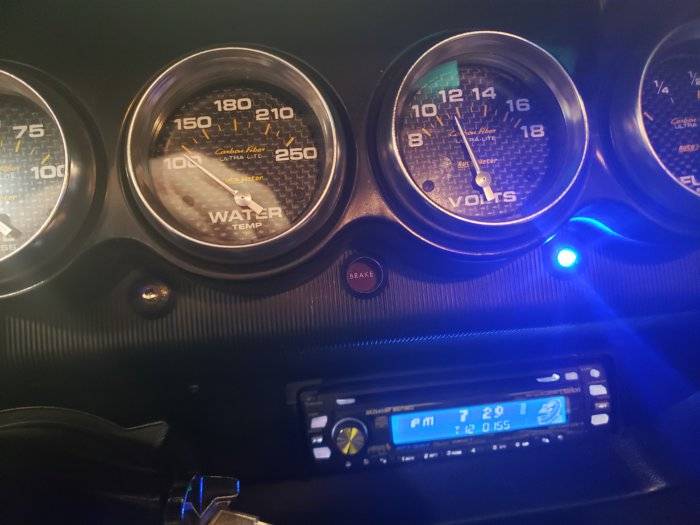

ProSport... unrelated to the steering wheel question... i really like the custom gauges in your dash... did you do that work yourself? if so, can you share some details on what you did? if not, who did it?

Rogue, the dash was finished when I bought the car, it is probably an aftermarket piece but I have no idea where it's from.

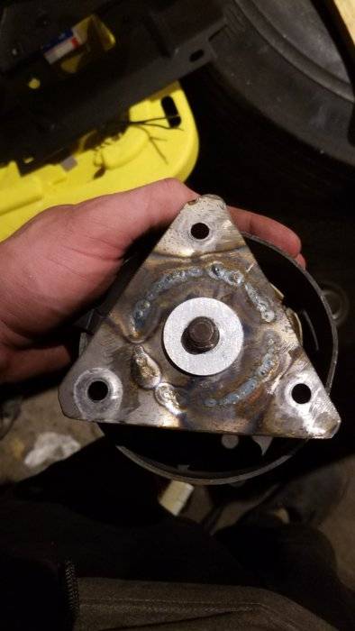

Grant adapter is pretty good. The horn mechanism is chincy junk though. Has a spring that is to stiff and mounting that is not very good.
Horn cap has a habit of coming off due to to much spring pressure and then your horn is stuck on.
Think the stock horn stuff will transfer over from what I been told. Not done it myself so not sure. I just cut down the spring in the Grant kit.
If you want the wheel closer to the dash you may be able to take off and just not use the spacer if your car has one. But that will give you more like three inches difference. Turn signal switch may also need bent slightly to clear the wheel.
I think those are Auto-meter; aren't they?
ProSport
Nov 26, 2016
84
9
Yes they are Autometer carbon fiber gauges. I thought he meant the gauge cluster that holds the gauges. This is my first Ebody so I don't even know what the stock dashboards look like.

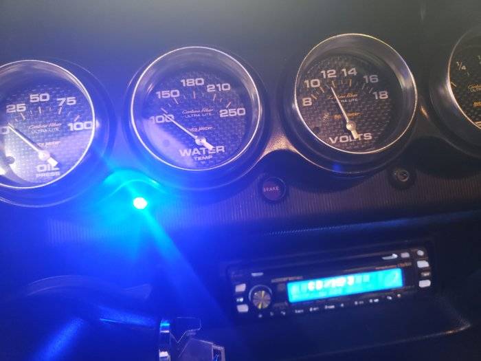

i was actually interested in the mounting of the gauges, not the brand... i'm interested in doing something like that on mine and was hoping to gain insight into how they're mounted

Yes, me too. I checked into it once.
I think if I remember correctly they slide right into that gage slot AND are made for the correct size and have a mounting bracket of some kind for the rear..
Fairly sure A/M knows and u might message them on ebay to double check...:)

Yes the gauges slide tightly into the cluster housing, then the aluminum autometer brackets hold the gauge in place on the backside.
The small gauges are 2 5/8 and the large speedometer is probably 5" but I'll have to measure it.
I found black plastic plugs that fit the holes perfectly where the old dummy lights went, I drilled a hole in them and installed an LED light. Came out great.

nice!!! thanks for the info... i've been looking at 2 5/8 inch gauges on autometer's site this evening
