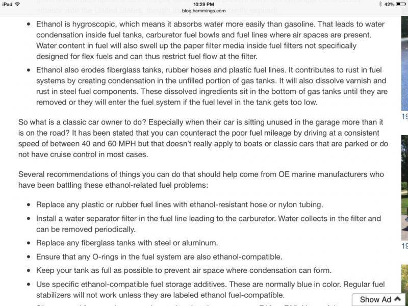

here you go mr.racer 57.
http://www.edelbrock.com/automotive...1000/performer_thunder_carburetors_130815.pdf
second page, at the bottom.
