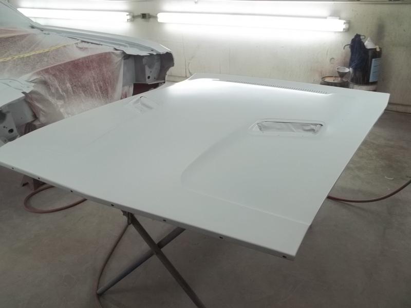

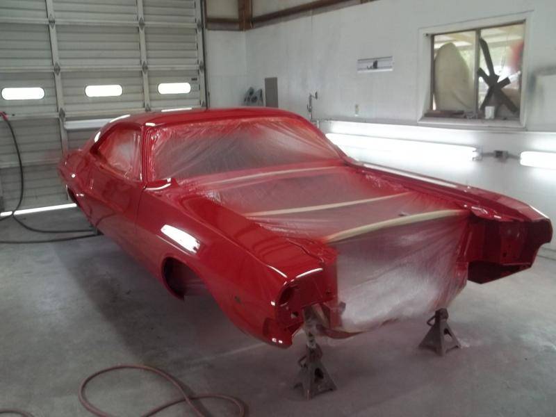

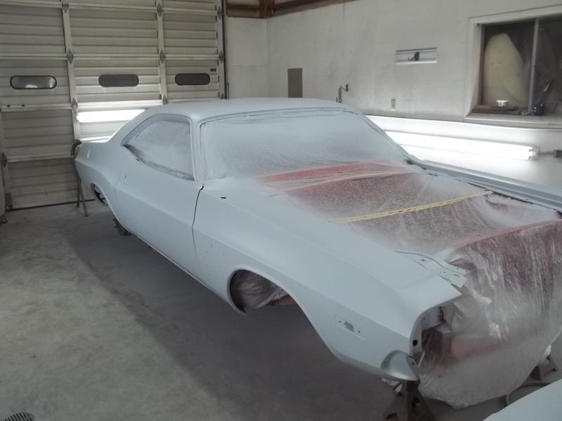

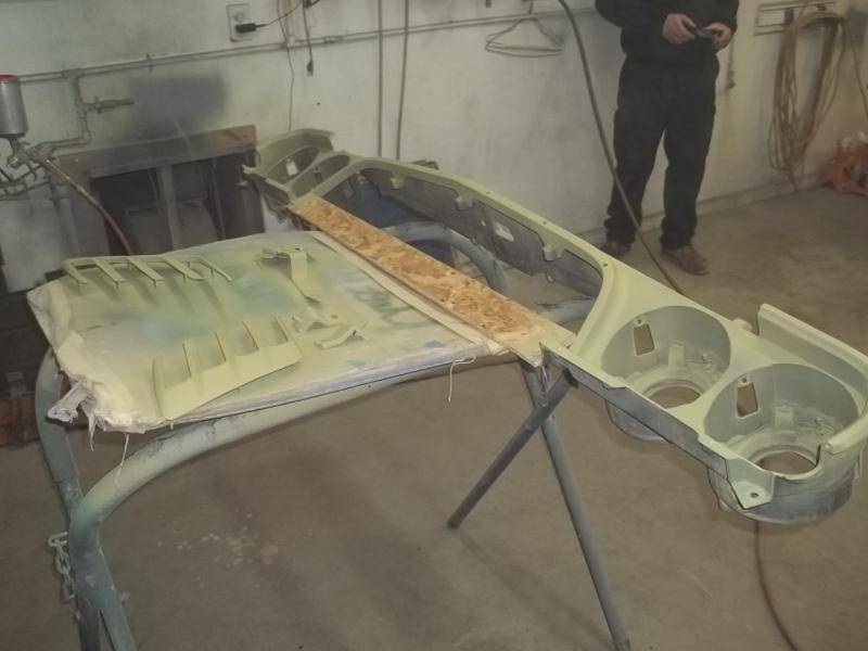

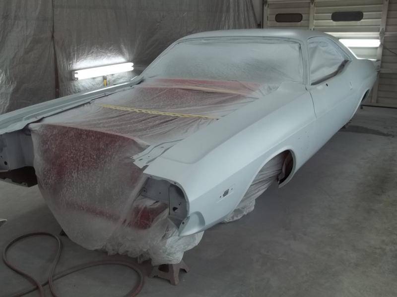

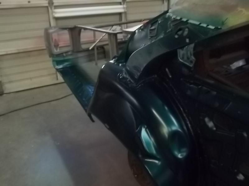

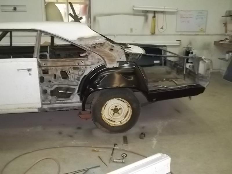

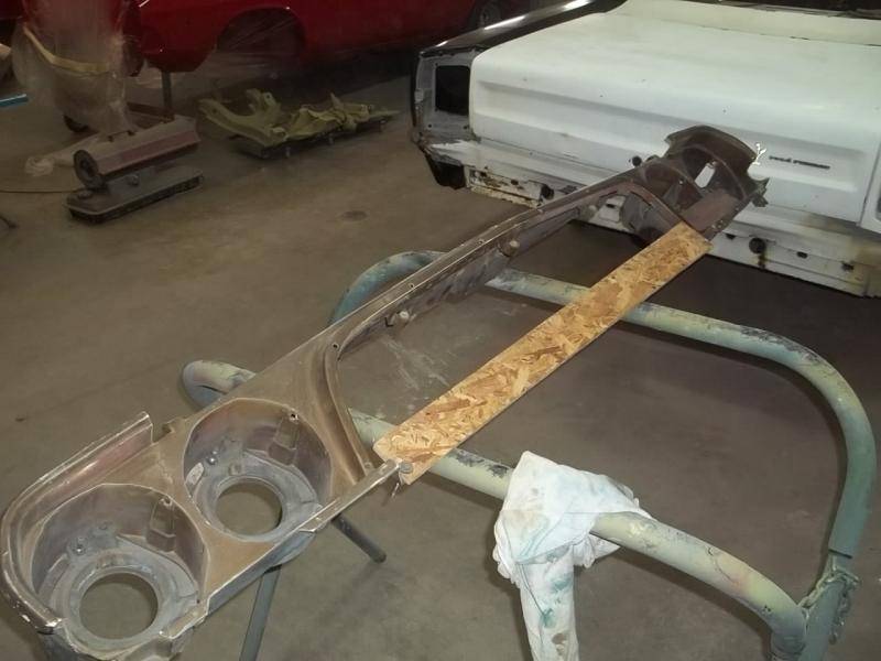

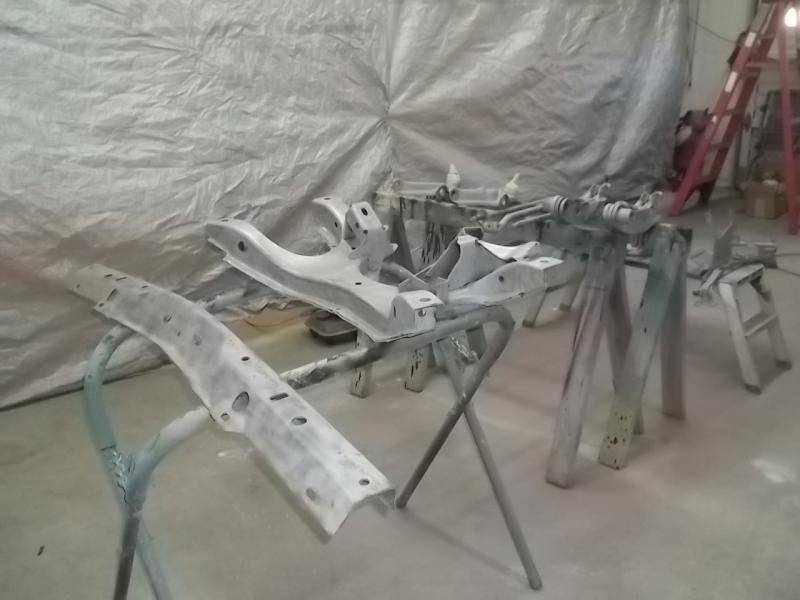

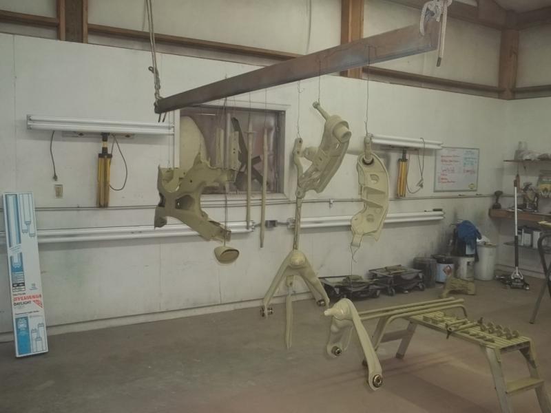

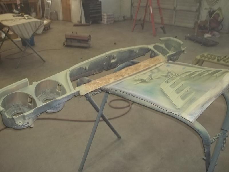

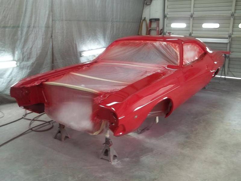

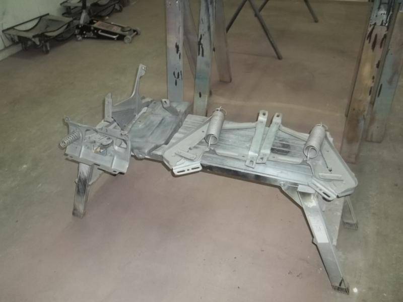

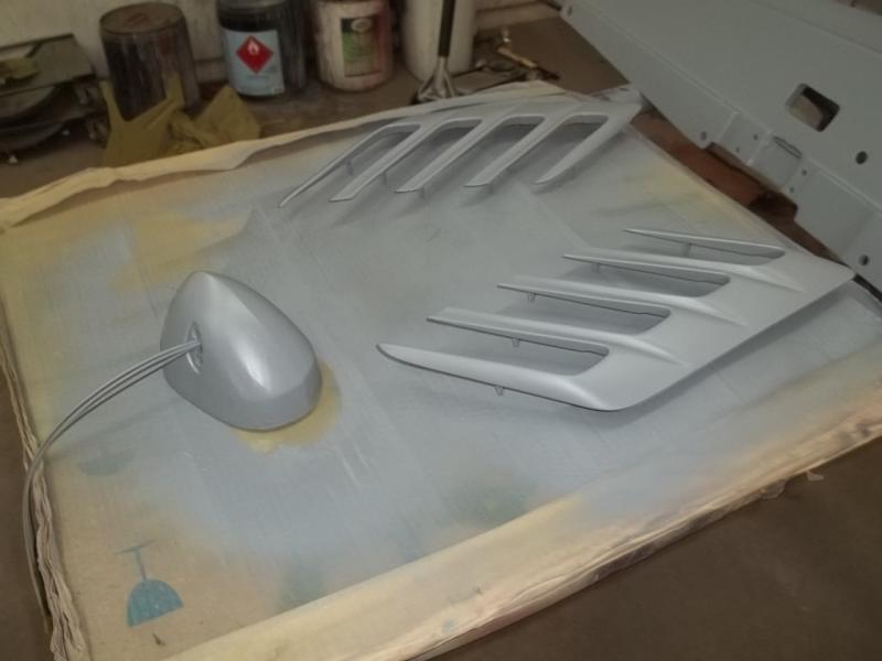

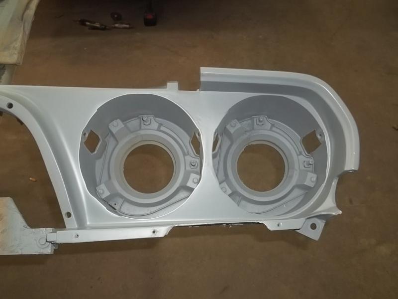

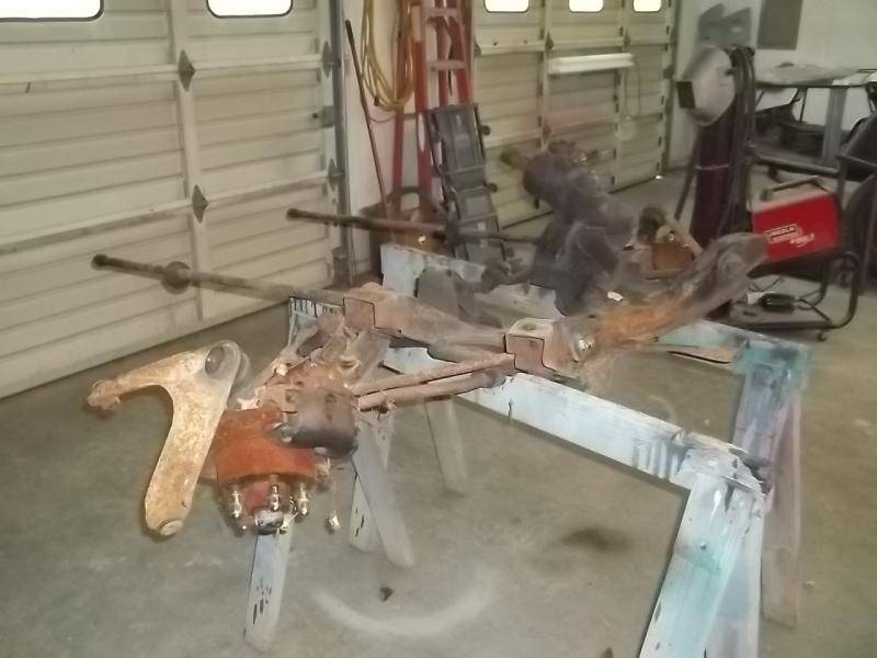

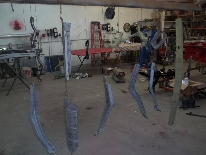

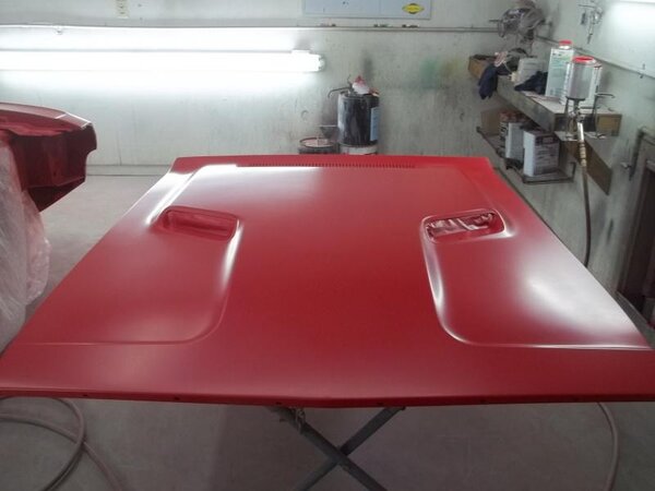

just a quick update not too bad i guess! 100_4085.jpg100_4110.jpg100_4117.jpg100_4107.jpg100_4121.jpgONFIG]10036[/ATTACH]100_4057.jpg100_4067.jpg100_4075.jpg

Looks great but sad to see the thread coming to a close. I have used this as a reference many times. I'm battling a used hood now trying to salvage it. It was banged up on the left front corner and had a patch welded in under it. May need to just get a reproduction. Thanks again for the thread.

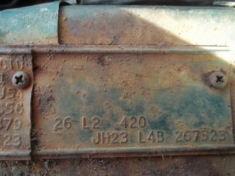

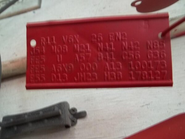

she is far from over btceng! i still have all of the driveline, interior and, electrical to do!!!!!! and while i'm at it i would ask if someone could decode the tag for me. i would really appreciate it!!!! thanks in advance..........postcar. btw btceng, does your handle mean batallion cdr, engineer??????

DetMatt1

EN2-?
J54-Sport hood
M08-simulated fender/door louvers
M21-drip trough mouldings
N41-Dual Exhaust
N42-Bright tips
N85-Tach
FE5 & FE5-Red w/red painted top
U-?
A57-Ralley package w/includes hood, stripes, ralley dash, black grille, louvers, HD susp. and F70 X 14" WSW tires.
B41-power front disc brakes, rear drum
C56-Buckets
G36-Remote painted driver side mirror
A6X9-Black vynil buckets
E55-340
D13-3spd stick
JH23H3B-Challenger hardtop, 340, `73, Hamtramk built.
Nice car and I'm suprised it's a 3spd stick car, one of 279 with that transmission.

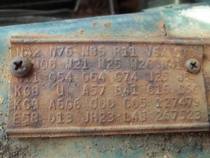

thanks again Matt! if you don't mind, i'd like to put up another one for you. if you would, put an ok up on here and i will post a picture of them!!! I really appreciate the comments, they are good moral support! and also John, it may not be so glamourous, but hillbilly's and farmers need phones too!!!!!!!

Ok, no problem. Some people like crossword puzzles, I like a good fender tag or a build sheet and that tag is a good one! Nice car!

Being from the land of salt (Vermont) it looks like a creampuff.

N42-bright tips, N76-coolant recovery sys, N85-tach, R11-am Radio,V6X-long sport stripe black, CTD-continued on 2nd tag, M08-simulated door/fender louvers, M21-drip rail mouldings, M25-sill mouldings, M26-wheel opening mouldings, N41 Dual exhaust, G11-tinted glass all, G54-LH remote chrome racing mirror, G64-Rh manual chrome racing mirror, G74-both chrome racing mirrors, J25-3spd wipers, J54-sport hood, KG8-Sherwood green, A57-Rallye package, B41-power front disc brakes rr drums, C16-console, C56-buckets, A6G6- white/green vinyl buckets, C05-Friday may 5th of `74, E58-360/245, D13-3spd floor stick, Hamtramk built, 26" radiator, L2-end of codes on assembly line 2 tag. Not sure what the 420 stands for as it pertains to that 2nd tag anyway...

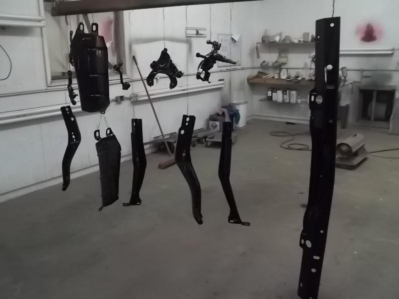

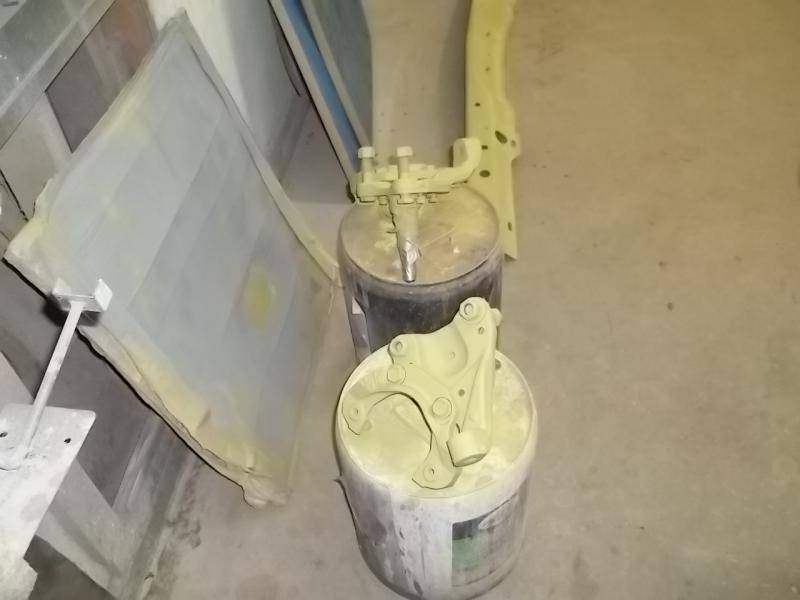

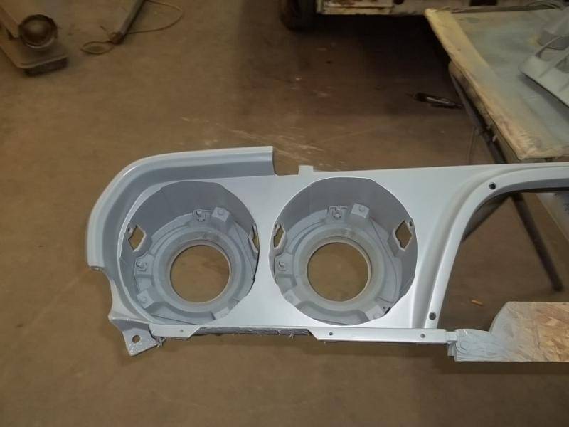

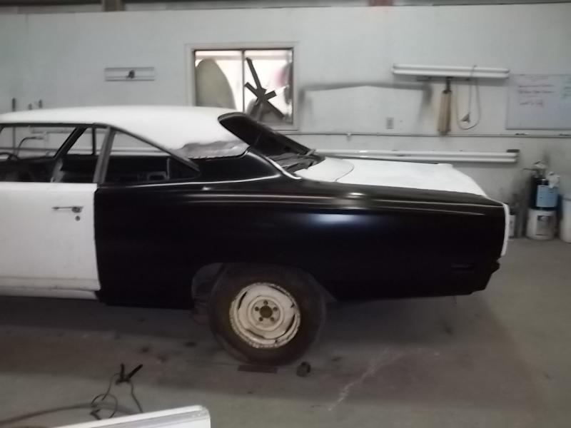

sorry for the lag time on the update. but I first thing I would like to do is thank Matt, your help will be immeasurable. on to some pics.

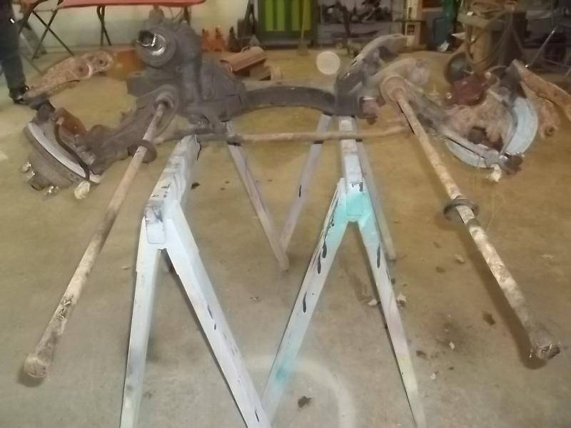

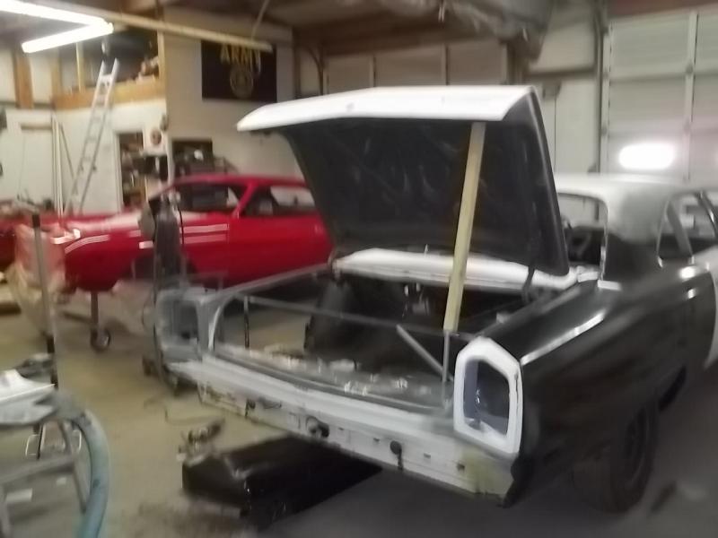

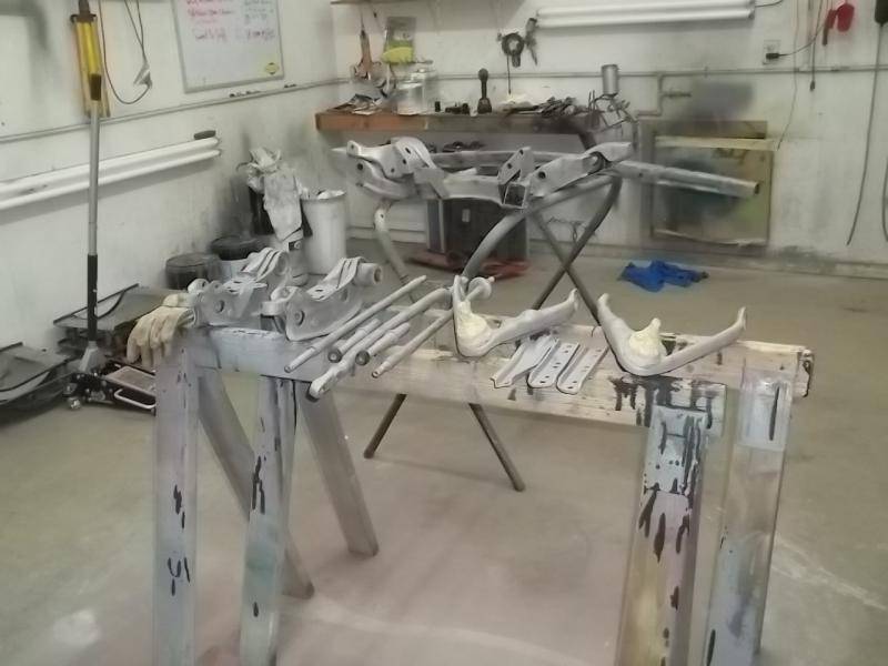

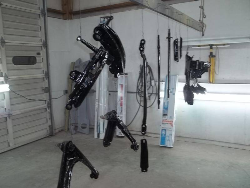

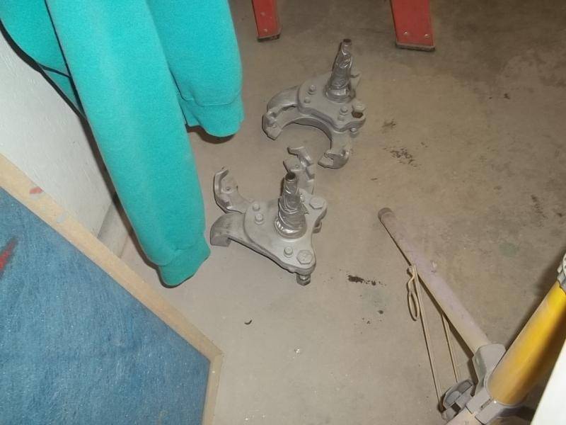

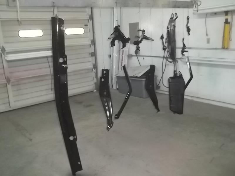

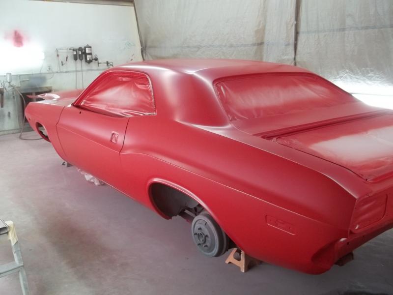

motor is in the machine shop now so things are going well. heres some pics.
a68postcar
Feb 5, 2011
334
8
Thanks again Robert. Just a quick update on the progress. Things are moving along nicely. I hope it keeps up!!!!!
