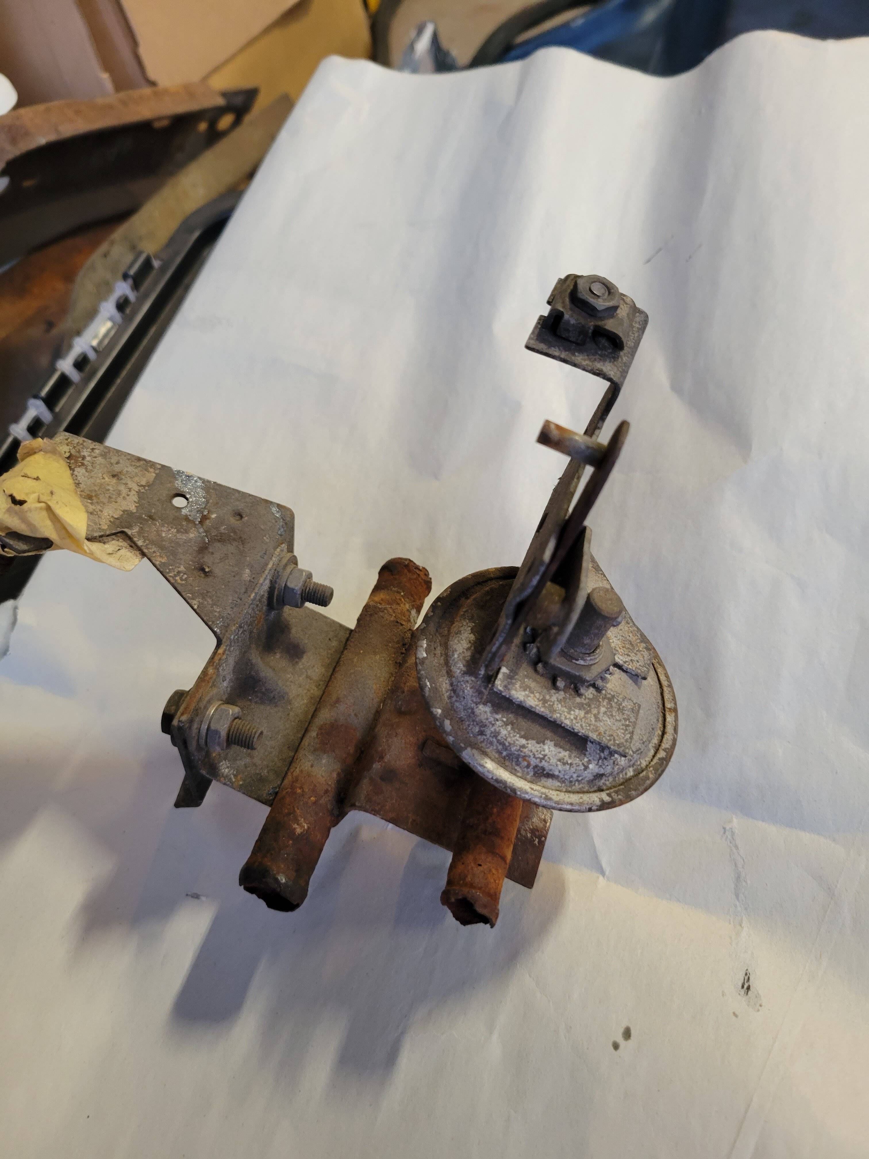

Well, after almost 50 years, this is toast. Anyone know where I can obtain one for my 73? This does not need to be OEM, just something that works.

Okay, cool, I see it. Should I assume that the picture of their part is not exactly what it looks like? Because the thing that the cable hooks to for operation is not shown and it looks to be integral with the assembly.More Information for FOUR SEASONS 74643

Well I would not assume anything but I will tell you that you most likely are not going to find an exact replacement as the NOS stuff is pretty much gone. All of those valves do the same thing and were used by all of the manufacturers so the aftermarket takes a generic one and changes the mount a little. In other words it might take some tinkering to fit and work but it will do the job.Okay, cool, I see it. Should I assume that the picture of their part is not exactly what it looks like? Because the thing that the cable hooks to for operation is not shown and it looks to be integral with the assembly.
