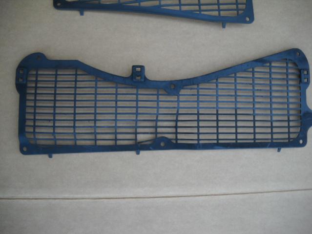

Some pics. 72 up cowl screens.jpg70 -71 cowl screen.jpg72 up cowl screen LRG..jpg

Chal6Pak, thanks for those photos, Clearly the 70 ones are different. I will have to look at both of mine but I think they are identical, so the 71 must be snap in. Interesting how they make these myriad of small changes between models. All designed to speed up the assembly process I suppose and reduce costs.

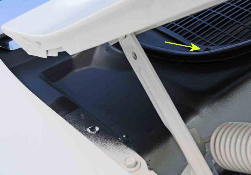

here is a picture I found, (1970 RT) close up of the painted RT plenum cowl area. Looks like it is a low satin/matt black. Also visible is one of the retaining screws for the plenum cover.
If you think, like me, that the cowl black paint job looks messy and untidy, well apparently this is how many of them left the factory. And as this particular car is the highest scoring and most awarded original restored RT Challenger, then I suppose it is 100% correct

Yes 70 are the screws but i have also had very early built 71's with screws with some having a few of both as i mentioned they used what ever was available during the mass production. I don't ever recall any original 70 R/T or T/A cars looking quite that messy on the cowl plenum which is BTW a factory Chrysler term and i have had a bunch of unrestored cars through the years. Of course that could have been a Monday or Friday built car they followed after as goes with runs in some painted areas under the hood etc you have to put them back on during restoration to make it correct.
