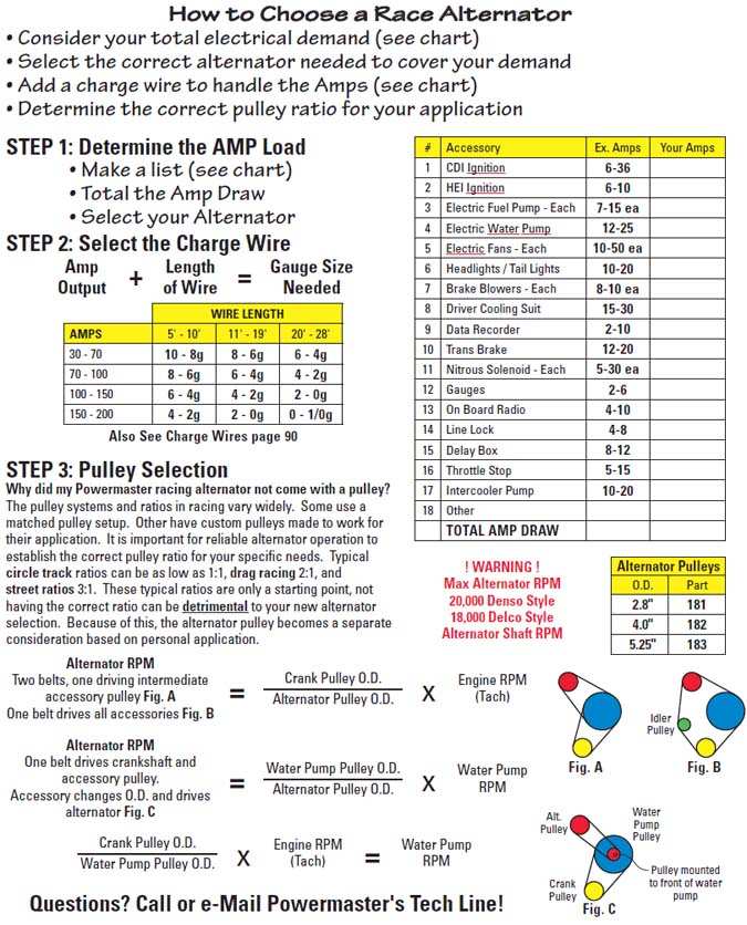

You should consider a 100-Amp alternator. Powermaster makes factory-appearing alternators that should work.
Mopar Connection Magazine did an article on upgrading the alternator.
Note that the factory wiring is not rated for 100-Amps. The below is a Powermaster chart that lists accessories and their typical amp-draw. You can see how adding a hi-output ignition, EFI ECM, and an electric fuel pump puts considerable more load on the electrical system.

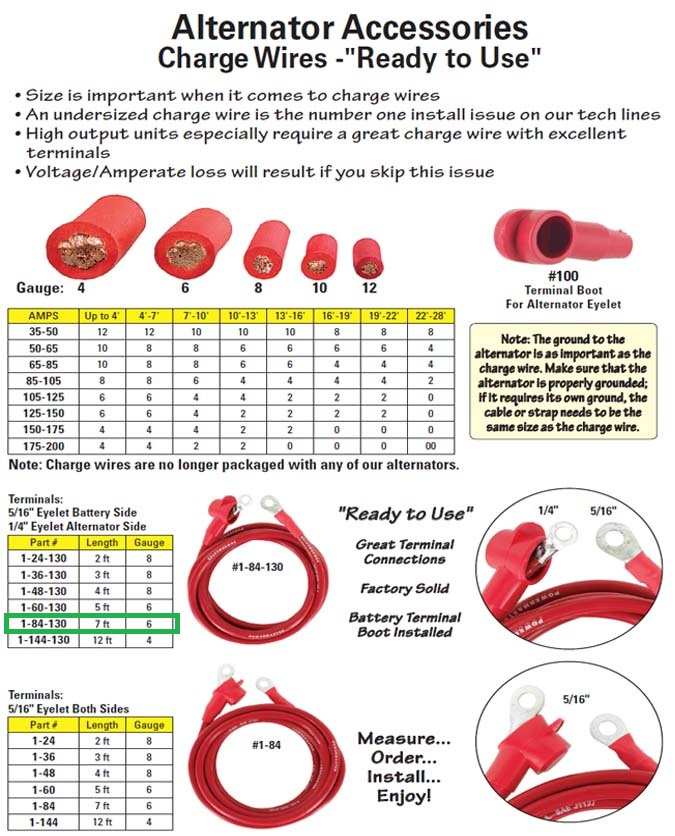

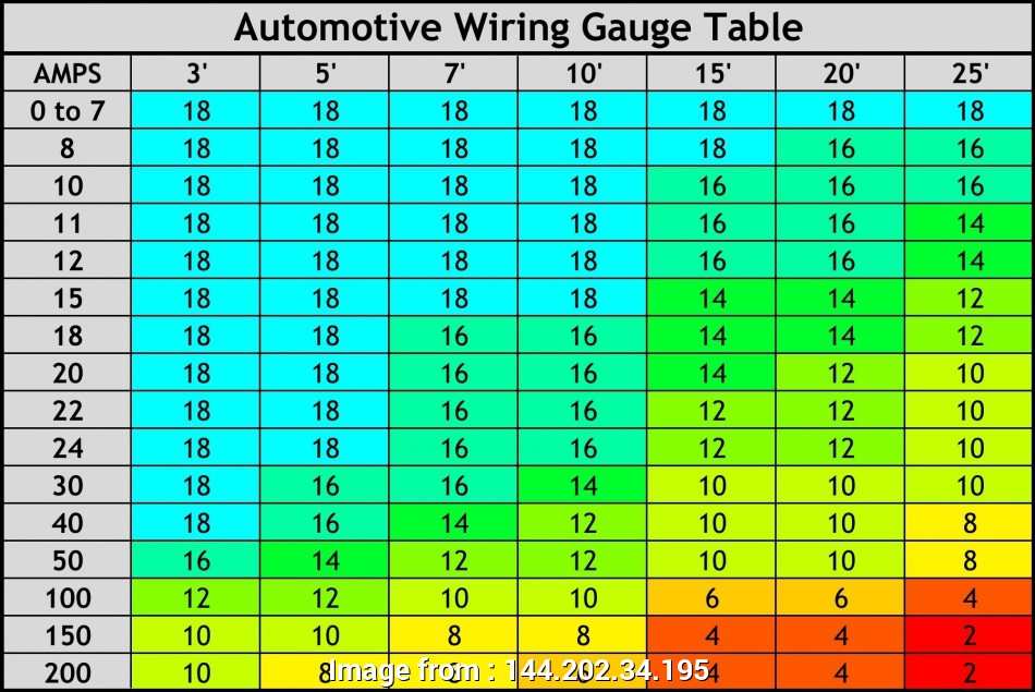

You will need to also consider upgrading your main power feed wire from the alternator to the starter relay post. This requires a decision on upgrading the path through the factory ammeter, foregoing the ammeter, or bypassing it altogether. The bypass is a popular option.

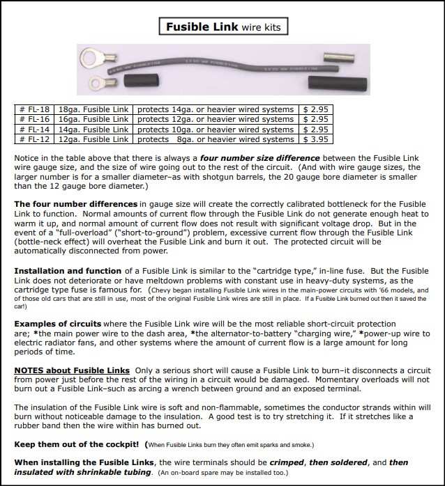

A wired bypass in the engine bay (no path through the firewall bulkhead connector) will need a properly-sized fusible link matched to the gauge of wire you select.
Typically, a 6-American Wire Gauge (AWG) primary feed bypass wire and a 10-AWG fusible link will do the job.

Thank you that’s a lot of fantastic info. My car is mostly original so I don’t wanna hack it all up i love the original look and functionality of the gauges which were restored and working great with that being said the demand chart put me with the 60 amp alternator. 45 amps is what i have based on chart. Electric fuel pump 7-15, headlights 10-20, data recorder for efi 2-10. That outs me at 45
