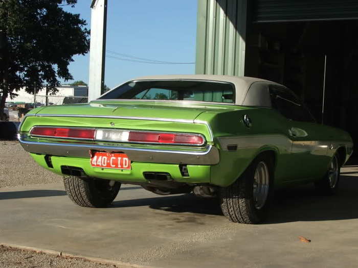

OK, I was looking for wheel offsets for aftermarket wheels for a 1970 Challenger with stock spring locations; Found it.... You can put up to 5 3/4 backspace on the rear 9" wide wheel, & 4.5 backspace on the front 8" wide wheel.
