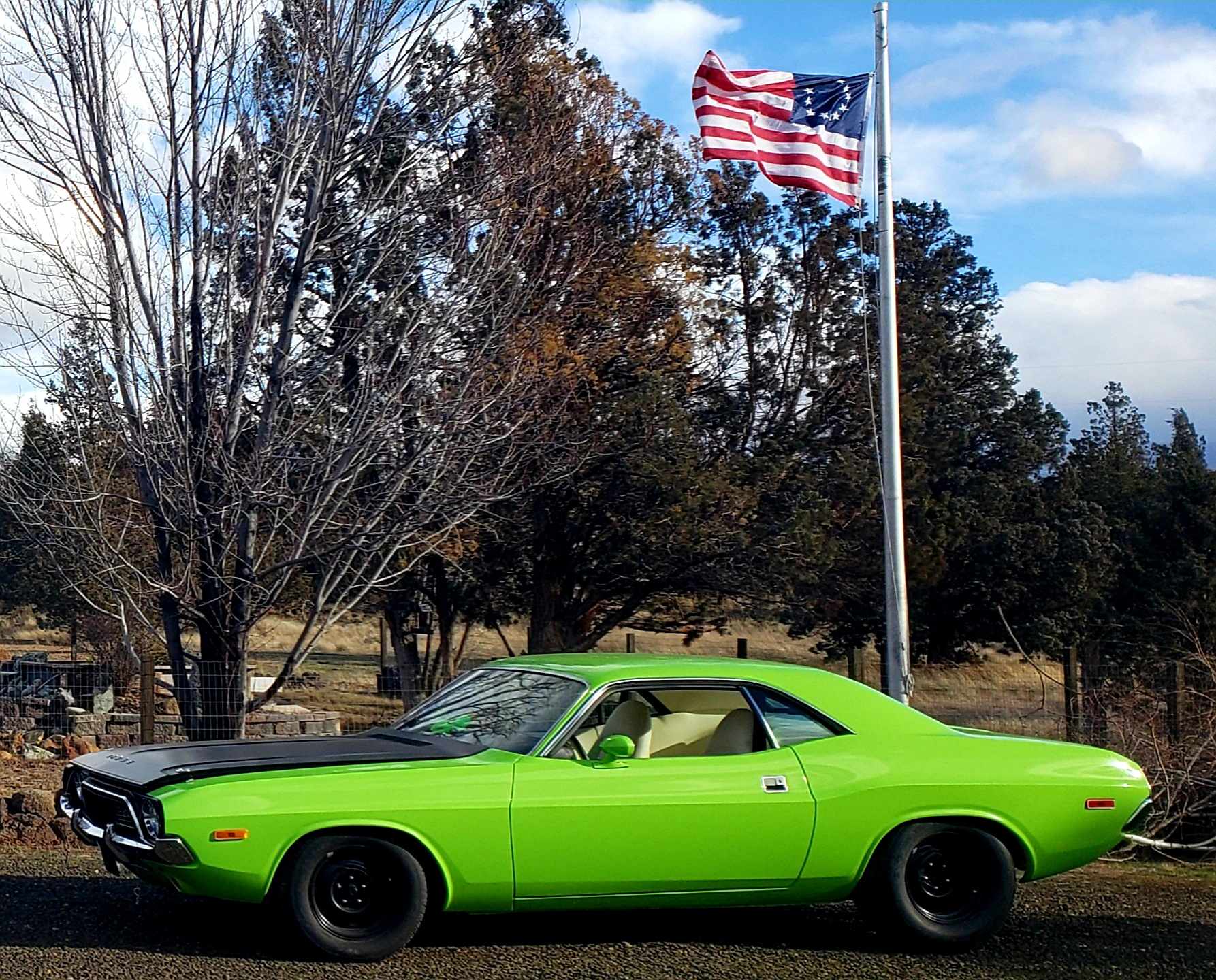

I like how you mounted the flag pole on the rear 1/4. Very reminiscent of a T/A.
The whole goal when I bought this 20 something years ago was to make a big block T/A style car, so it's perfect!
