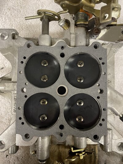

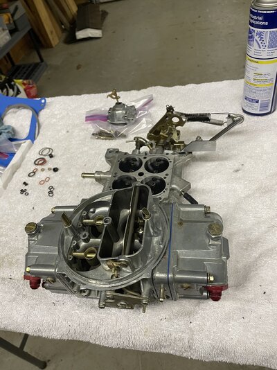

So far so good, it’s actually pretty easy to rebuild. I used the kit mentioned above and there are a couple issues with it.
- it didn’t come with the vac sec diaphragm (not sure if it was supposed to)
- the throttle plate gasket is off a a little (not sure it makes a difference)
Should the gasket match the plate holes/openings perfectly? My gasket is off a little, but the holes are still open.
It’s not off by much….but it’s off. Whatcha ya all think?
-Kevin
Throttle plate gasket looks good, I've never had a problem with them being off a little like that. Some of the lower priced rebuild kits don't come with a vacuum secondary diaphragm, that is always something you want to look out for when you buy a kit for these carbs.

The kit came blue gaskets for the bowls etc… I coated the blue gaskets with a little wd40 when I assembled; meh, see what happens.
I didn’t take any measurements with vac gauge or RPM before hand. The old power valve was 6.5. (Replaced with 6.5), w/brake boost, vac sec carb, vac advance distro.
It should run/idle I hope 😁…the idle mixture was set at 3/4 turn initially, but I set it to one turn on both sides for initial setup.
Float level is a question mark at this point; I set them lowish for now, just to make sure the car idles/runs...and then figure that out next.
