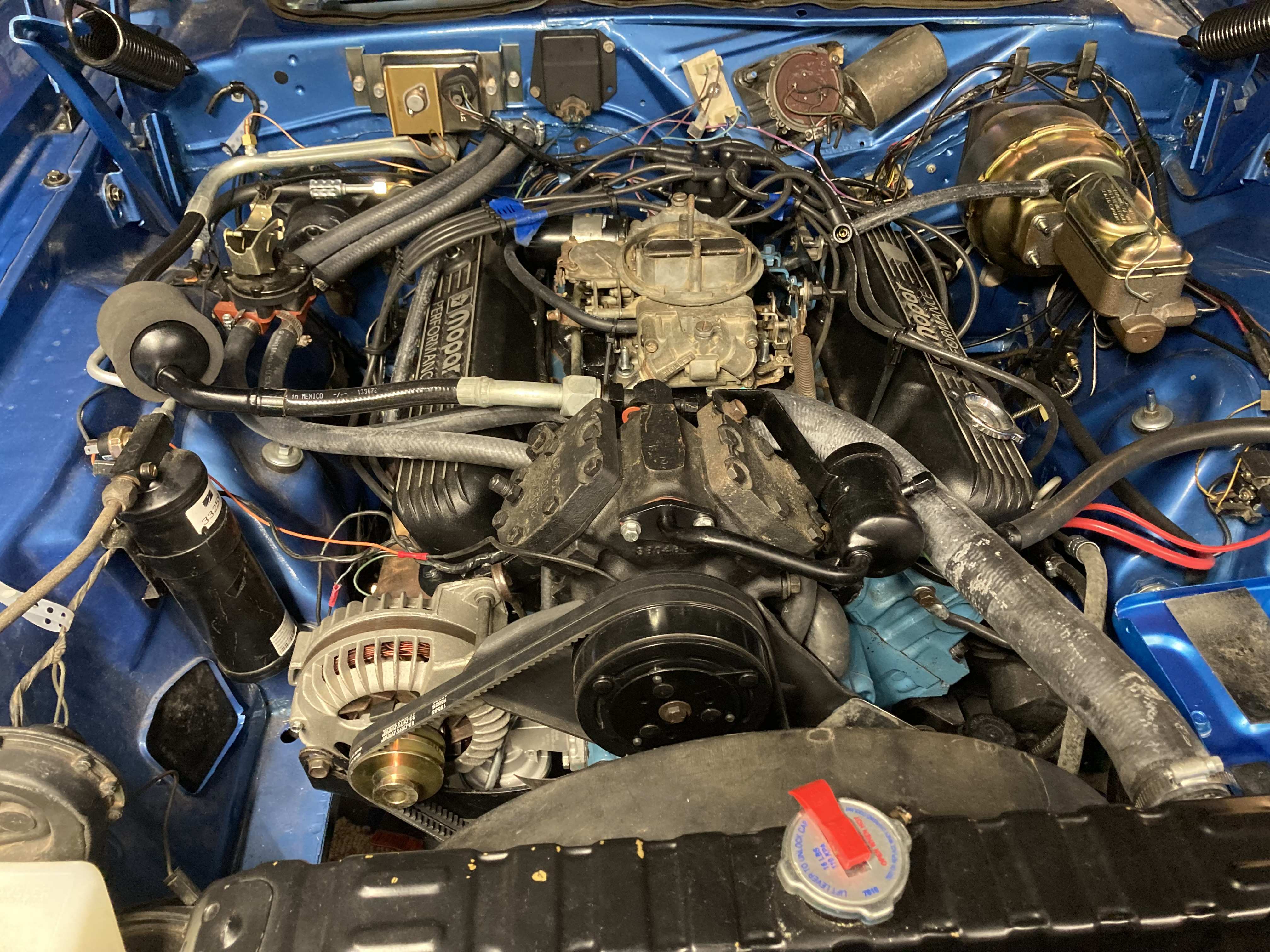

on 3rd ballast resistor. new one installed when hooking up wiring harness. no good. was very hot. tested no good at store. #2, first start on the rebuild. timed and adjusted carb. spent part of day starting engine.Been I shop for about 10 days everything was fine. Ralley gauges worked. tried starting motor today, ran for a while and quit. had the same symptoms as first resistor , fire, no run, very hot to touch. now, no start. can a non ballast resistor coil be used---?? first start problems. Year old battery failed, no good--fuel pump, not pumping--ballast resistor no good. had good first start day--all parts replaced by store..anybody else purchase bad parts?? Michael '71 challenger

Picture of what you are working on.

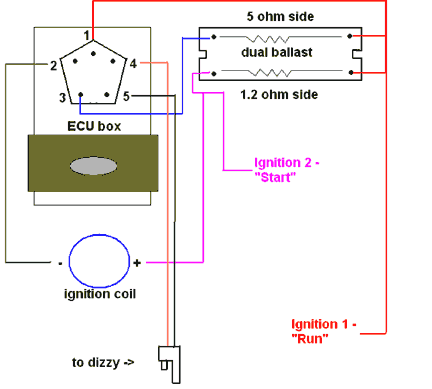

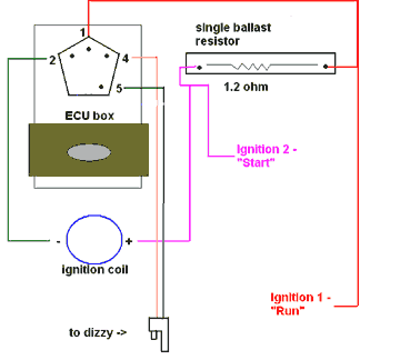

MOst only require a 2 pin resister as the second side is not used anyway with most ECU boxes , Chinese stuff is all junk

1. electronic ignition. upgrade from 71 Mallory duel point. all wires match correct color on wiring diagram. stock mechanical fuel pump--plenty of gas.
2. will not start now..ran once for about a minute, them shut down. crank and did fire, but no run. 10 timed and tuned. spent most of day starting and let motor run.
3 brand new rebuilt 318 bored .30 over. 360 heads, milled .30, large valves--used before rebuild. edelbrock intake, Holley 750 carb
