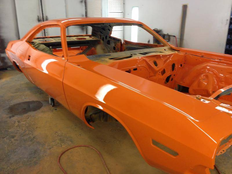

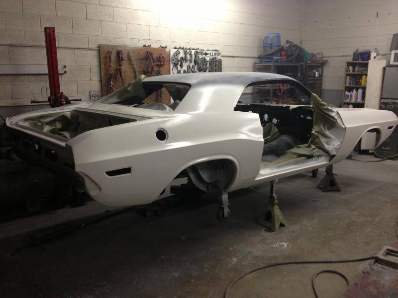

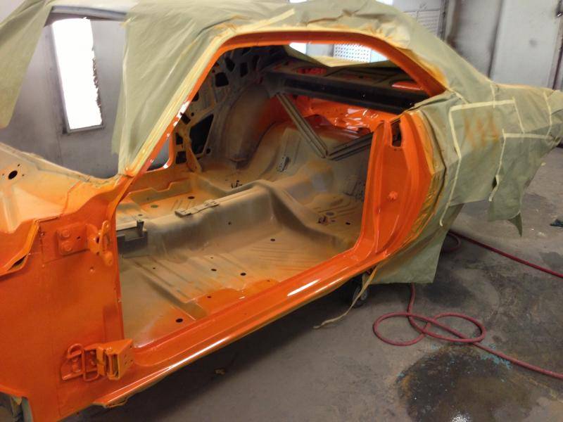

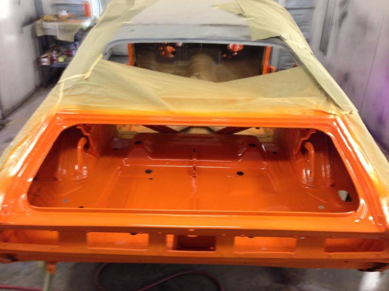

Got the car in the paint booth. I'm trying my best to recreate all the factory overspray. And I got all the underneath under coated. image.jpgimage.jpgimage.jpgimage.jpg

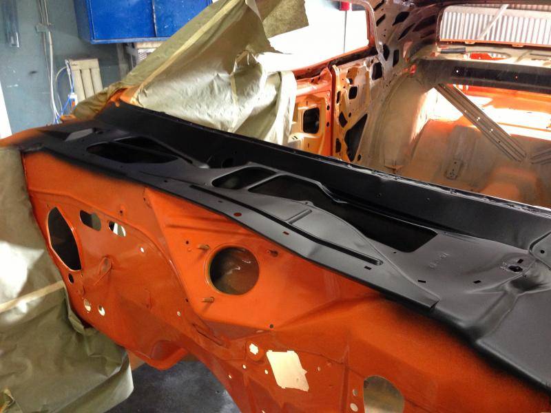

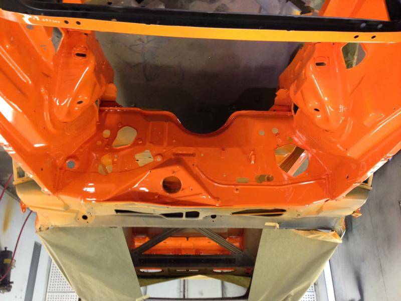

I tried to recreate the overspray from the cowl to the firewall the way it came out of the factory

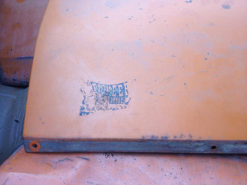

Has anyone ever seen this pioneer dodge sticker on a deck Los before?image.jpg

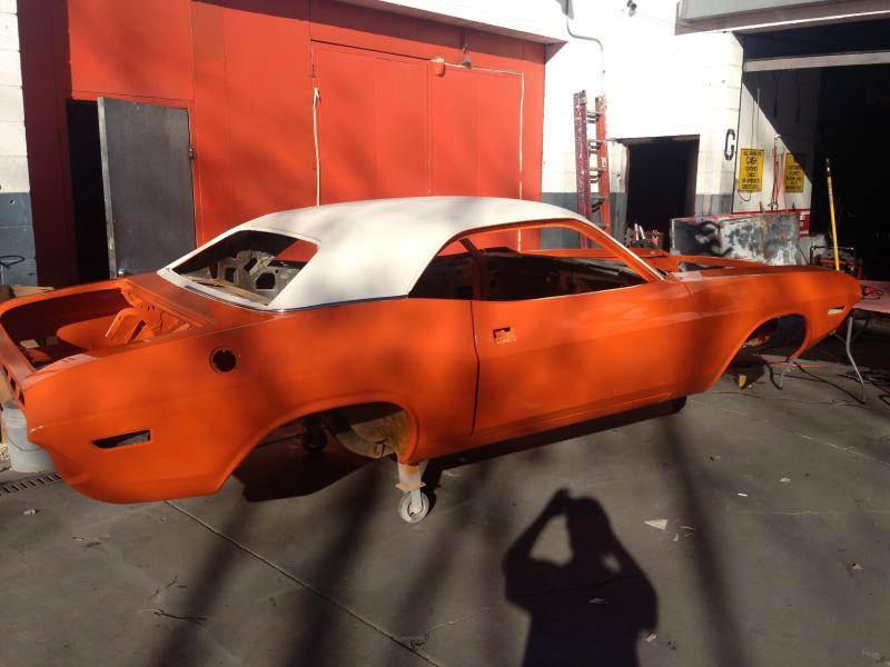

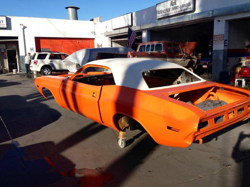

Got the vinyl top on. I'm finding it a bit of a challenge to put the trim clips is cause I put a new Dutchmen and there are no holes

moparmofo Got the vinyl top on. I'm finding it a bit of a challenge to put the trim clips is cause I put a new Dutchmen and there are no holes[/QUOTE said:
Lookin very nice! You will need to drill holes and put in stainless steel screws for those trim clips and do the same for the rear glass trim clips.

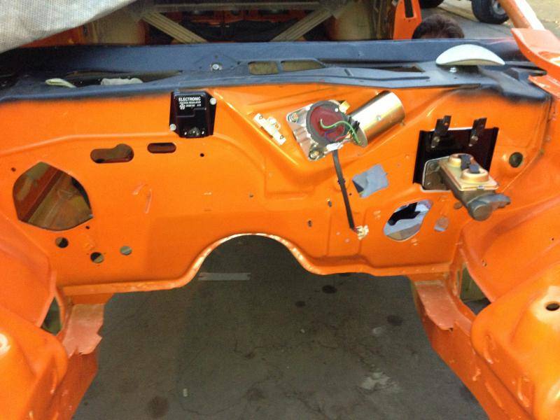

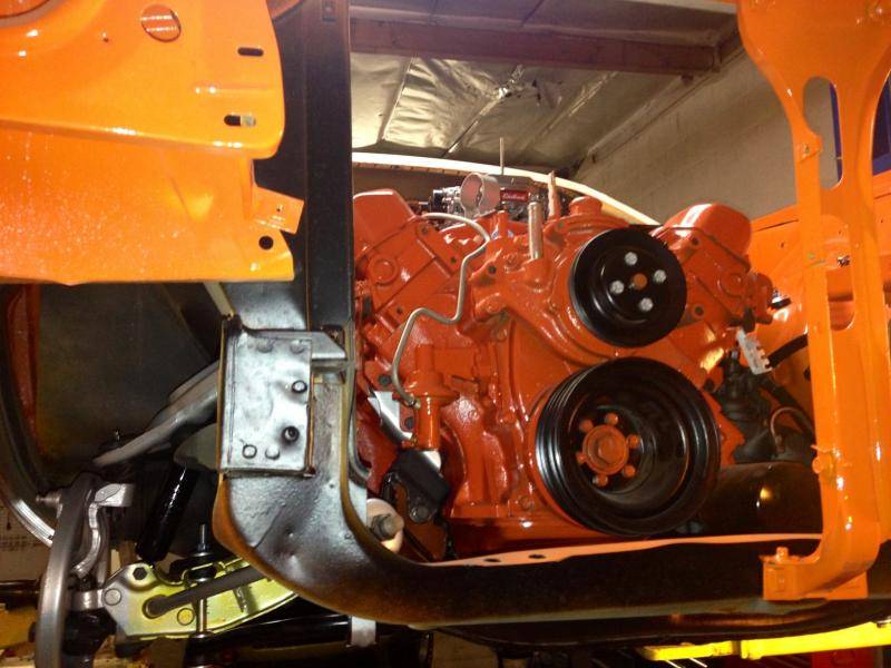

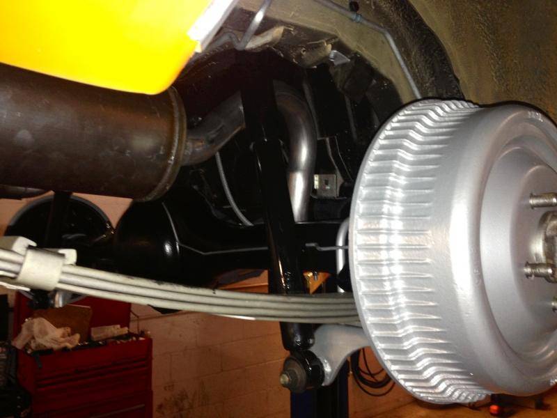

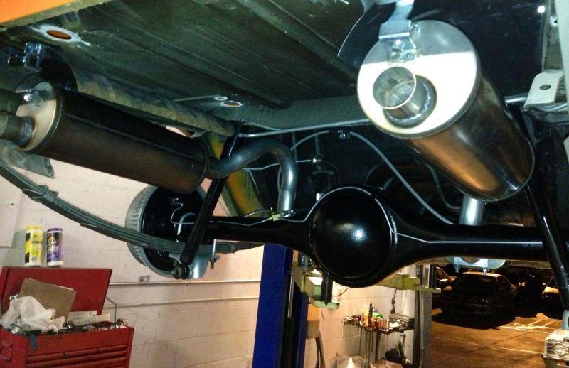

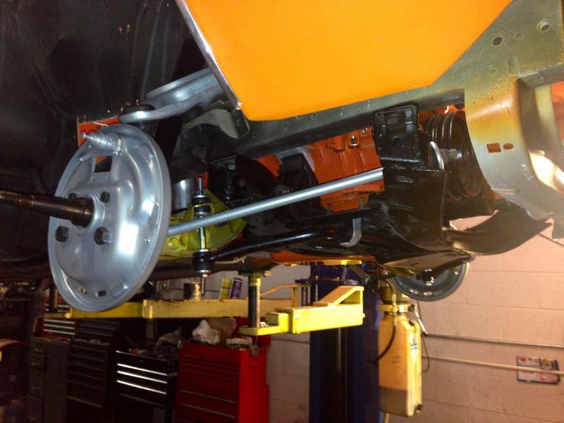

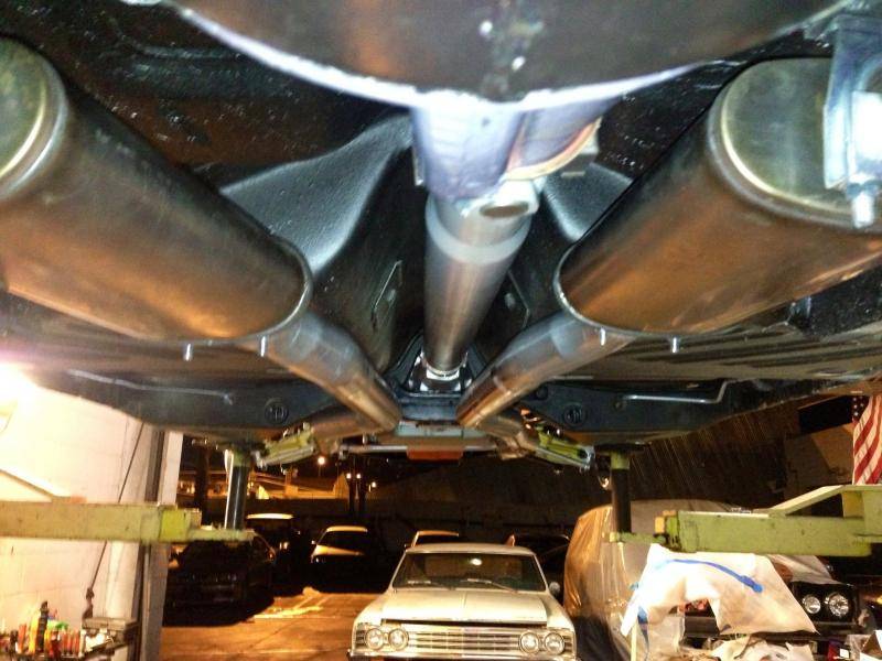

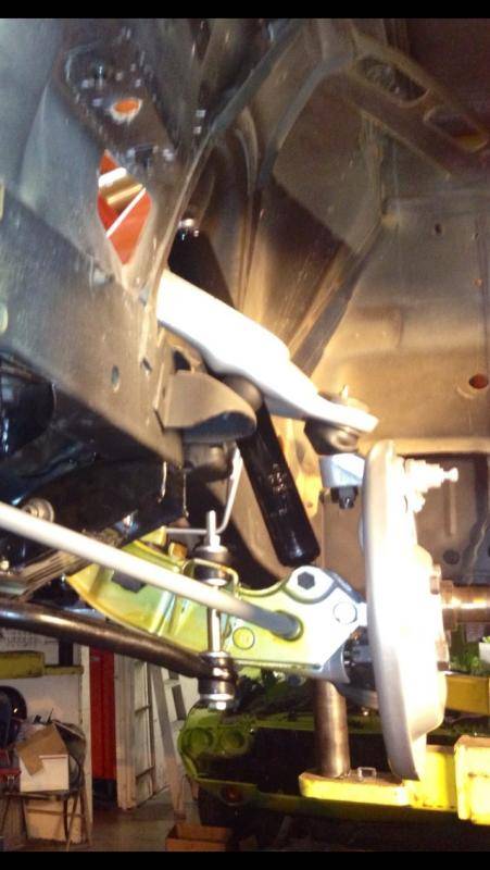

I got all the rear suspension, front suspension, brake lines , fuel lines and exhaust put together. Exhaust is for accurate. Rearend is the original 3.23 that I had rebuild and powder coated. Hopefully the car will be a roller this week. [iurl="http://www.forebodiesonly.com/forum/attachment.php?attachmentid=11246&d=1394031975"]
[/iurl]

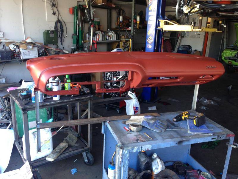

I built a stand for the dash to assemble it

moparlee
Jul 25, 2011
3,317
1,478
Mid Michigan
You are moving right along and doing a very nice job. I see you even have the usually missing muffler shields on it. BTW, is that a citron yella challenger sitting in the background on that last pic?
moparmofo
Apr 18, 2012
41
2
Thank you. Behind it is a 71 sublime green challenger 383. It was a 383 2 barrel. Made it a 4 barrel put hp manifolds on it camed it up a bit. I bought it a couple of years ago building it to sell it. But the gomango is the one I'm keeping
a68postcar
Feb 5, 2011
334
8
@moparlee thank you for the advice. I hope to have the engine in tomorrow I will post some pics as soon as I get that done.
Started putting some stuff on the firewall View attachment 11181
I have a quick question. is this blackout treatment stock on all of these or is it an R/T thing, and did it carry over to the rally cars?
