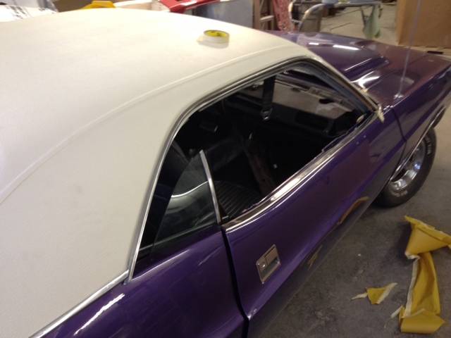

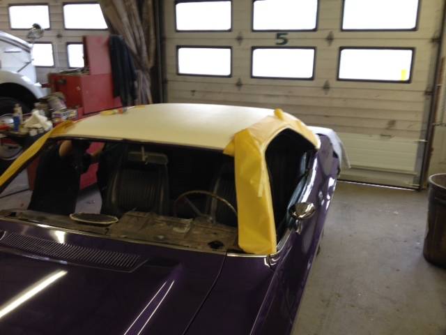

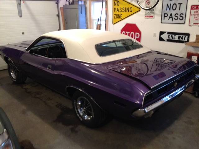

Vinyl top installed.......
...the list is shrinking ever so slightly :icon_super:
tomps
Oct 28, 2012
104
1
Maine

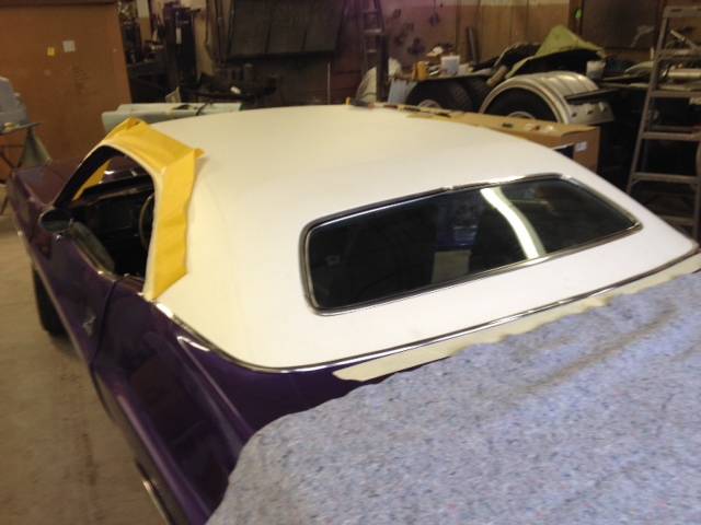

The only credit I can take is picking and paying the upholstery shop :toothy12:
Very happy....the top was a Legendary Interiors piece. Fit and form look pretty good.
The color combo (original) will really pop I think once the white R/T stripe goes on which should be soon......final buffing of the paint next week I think.

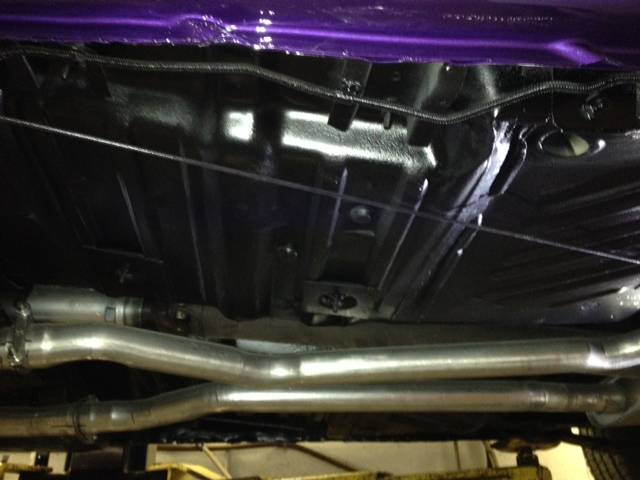

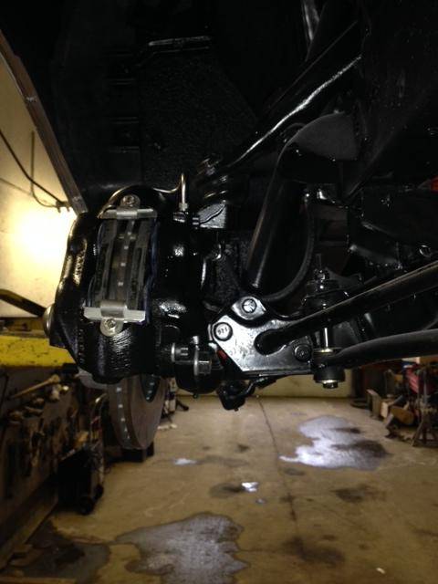

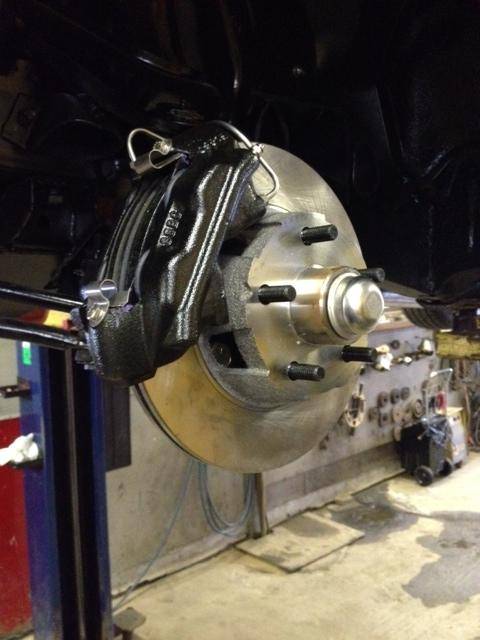

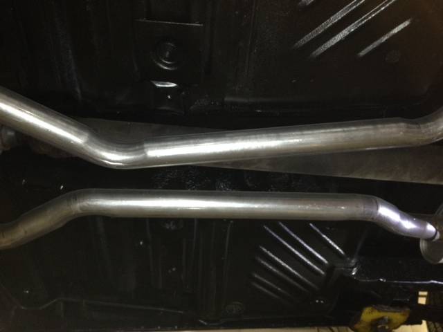

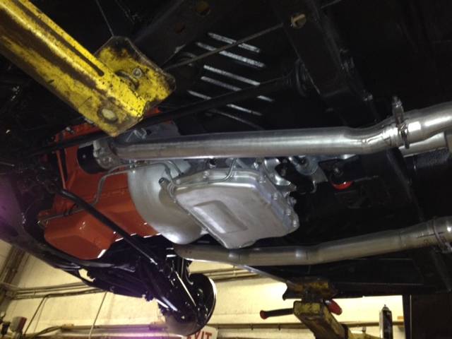

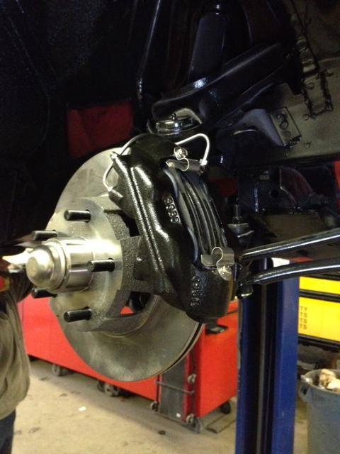

Exhaust on, suspension done, disc brake conversion from SSBC bolted up nicely to existing spindles.
Closer everyday.....

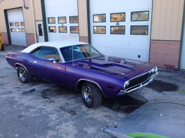

Well we're out of the body shop and back to my garage for final assembly :toothy12:
Hopefully by summer. Got a complete new interior to do...full engine compartment to dress.....lots of trim...R/T stripe. Just need some warmer weather....

Looks pretty awesome. I have the same color combo on my 70 U code R/T. Previous owner deleted the white top, but I'm thinking of putting one back on.
A few comments to your questions:
Whatever was "gooped" around your rear window plug was not factory. Those were screwed into place with no additional sealing. Some jute or ?? padding was put around the lower areas prior to top install and the only thing that sealed the whole mess was the vinyl itself.
The black you found near your windshield was probably factory. R/T's and T/A's got the top of the cowl blacked out, but I don't think that started until a couple months into production, so you might not find it on early cars.
How are your ceiling console and headliner? Rear finish panel? Belt moldings? I know these are the hard parts to find when you need them.

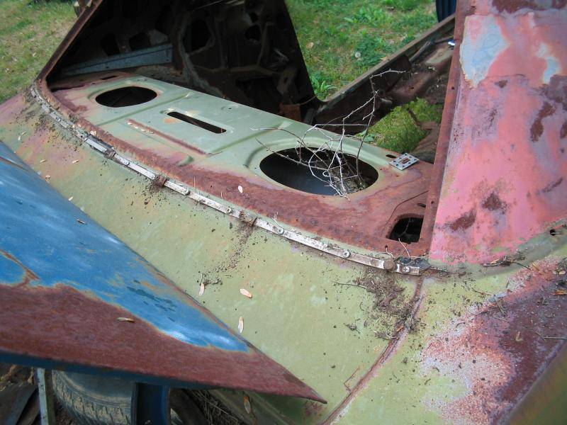

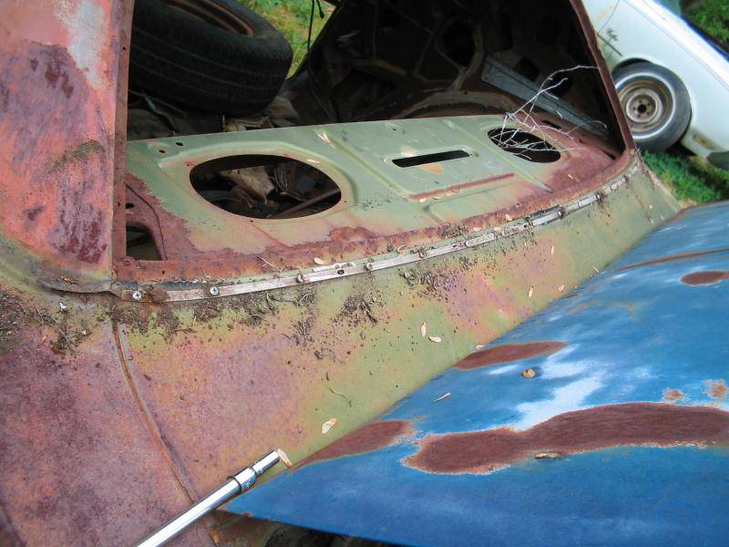

Did you have the original rear vinyl top moldings and the thin strip with all the holes in it? These are S.E. specific and are different from non S.E.'s.
challenger6pak
Feb 27, 2011
4,087
923
What is the thin strip with all the holes in it for? I have one off of an SE and do not know where it goes? Thanks.
quapman
878
227
Since the distance between the original large window opening is so close to the edge of the vinyl, it's supposed to hold the vinyl down to the deck panel. I probably have pics of an original, but they're so old, they're in a drawer somewhere, not in a computer. LOL
quapman
878
227
Found Some Pics!
Here are pics of an original S.E. I think the clips for the stainless moldings are wrong.
challenger6pak
Feb 27, 2011
4,087
923
OK. Now it makes sense. I took it off of a car so long ago I forgot where it went. I believe it is also why the SE has the wide rear moulding. It is to clear the strip. Thanks for the pics.
