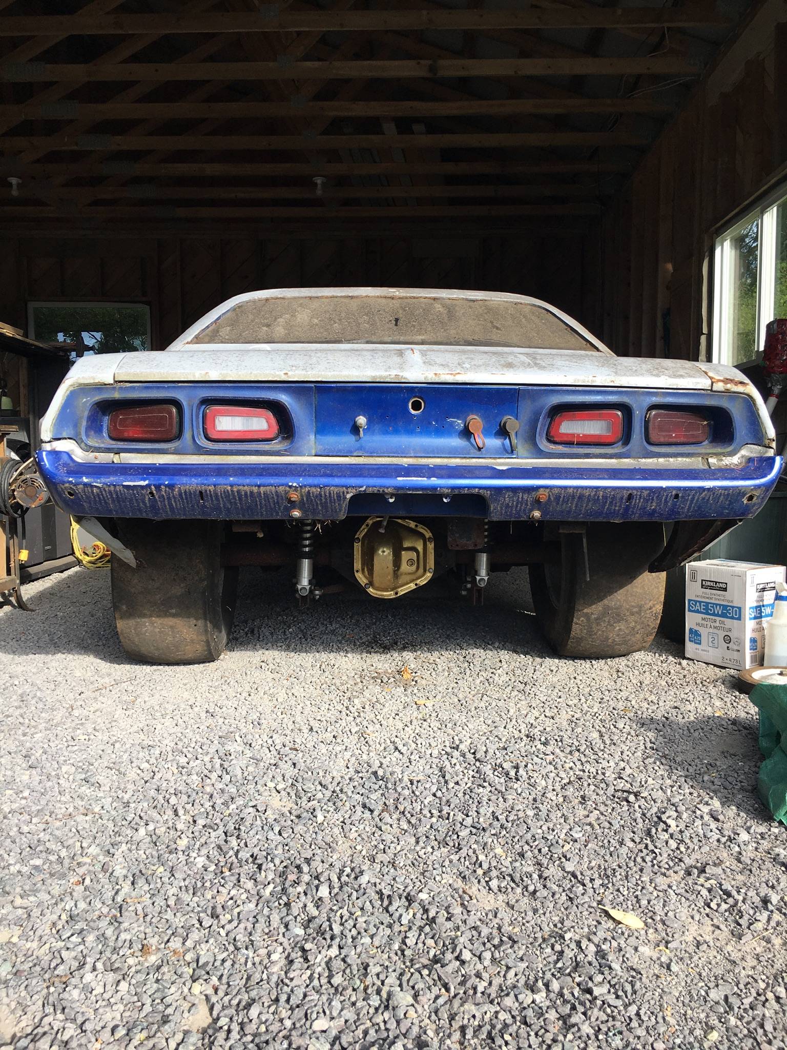

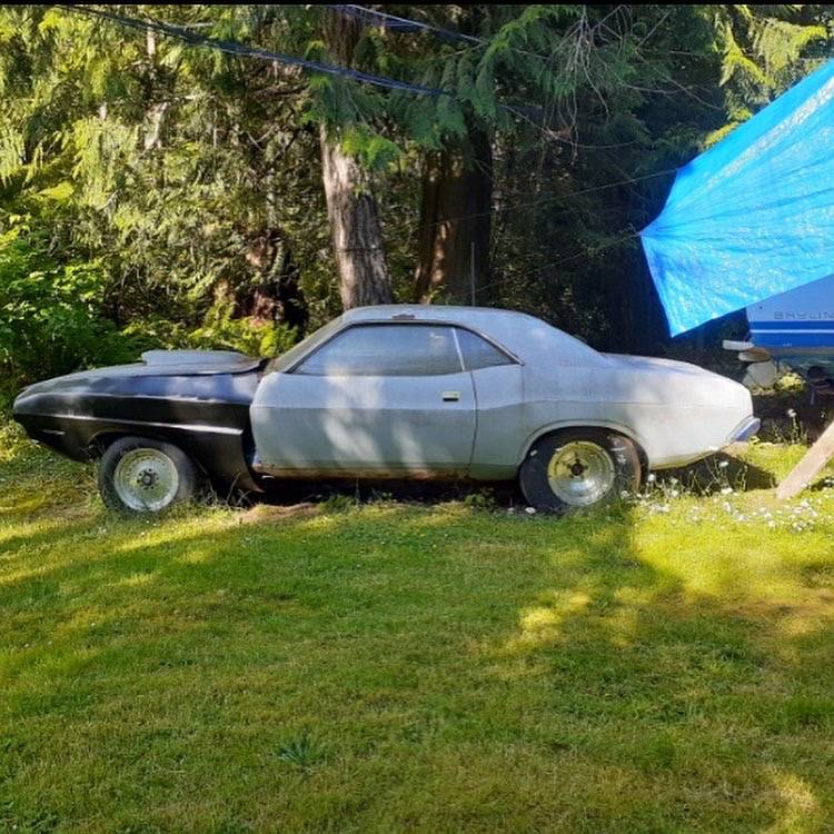

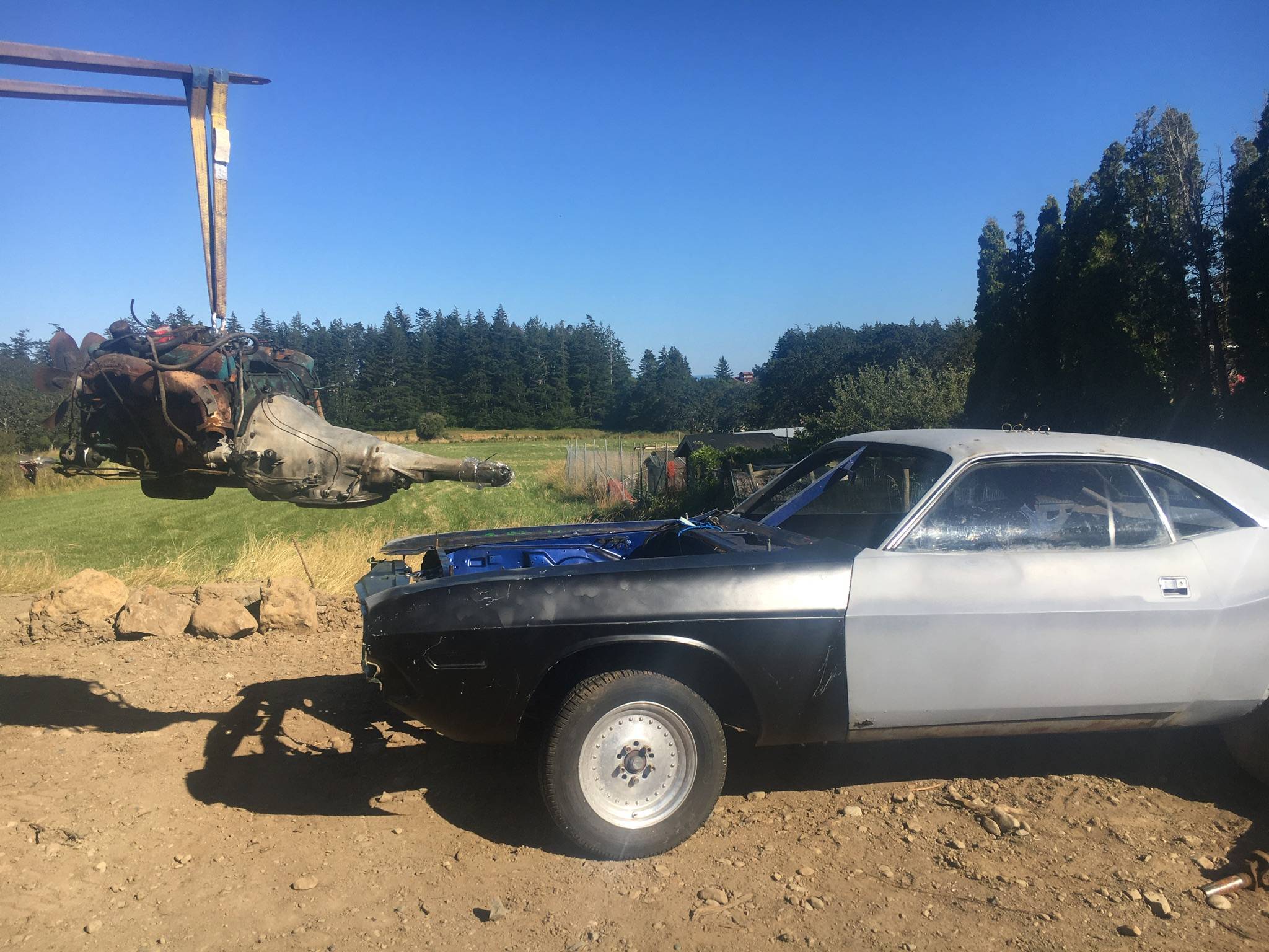

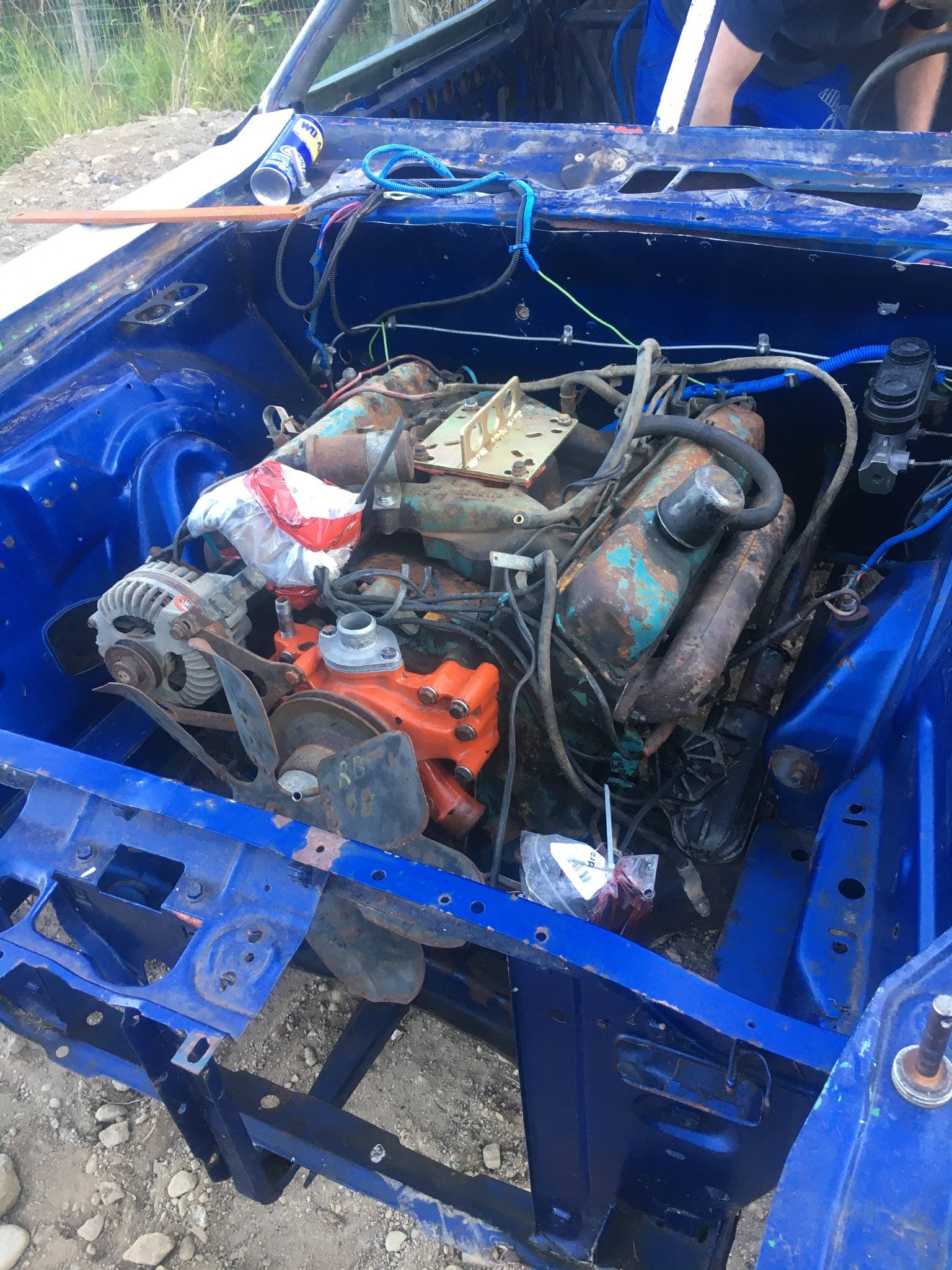

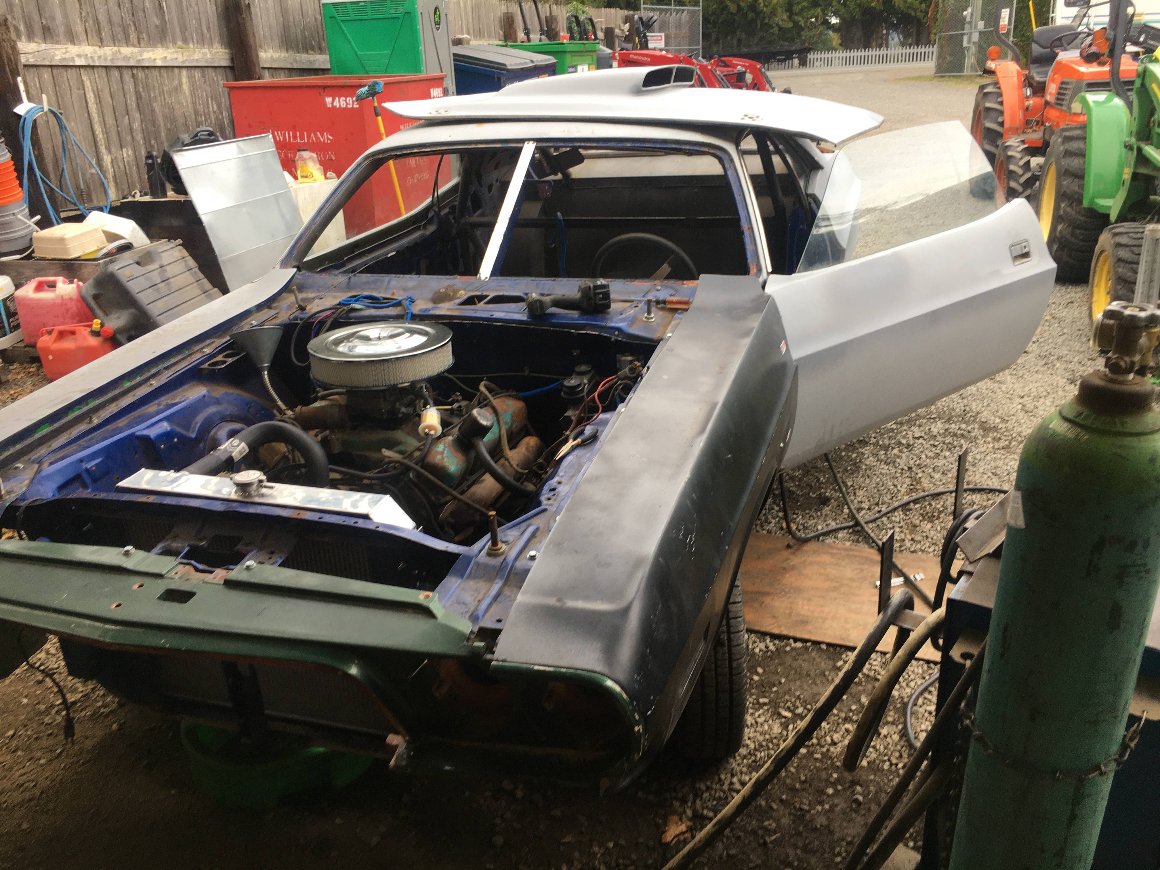

Yes it’s a race car, it has a narrowed Dana 60 with 456 gears a 4 link and a strange spool. 440 out of a 67 Chrysler 300 and a 727 from the same car. It turns out that when I set the gap between the reluctor and the little module thing I set it too tight because the vacuum advance plate moved and I shredded both the reluctor and the module. Fail. If anyone has any of those parts for sale close to British Columbia Canada, let me know.

Those are all the photos I have of the car.
