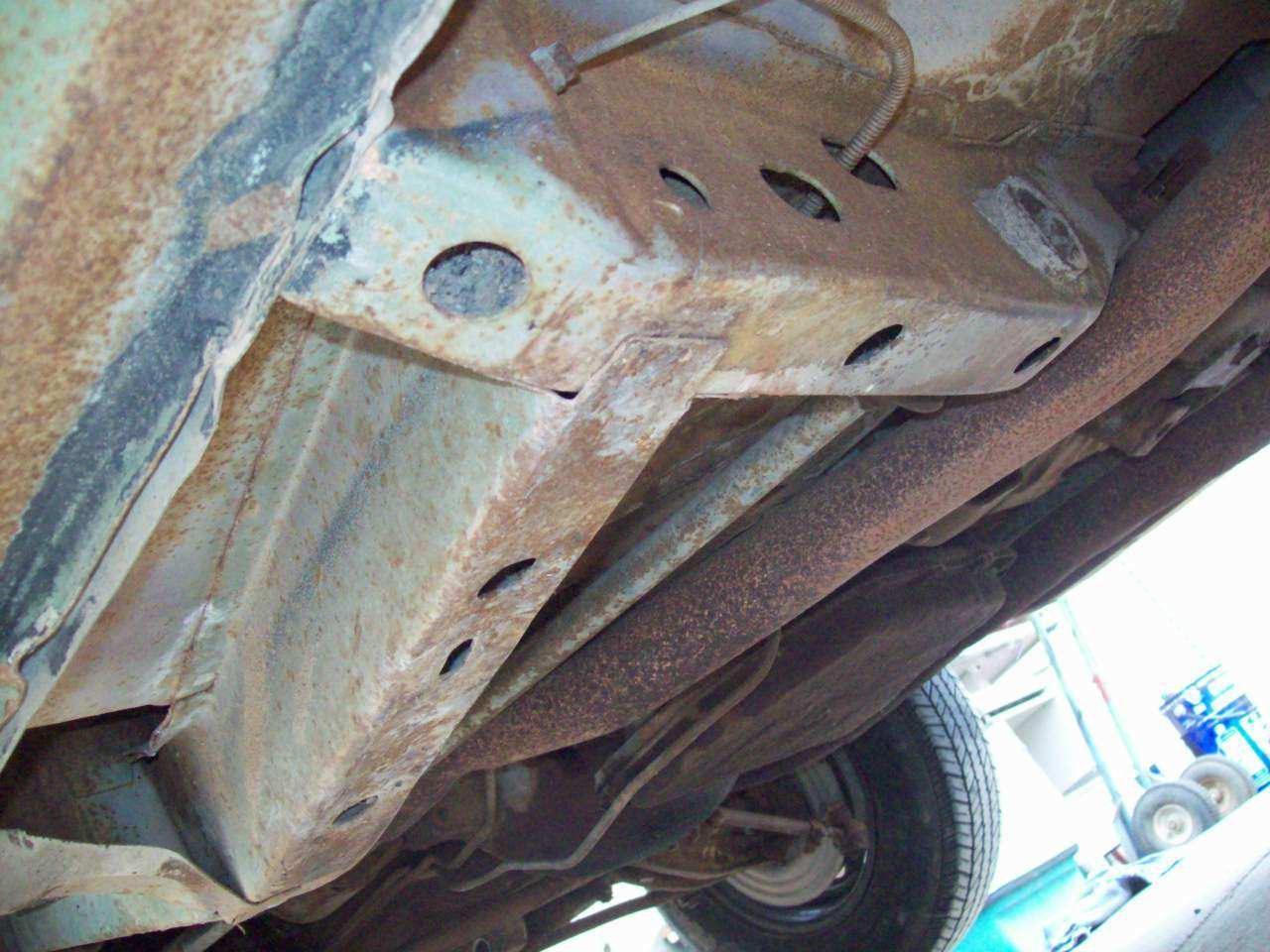

Challenger RTA
Oct 28, 2018
2,670
1,340
PA Flood city
Good info from Xcudeme. Here's an example of what not to do. I was just going to remove the factory undercoating and found bright shinny metal. SOOOO! I went a little above and beyond. This is how it should not look from the factory.

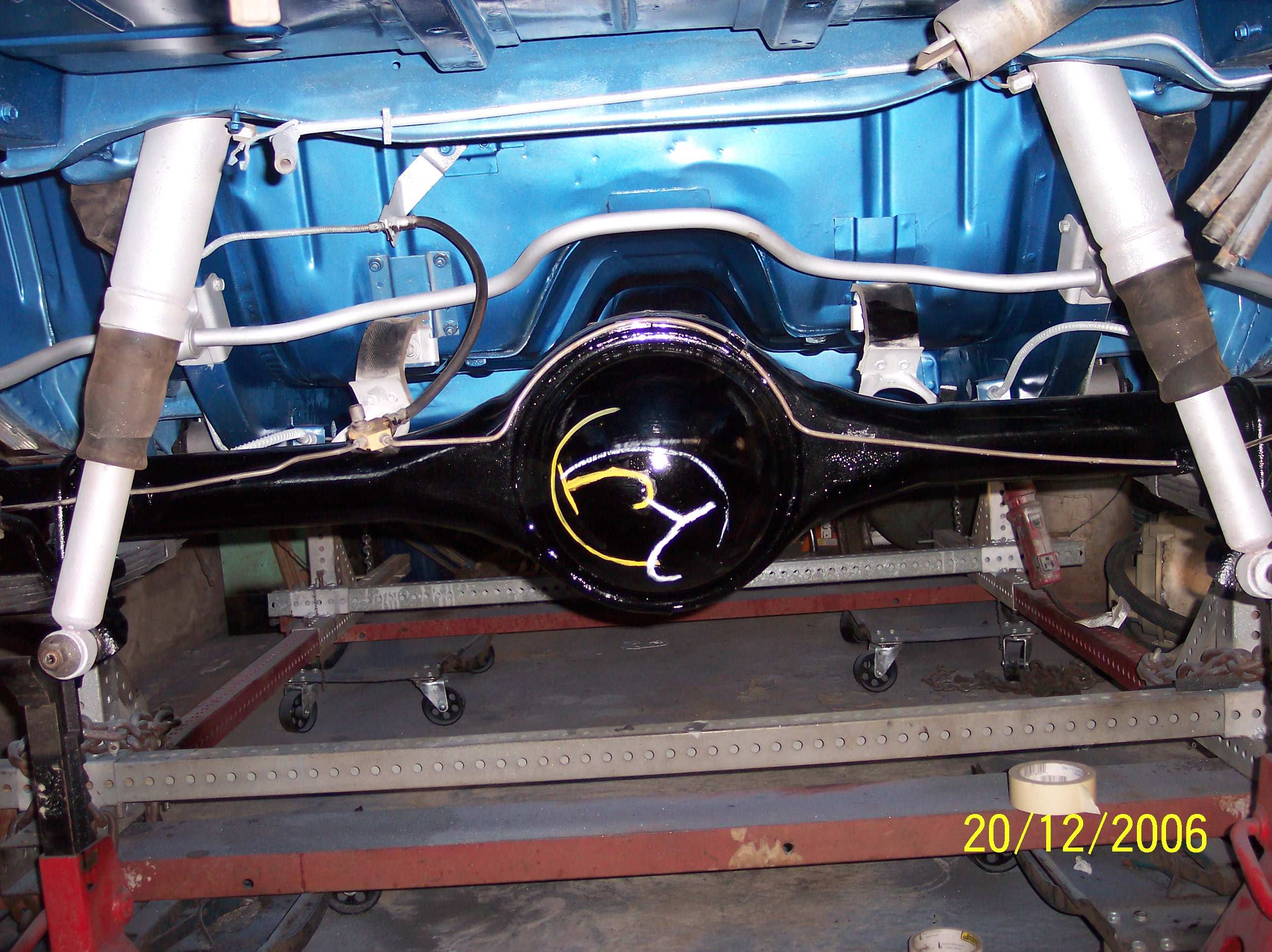

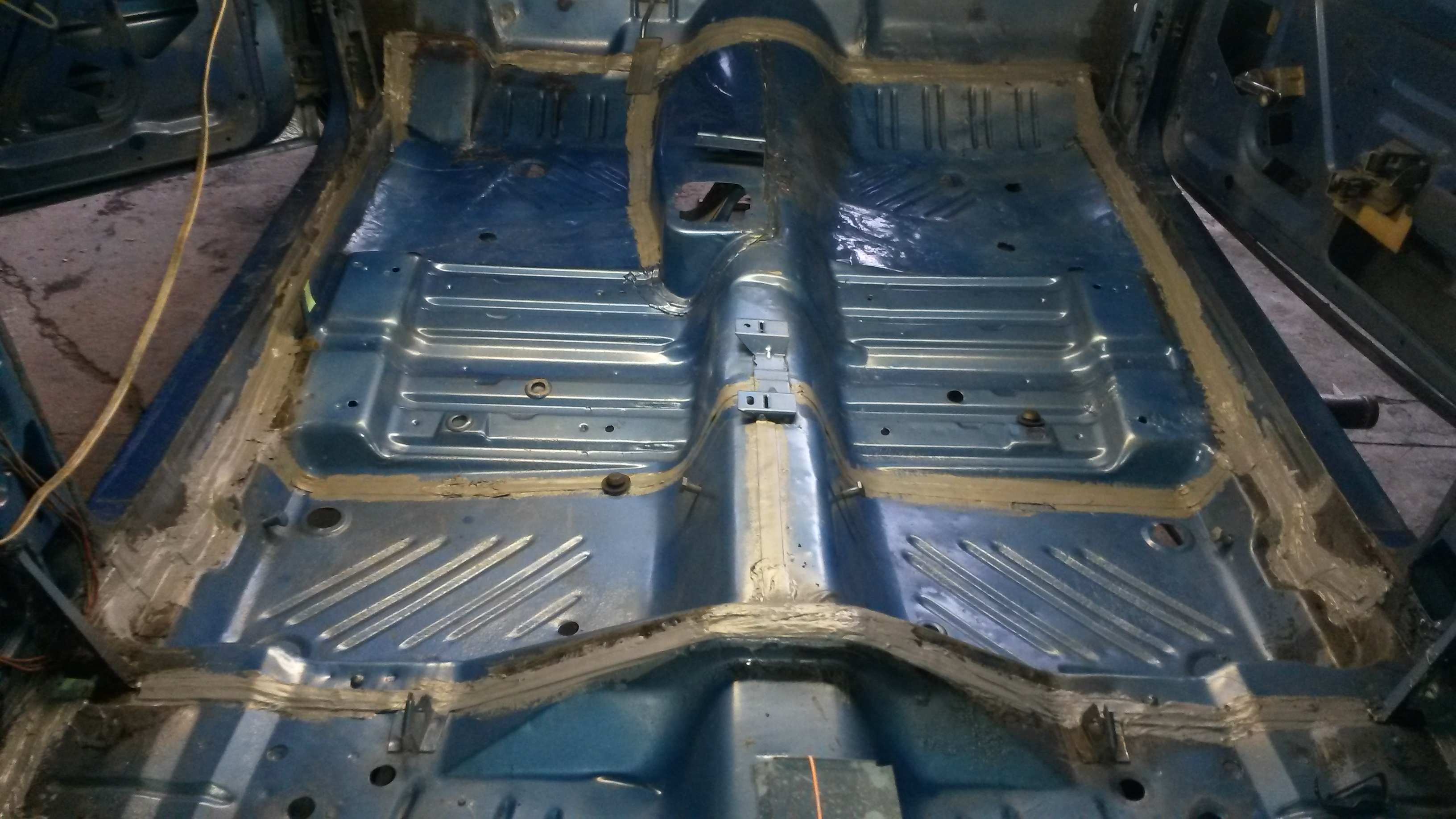

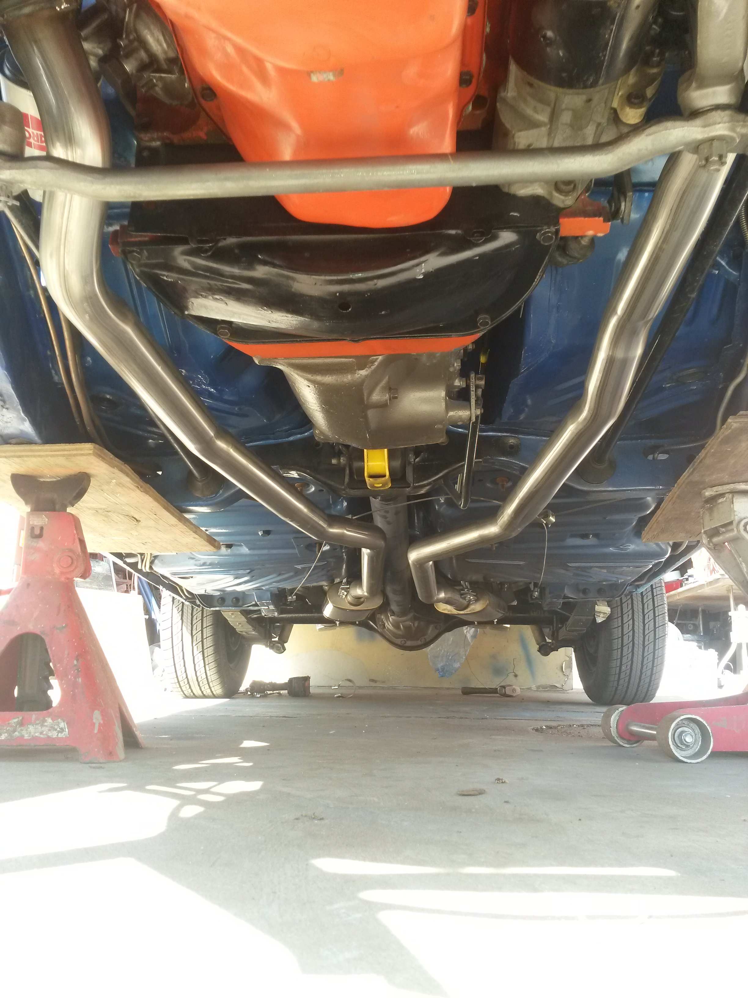

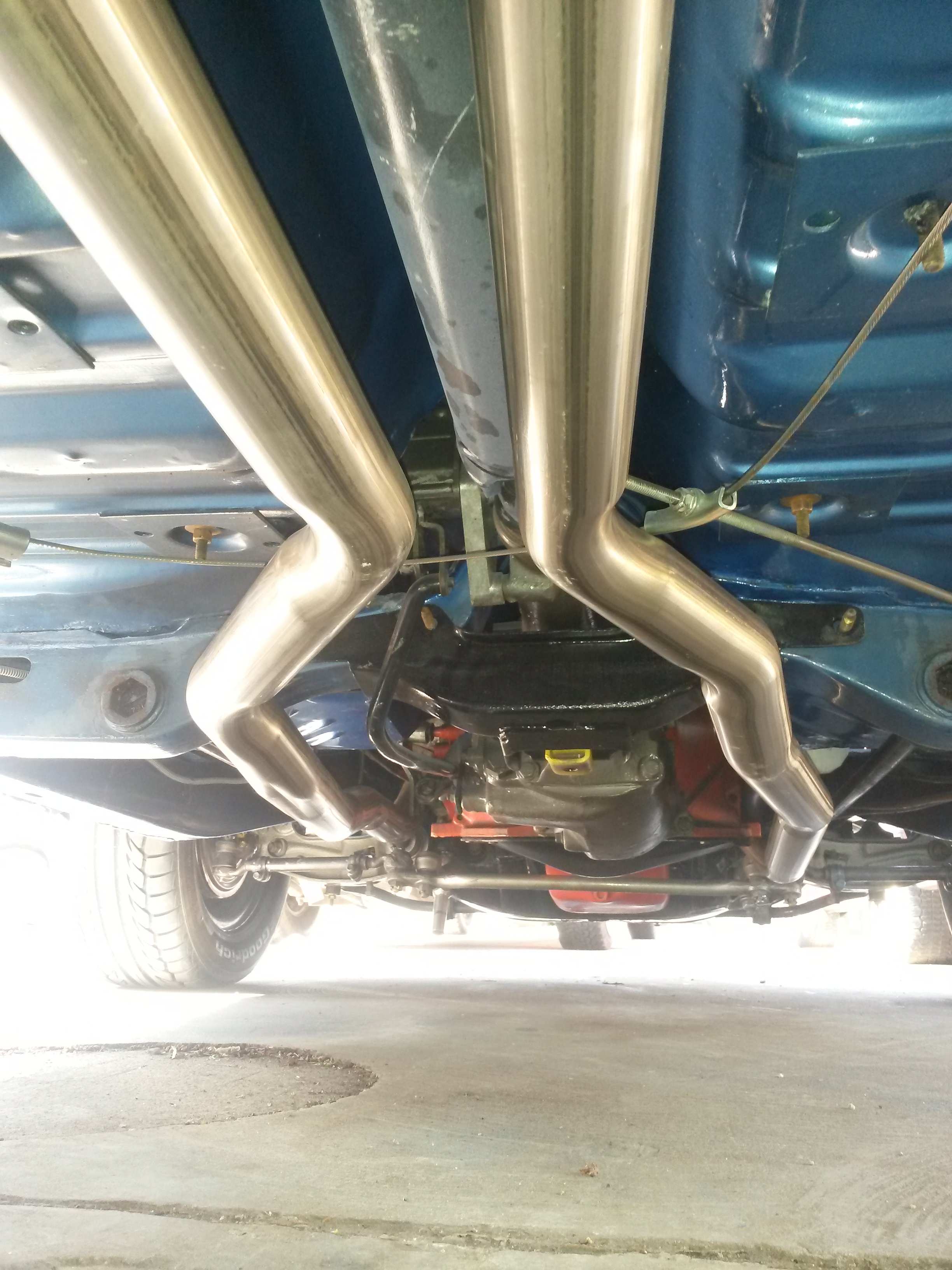

MoparMoMoney
Aug 19, 2023
27
13
Michigan
This is what it probably would look like. Just a little over spray underneath.
Ok. Now I understand. The underneath of mine is all new floors and transition pan. Just wasn’t sure until now. I guess more is better but wanted an original look. However Frame rails have been tied so doesn’t really matter then. You guys rock.
