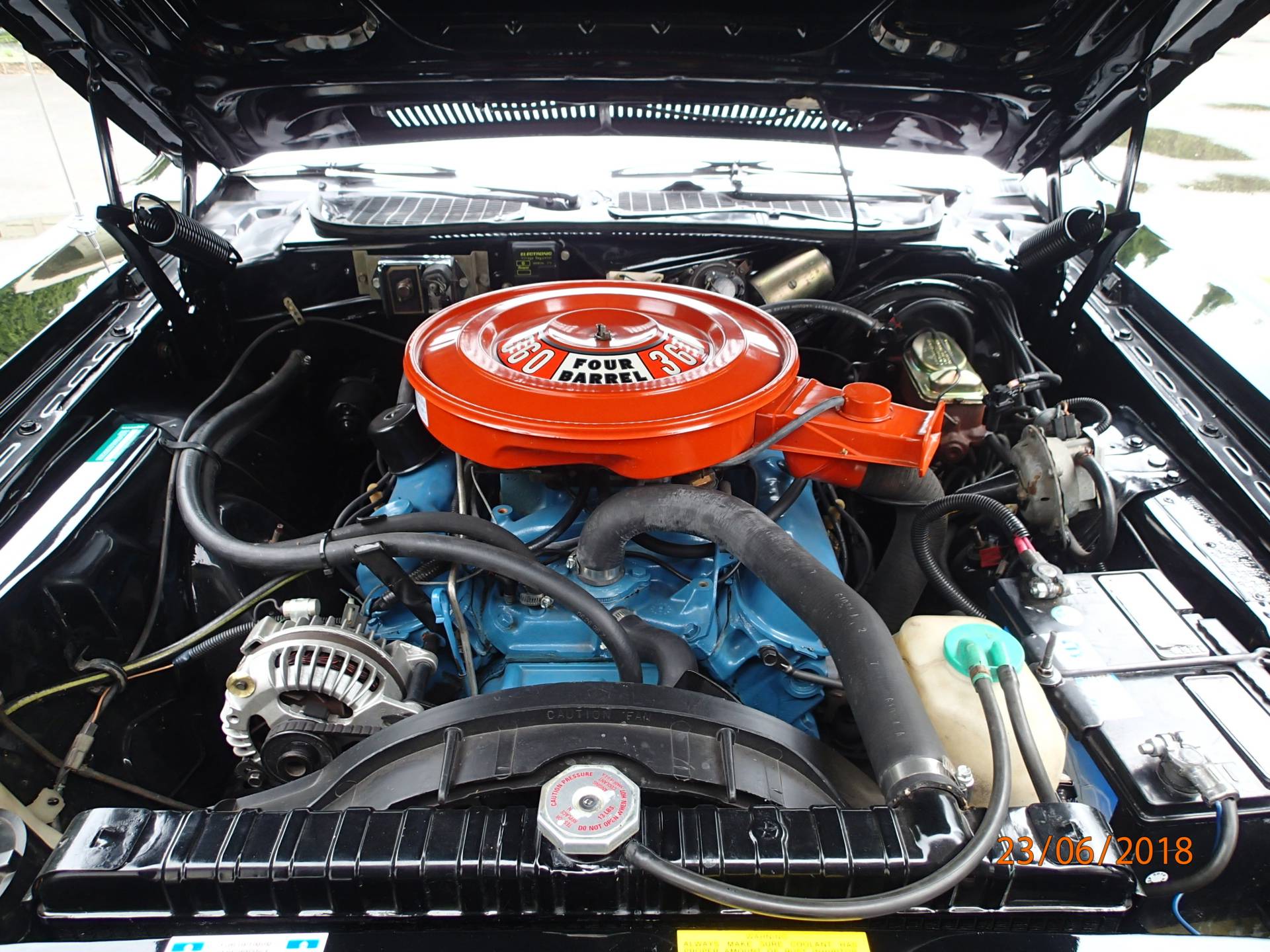

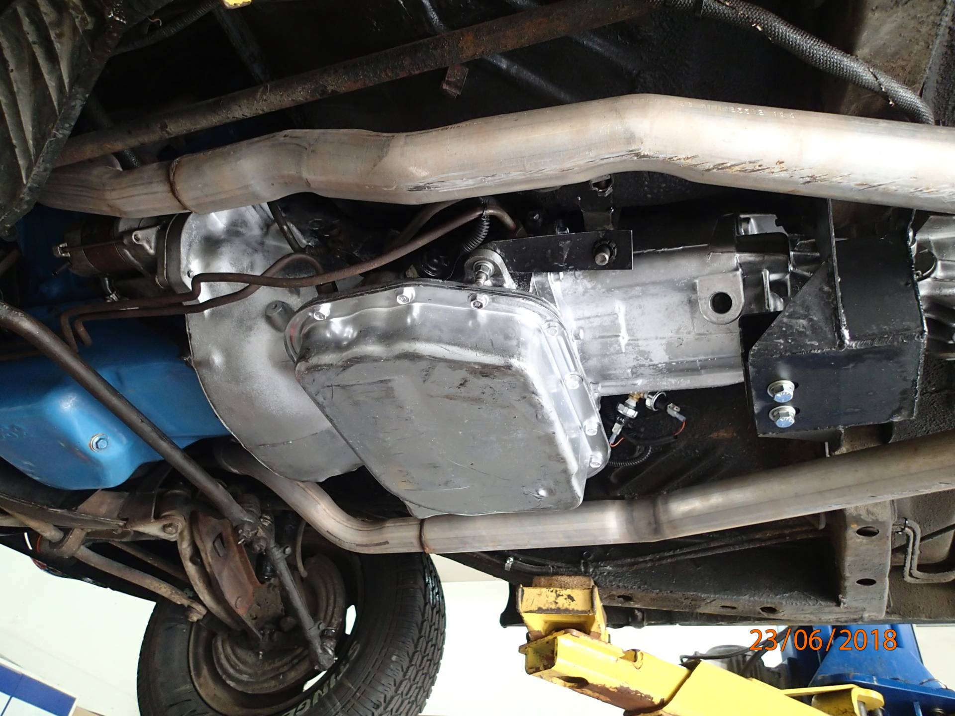

1974 Challenger, 360, 518OD, 3:23 stock thermoquad .I just did three road test and I'm getting 21.6 mpg highway that's imperial gallons 2100 rpm at 60mph.
