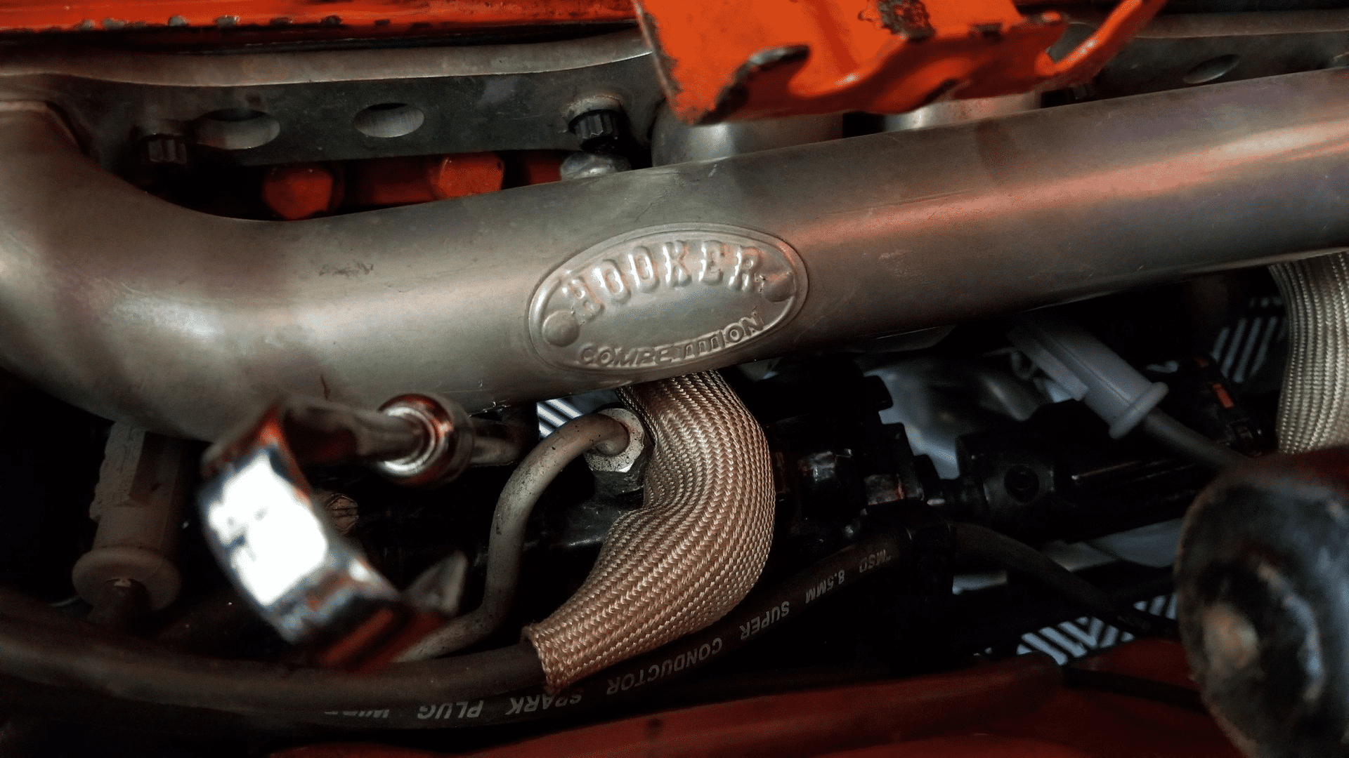

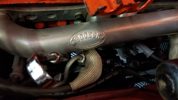

I'm running Hookers Competition Headers.
