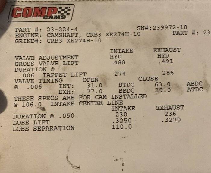

74 challenger. Motor home engine. 440 The cam in it is crane xe274h-10. Stock low compression. I didn’t do the work to it. It runs good but idle sucks. Not horrible don’t get me wrong but I want a smooth idle. I won’t ever probably go past 5k rpm. I just want to drive it around. What do you think about this Melling cam. I’ve had good luck using their rv type cam before but it’s been twelve years since then. Are they still good quality. This is supposed to be high performance stock for a 68 440 hp.

Well the specs on the Melling seem to be off , advertised duration @ 324/ 302 ???, you should be in the 260* range !!
other then that it looks close to a factory cam , similar lift in the mid .400 range & short duration @ .050 lift & 115 LSA it will build / trap a lot of dynamic compression & run well for what you want .
The Comp cam would be a terrible choice for a barely 8:1 compression engine !!

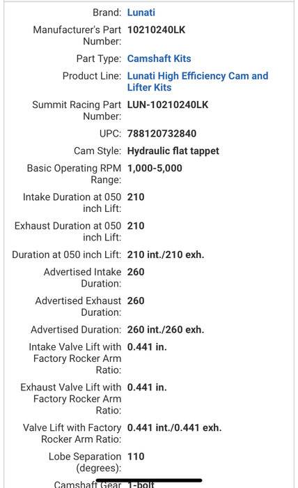

You could also look at the smaller Lunati VooDoo cams like the 701 grind

the Melling would be better , the LSA is not right on the Lunati 110 * vs 115*

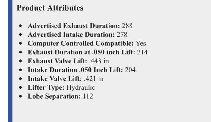

Here is another Melling cam. It seems like the best choice to me for what I want to achieve.

The Melling cam may be a better choice , less duration & 115* CL will work very well on a low compression engine
