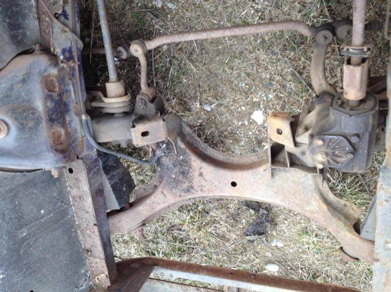

here are some pictures of my K member in my car is it a 6 cylinder or V-8 K member

Definitely a difference between 6 and 8, V8 does not mount to 6 cylinder K frame; one exception though if you purchase Schumaker mounts the V8 will bolt onto the 6 cylinder K frame, probably cheapest and easiest way to go.
I agree , this info is correct
