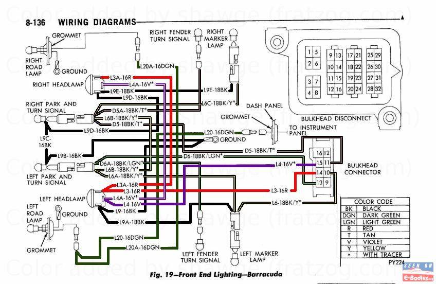

Front lighting wiring.

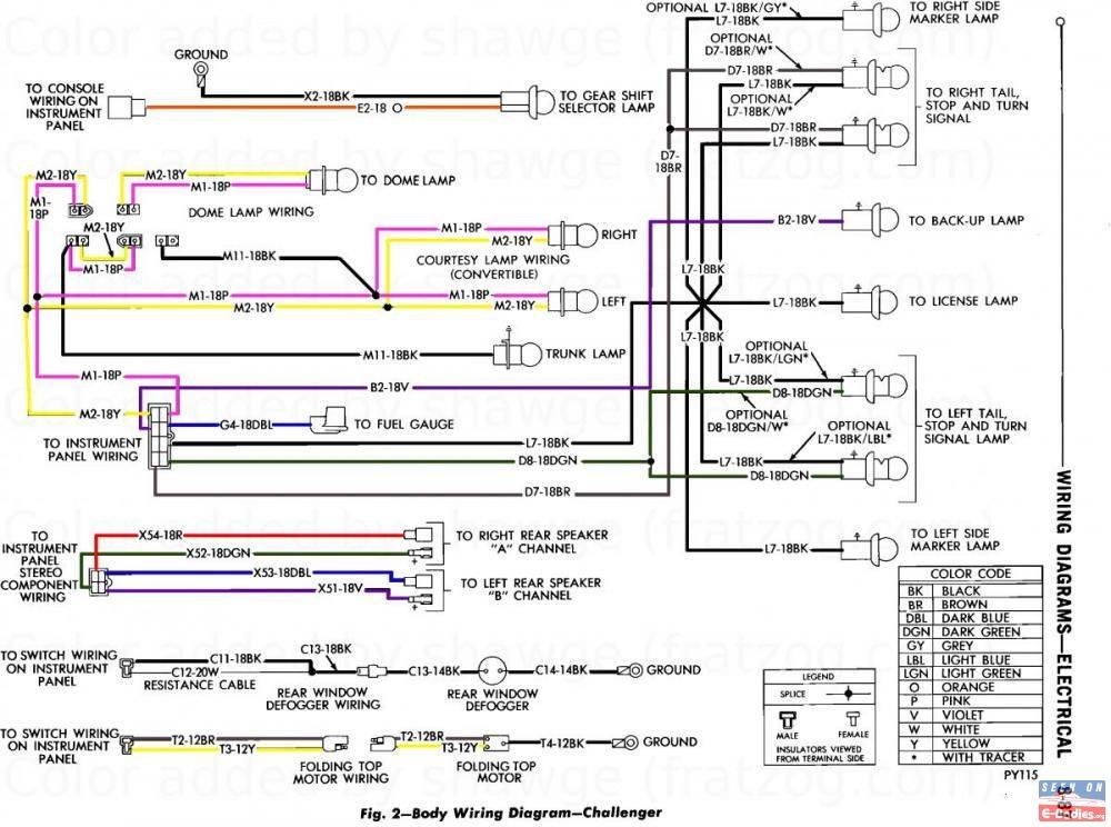

Rear lighting

IF you feel confident. This is not to hard. Unplug connector for the front and rear lighting. apply power to each wire to see if bright or dim. If dim check each wire for broken or corroded sockets,plugs and ground. If bright it's inside. The rear connector is in the drivers kick panel.
