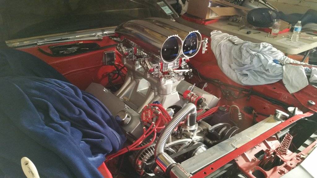

I am thinking the same, a tunnel ram on my 440. Here's some specs:
Mopar performance cast Frank 5249207
BME aluminum rodd 426
Venolia Pistons 535
Brodix B1 BS heads, 65cc.
Comp cams 704 lift, 1,6 rull vippor.
Holley 1050 Dominator APD
Indy intake.
Indy maxxolje pumplock.
Indy valleypan
Melling oil pump
Meziere water pump
ATI superdamper
7 liters oil plan with fast pickup.
0.040 MLS head gasket, Could easily change to 0,066 för ca 11-11,5 i komp
HEI fördelare
Comp cams pushrods
Comp cams roller rockers
ARP bolts everywhere.
NGK racestift
B1 aluventilkåpor
No concrete.
Everything balanced within 1gram
Kompar ca 13 och ska ge ca 650-700 hk.
Could spray with 200-300 hp NOS.
