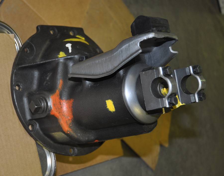

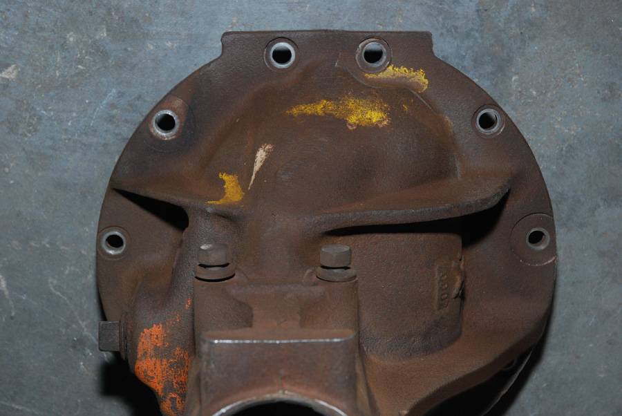

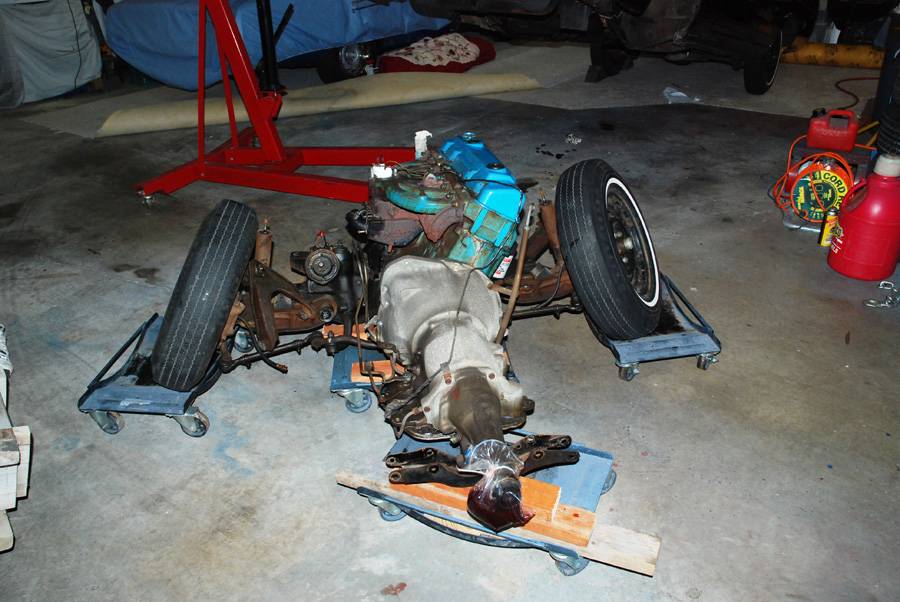

Keeping all the original parts was necessary for Restoring the car back to its original condition. I don't know if MOPARLEO is saying that being pressure washed (for instance) magically converted the components back to Assembly Line condition! I was hoping he would elaborate how the parts pictured below were "cleaned" to look like a brand new assembly. What cleaning process would provide the transition of the parts in the first picture to the second picture?
What "cleaning and detailing" processes would you use to get from this..........
.....to this?

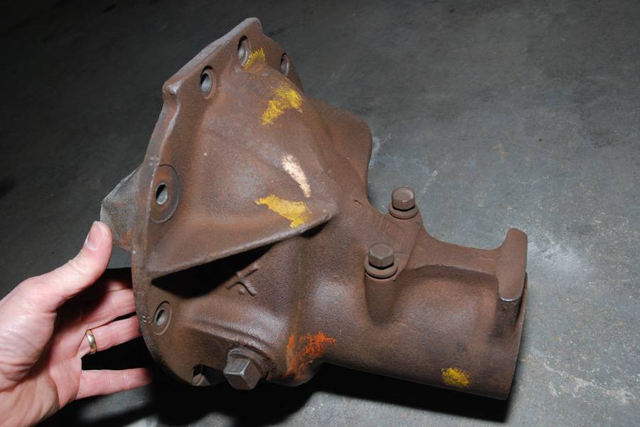

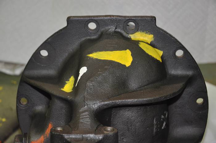

For example, the two inspection marks on the Transmission Case (pictured below) took approximately 6 hours to re-create. It took over 70 attempts to try and match the hand drawn "2" that was originally documented. What took the Assembly Line worker a split second to draw, took me numerous attempts to match. The paint marking was another difficult mark to re-create. Is was a nightmare trying to get the same look AND have the paint drip stop exactly where the original one had stopped running. The Third Member markings took 14 hours to re-create. I would brush the marks and remove them if they didn't look like the ones originally painted on the unit. I would paint them on and remove them if they were not correct looking......over & over & over again.
Since the inspection markings were worn away on the Challenger components, I simply re-applied them like the Guy on the Assembly Line would have! One time and done. Trying to match someone else's 40 year old "signature" is extremely difficult. Like I said earlier, restoring a "Survivor" to its former status leaves no room for interpretation or freedom in the processes.

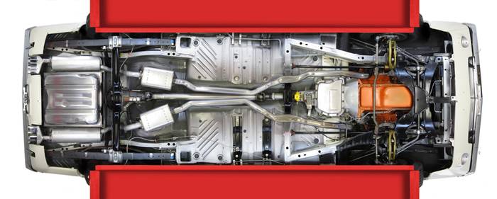

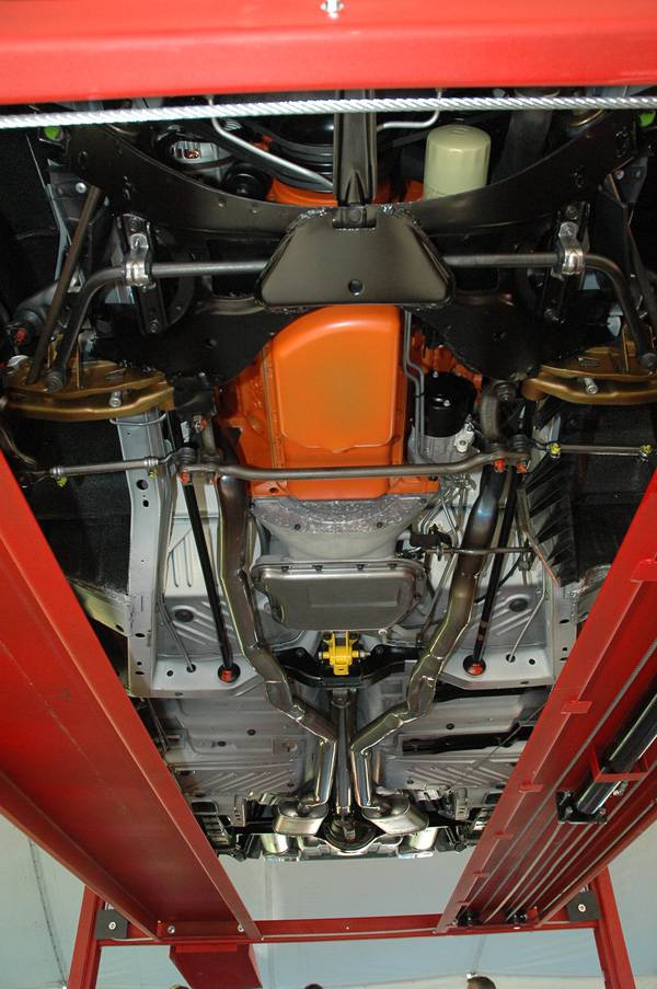

Here is the progression of a few pictures that show some of the steps what it took to Restore the underside. It took EIGHT MONTHS to make the original undercoating look New again. First, we had to remove ALL oxidation with chemicals. No Sandblasting was done to any of the parts or components on the car! We had to maneuver around all of the original features such as seam sealers, undercoat splatter, paint runs, etc.... Every area had to be perfectly cleaned so the different layers of primers and paints would properly adhere. We matched the original undercoat with a mixture of 4 different petroleum products and then used compressed air to manipulate the mixture to look like it was sprayed by a pressure pot device. I used a Q-Tips to trace the entire perimeter of every square inch under the car! It would take an entire weekend just to do a 2 ft. square area! We used approximately 18 different size artists brushes to be able to complete the process. Trying to work, prime and paint around 40 year old undercoating was miserable. After applying the primers and paint we had to restore the original undercoating. Keep in mind that everything had to blend together to look as if it had never been touched. Here are just a few pictures that should provide some understanding to the "Fun" process!

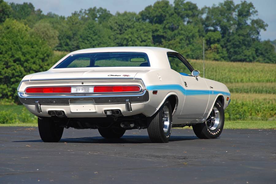

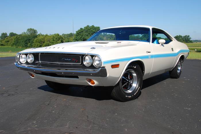

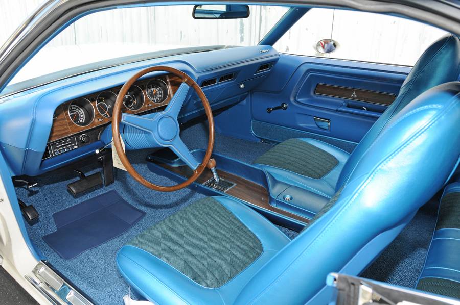

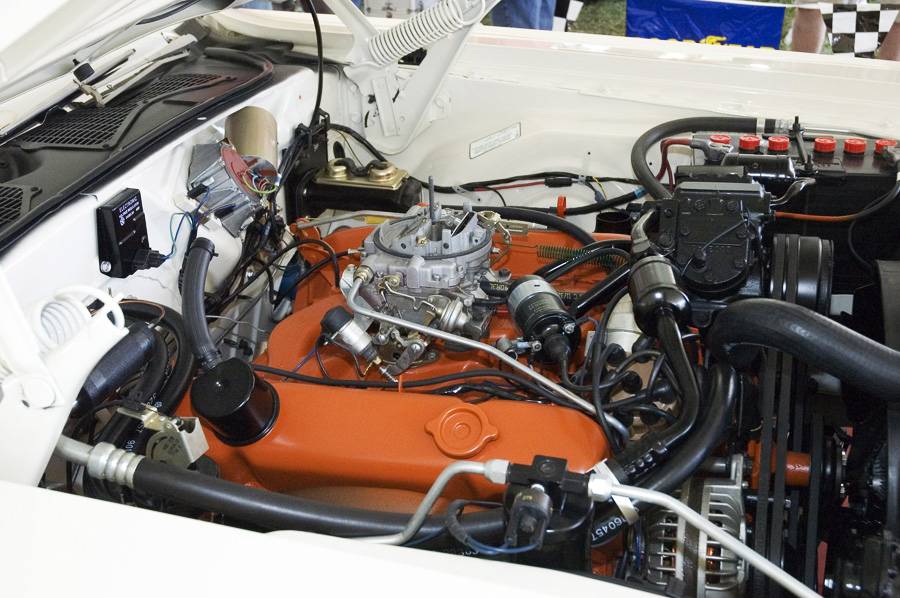

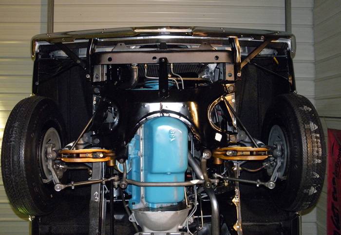

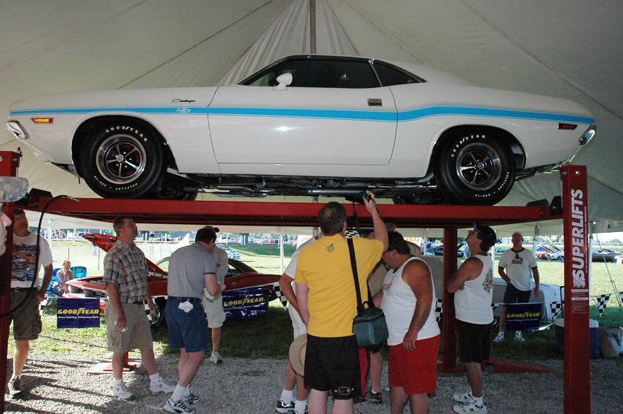

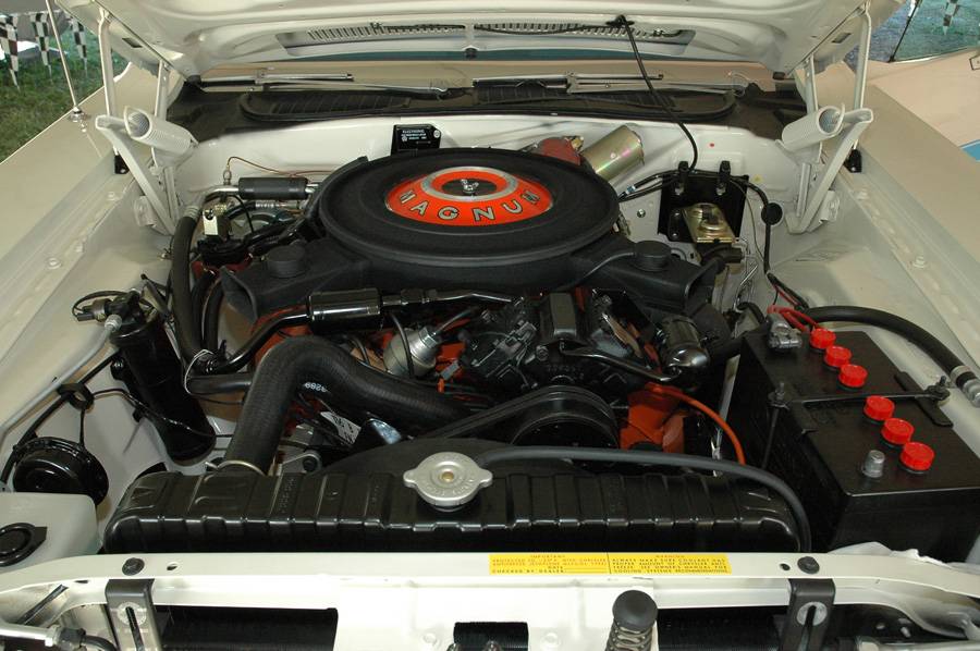

Here are a few photos of the "GROUND UP" 1970 Challenger Restoration. There we many challenges in making this vehicle look Assembly Line New again but it did not have the same level difficulty as restoring the 1970 Valiant Survivor. The final results of the two cars were the same but the processes to get them there were quite a bit different.
