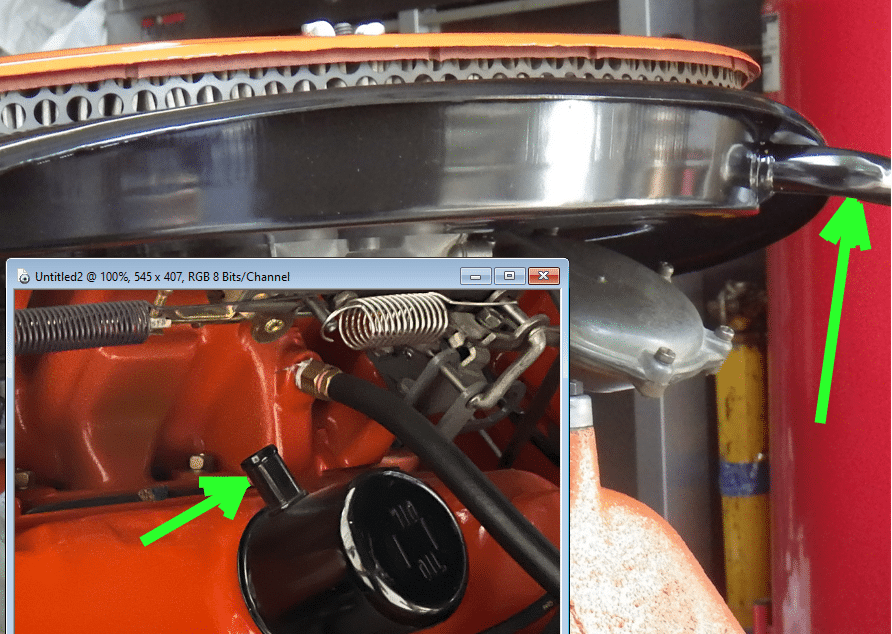

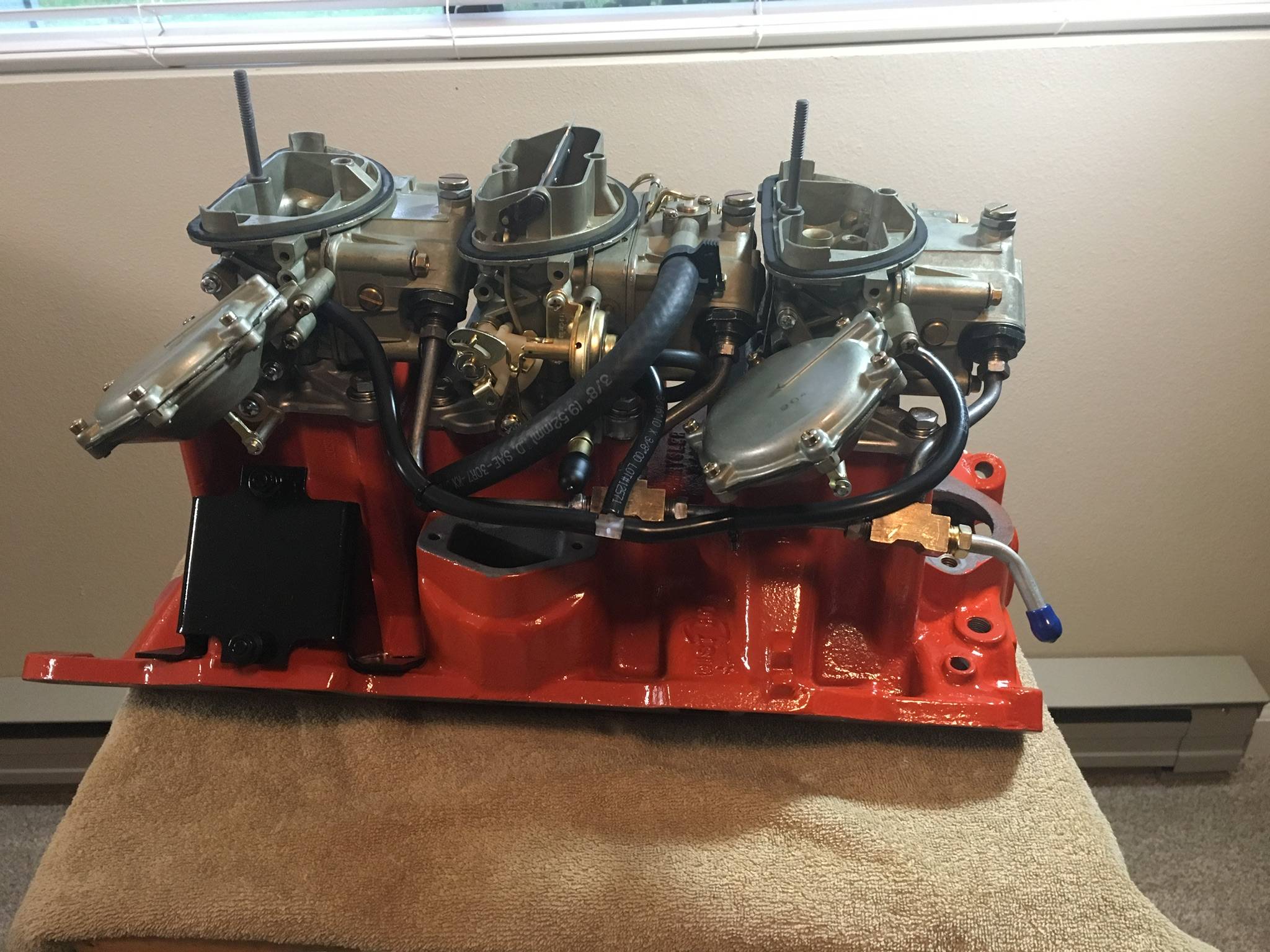

One of those "nipples" attaches to the black filter on the drivers side valve cover.
As to the order, it is very hard to diagnose via the internet. If you are not used to classic muscle cars it could just be normal, however with a 6 pack it could be the bowl vent or perhaps a small leak some place.

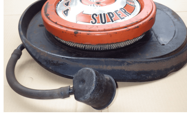

Also wondering where the hose nipples on the air cleaner base are supposed to connect to.
If your air cleaner base plate has it............
similar to a four barrel.......
The others look right for a non-vented center bowl.

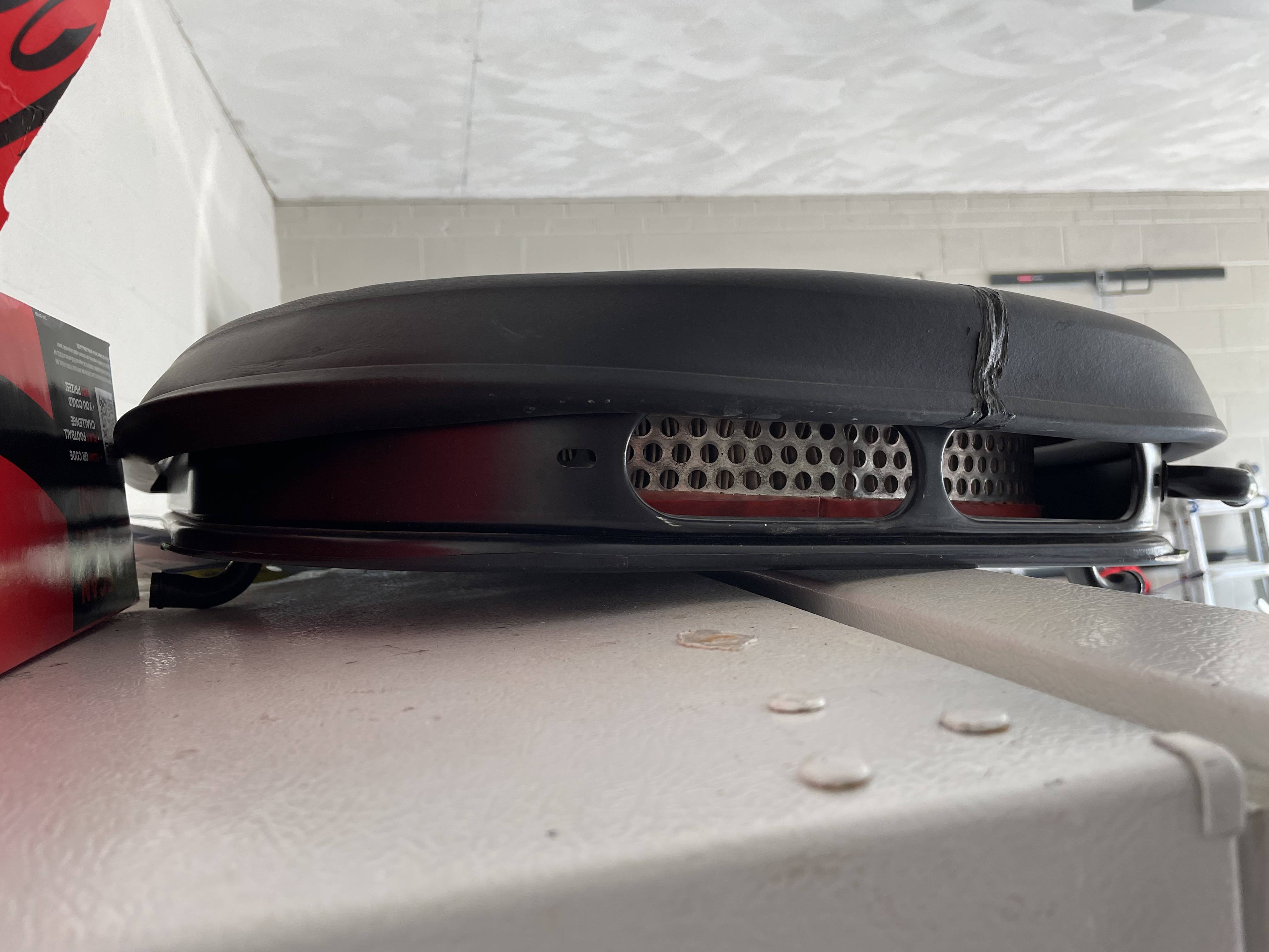

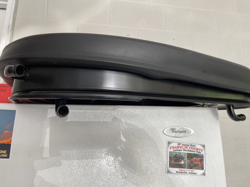

My air cleaner has 4. One on driver side, two on the passenger side, and another at the rear on the passenger side. Seems like a lot.

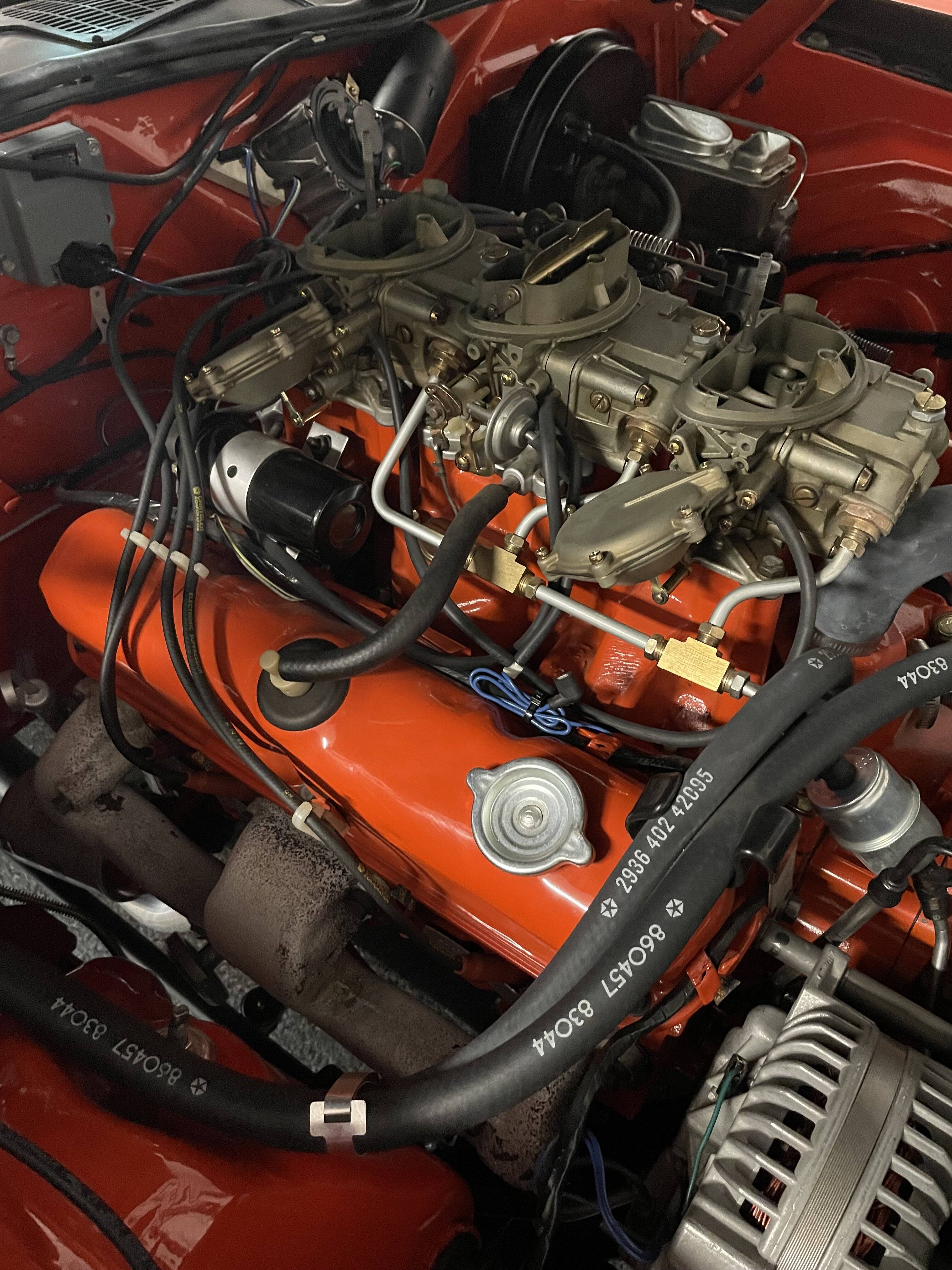

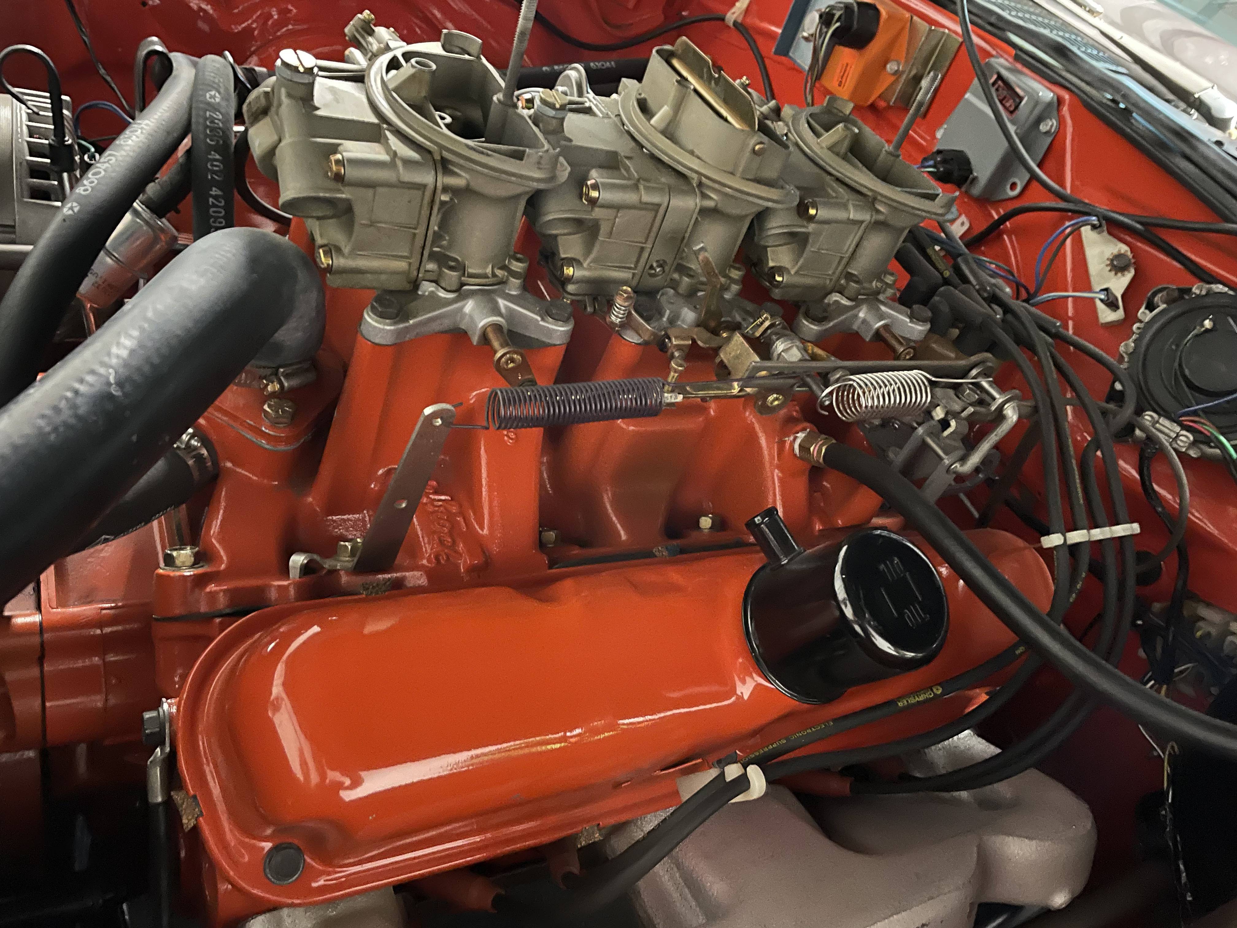

Pics detail the multiple nipples. I guess I should just cut a length of tube for the three “drains” and connect the upper rear to the breather on the valve cover?

PVC valve should be on the driver's side valve cover typically, with the PCV hose running around the back side of the carbs. Although this method does substantially shorten that hose.
The large breather cap then has a a short hose going to the nipple on the air cleaner on the passenger side.
Neither of those things should result in a fuel odor though. Possible the floats are set too high maybe?

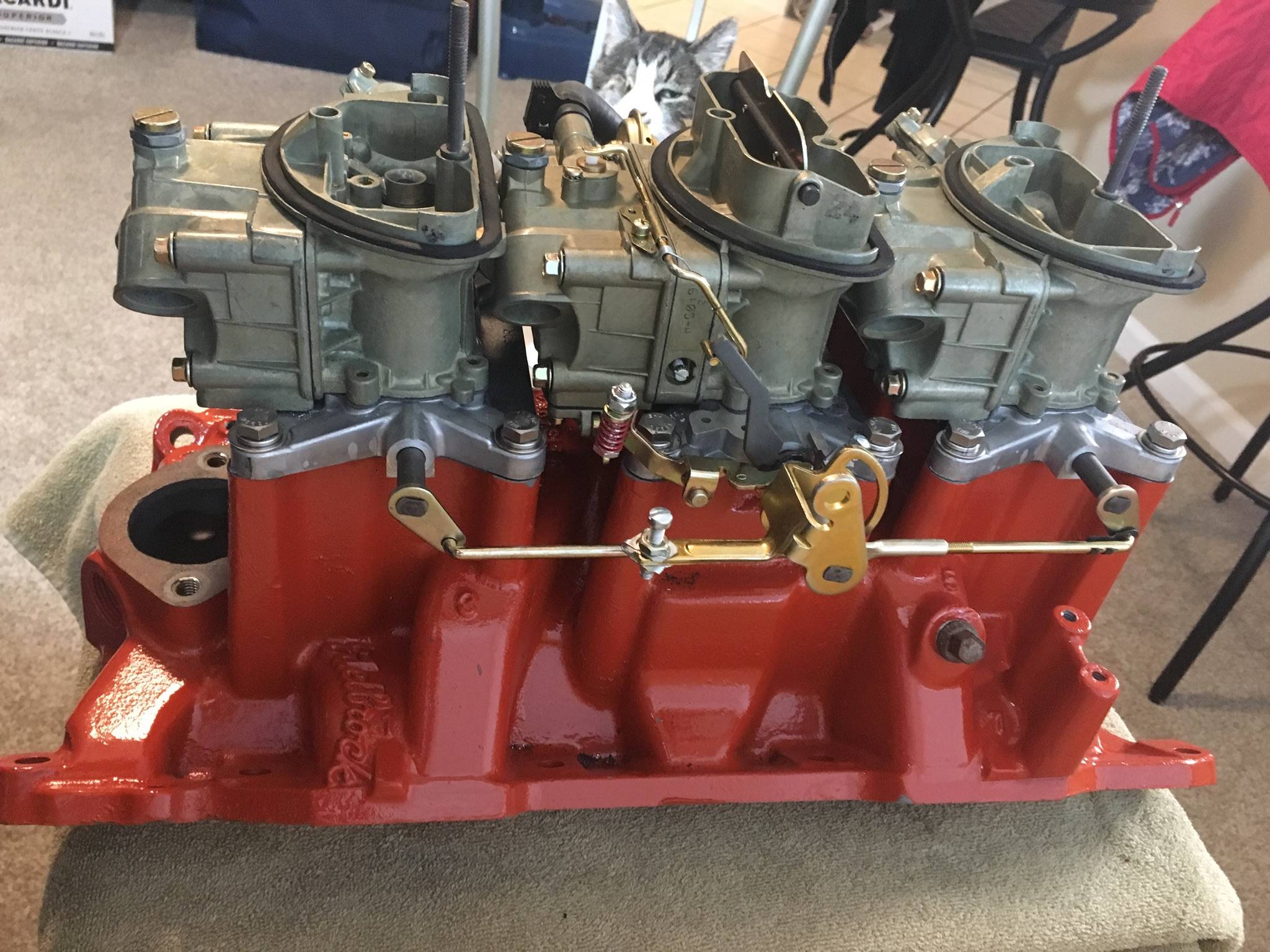

How does it start ? I have three six pack setups two vented and one not vented center carb .Could be a fuel drip from center carb causing the gas odor .I sent my center carb to Holly for a rebuild and that did the trick ,my rebuild did not fix it ,they also flow test the carb .
