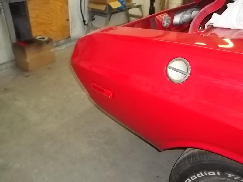

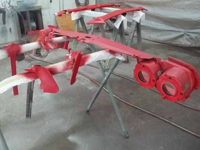

.................fuel tank, tank pad and straps, filler neck, dash painted, trunk lid sliders.......

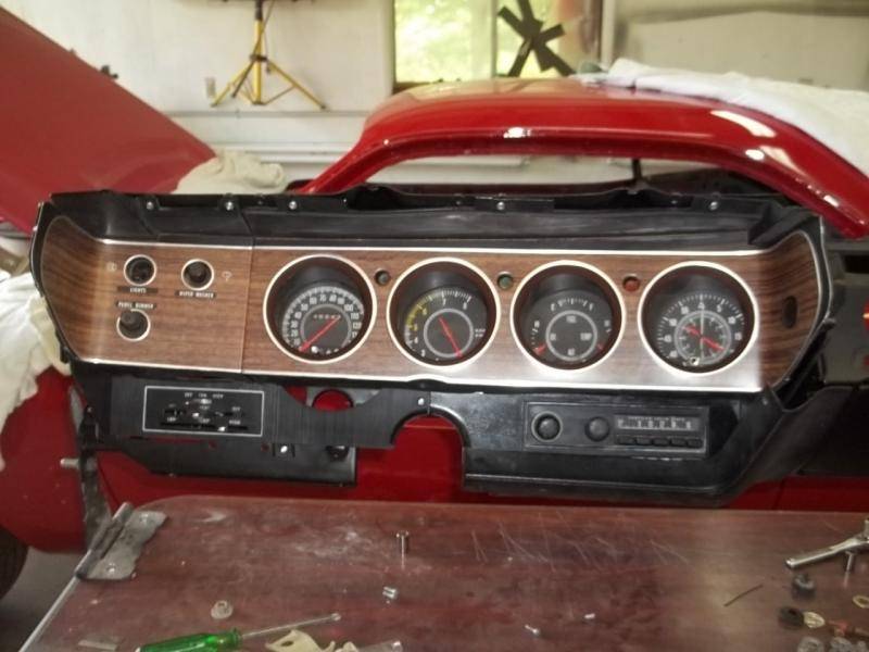

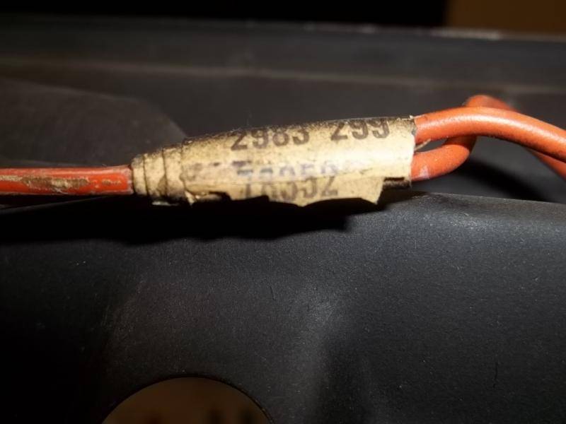

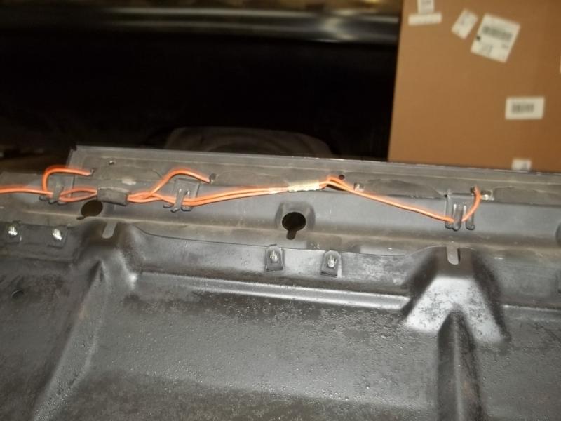

Question, if you dash is still out can you show me (post or PM) where the upper light bar connects to?
After reassembling mine recently I, for the life of me couldn't remember/find where it goes.
Thanks,
Mike.
a68postcar
Feb 5, 2011
334
8
here you go Mike. i have this mocked in place to get it out of the way. after the pad goes on this is the last piece on. hope this helps.

Thanks for the reply and nice teaser. It does look impressive
but...

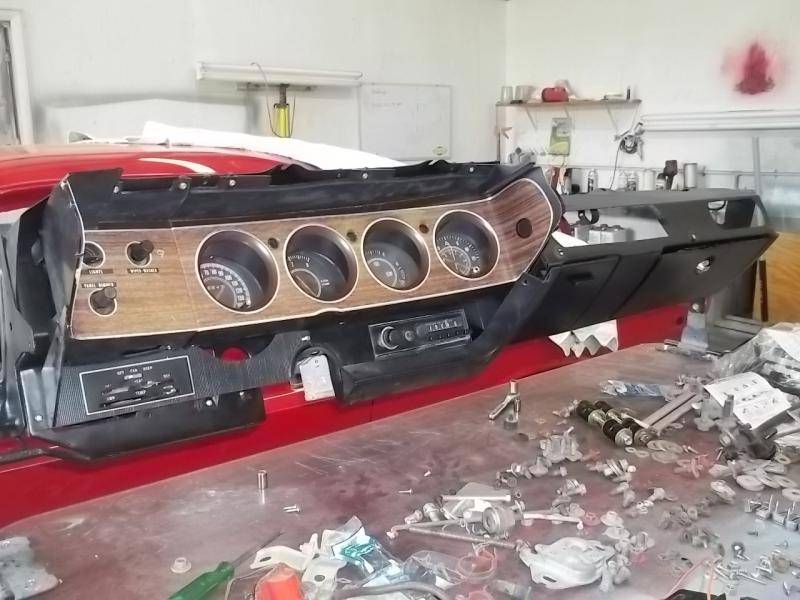

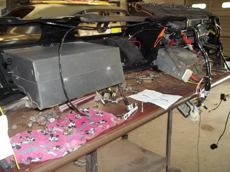

I do not know where the upper light bar power wire plugs into. Does it plug directly into the back of the gauge pack or into a plug on the harness itself.
Sorry for the thread jack.
burdar
Jul 10, 2009
521
30
IOWA
The Rallye light bar wiring is orange. There is an orange rubber three pronged plug in the main dash harness. The light bar wiring plugs into that...as well as the glove box light if you have the "light group".

burdar is correct! sorry there's no prize but anyway.......here is this one

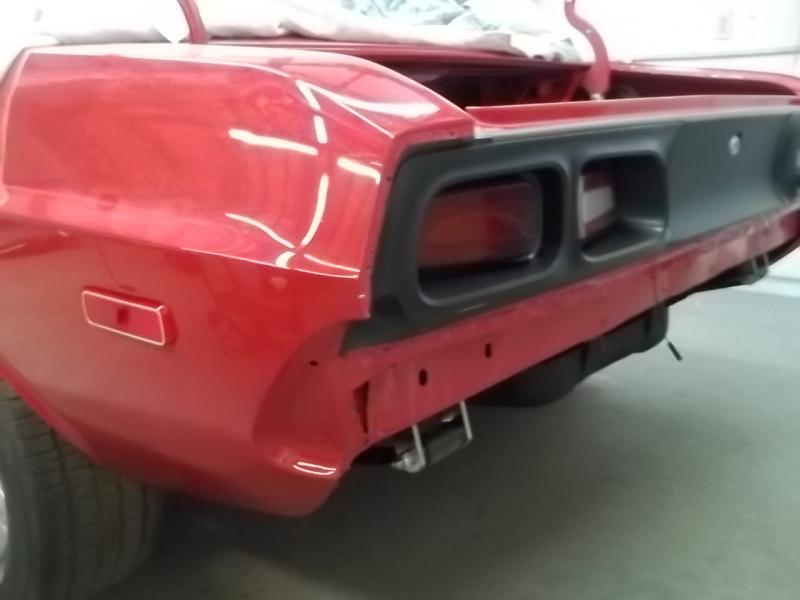

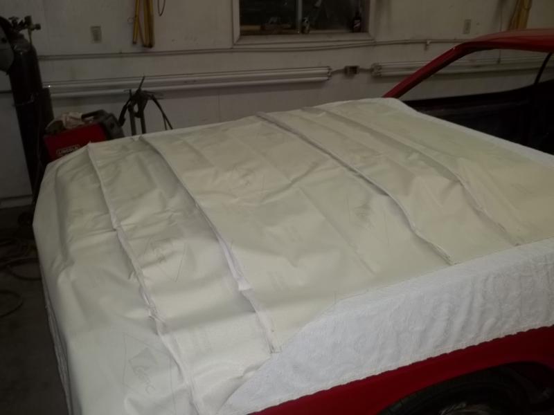

............. hradliner and bows. windlaces, rear side markers.............

in reference to the above posted list, on go the parts............
