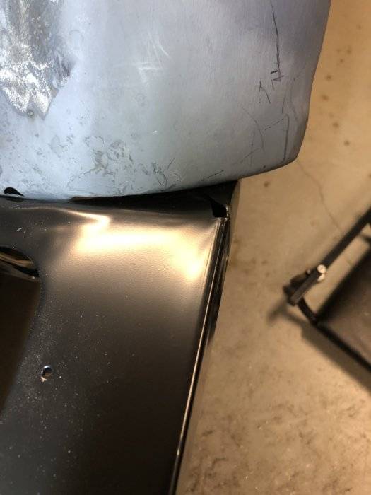

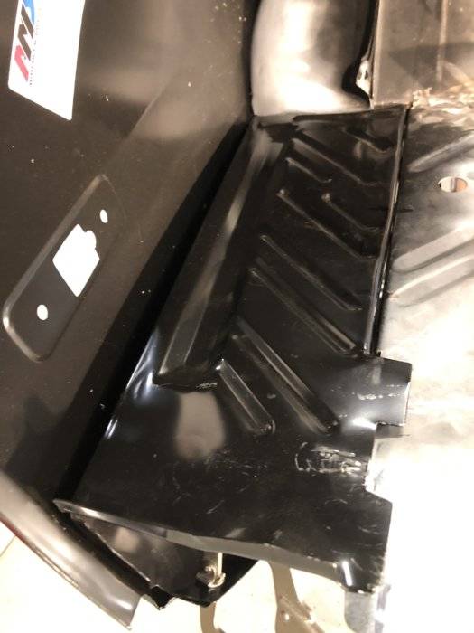

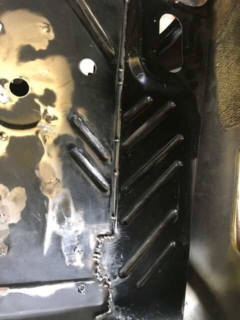

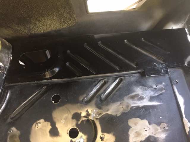

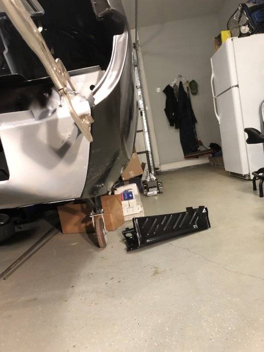

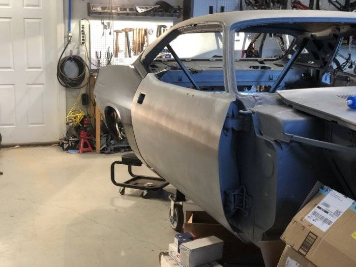

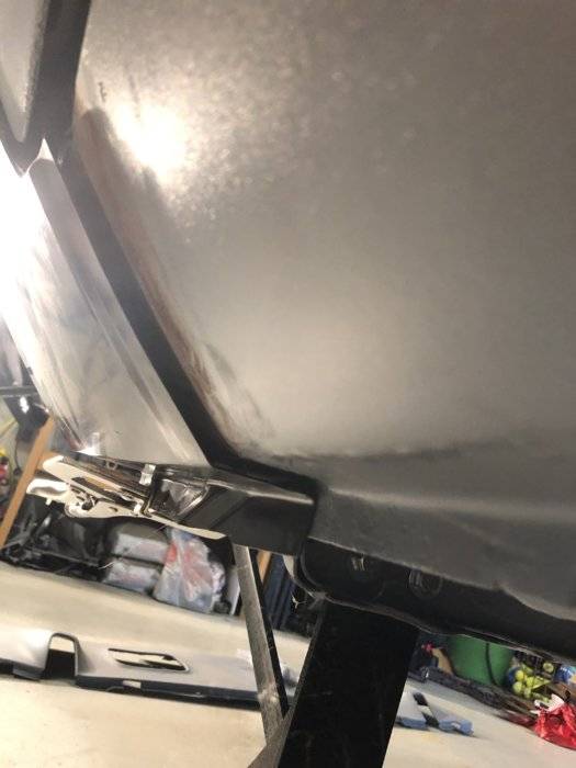

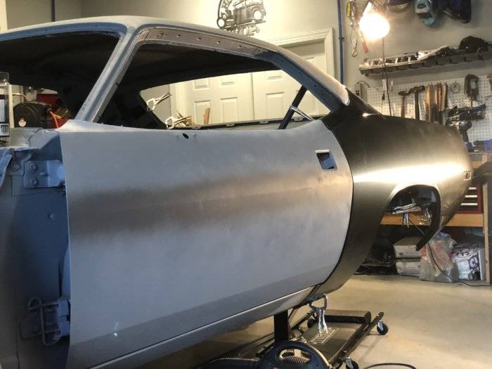

Finally back at it finishing up some work in the trunk floor. What are the pros/cons on installing the the trunk floor extensions before the quarter panels? It’s obviously easier to install them before the quarters, but easier to adjust the quarters with them off. Any experience you want to share?
I am leaning toward installing before the quarters. Plan is to test fit with the quarters on and basically mock up the whole rear end. Then remove the quarters/tail and install the extensions. Reasoning is mods on the tubs probably has created fit issues, so need to be able to fix any issues before putting the quarters on. Then i’m going to paint everything before putting the quarters on. Seems like a reasonable plan.
As a reference, my car has a new one piece trunk floor and I Mini Tubbed the wheel wells- which turned into a bigger PITA than i thought. New complete quarters and tail pan.
