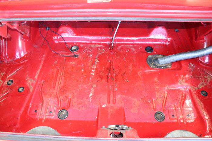

Bracket in the A66 vert for sale:

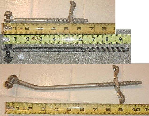

This seems to be the bracket in most Challengers in both verts and hardtops

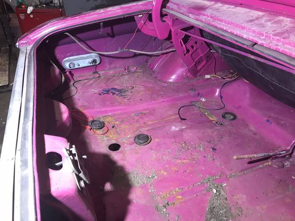

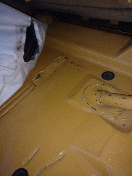

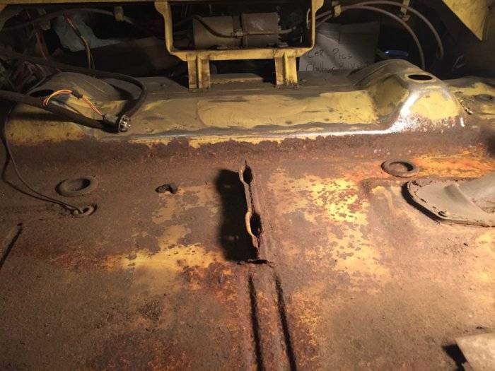

This is what my bracket looks like in my early A66 vert
