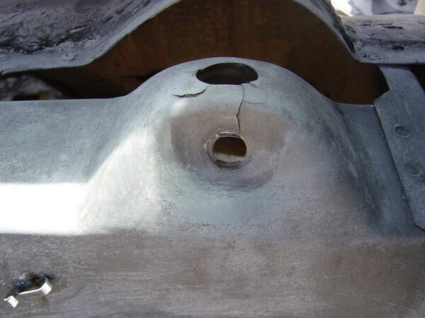

I agree with Leo and Chryco; This car only had 92k miles and air shocks. The upper shock cross member is too thin to support the weight of the car. Also, you will not be able to easily see the damage as it is on top of the crossmember and under the trunk floor. Air Shock.jpgShock Mount.jpg
