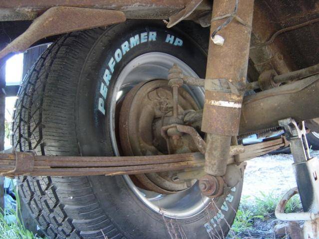

Thanks for the pics Adam yes this can happen with air shocks especially after the springs get weak i have over 100,000 miles on my AAR and i have load levelers on it for years and no damage to the crossmember or the trunk trunk floor that is why i mentioned them as an alternative to adding leafs . I have never seen that on a 68-70 B-Body as i mentioned in my post including my own 70 RR i owned in 73 and ran high jackers and 3 inch extensions

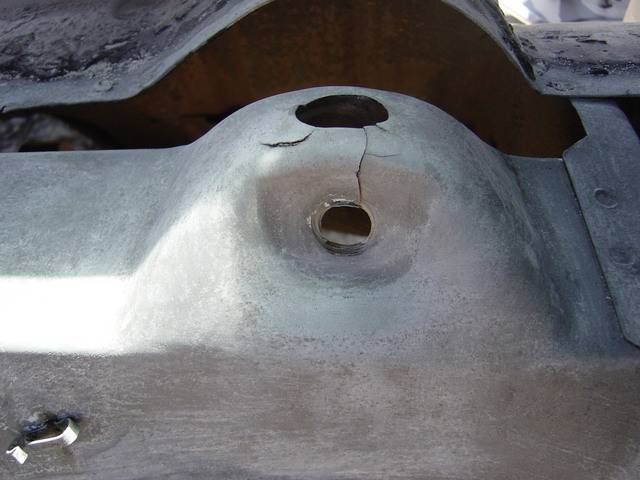

I agree with Leo and Chryco; This car only had 92k miles and air shocks. The upper shock cross member is too thin to support the weight of the car. Also, you will not be able to easily see the damage as it is on top of the crossmember and under the trunk floor. View attachment 15260View attachment 15261

I dont know anything about load levelers, but I do know that metal is too thin to support the car for long. You may get away with it for a long time, but why risk expensive damage to the crossmember when the proper way is so easy?
Also, you cannot see the damage unless you pull one of the shock plugs in the trunk pan.

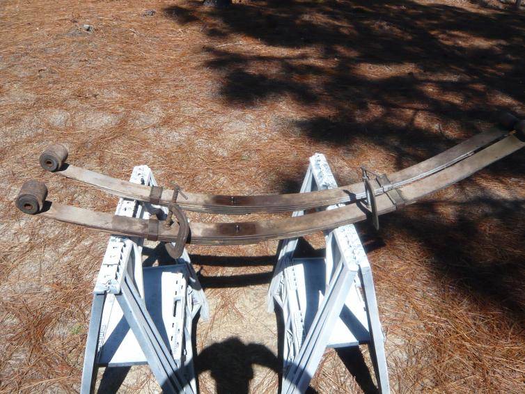

Well I took the old springs apart today and going to get the longer center pin tomorrow.Was easy to do,used c-clamps and vise grips for the center pin. Will post pics asap.
