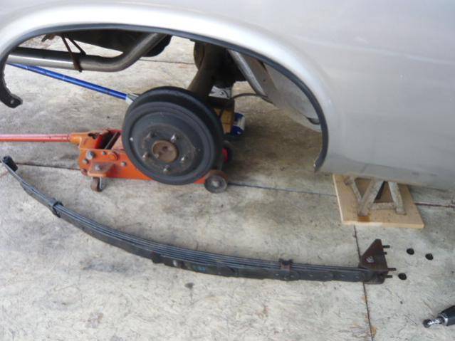

Hey Neil do you think 2 leafs is to much. I thought I would install 2 and see how it looks. If to high I can just change it to one. I dont want it way up in the air but I dont want the tire in the wheel well. I was planning to use the 2nd and 3rd leaf. Leo were can iI get the new nylon pads?

not sure , I have mixed spring packs in the past but it depend what you are starting with generally 1 is all I have used except for adding extra 1/2 leafs on the front end

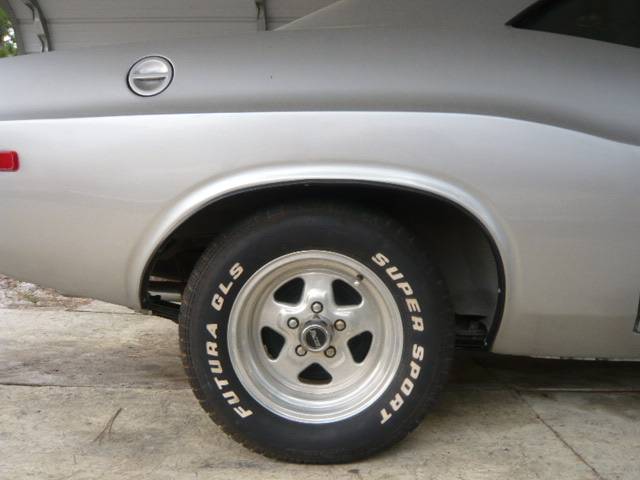

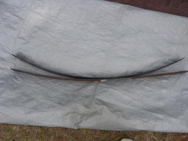

added the springs today. Kind of odd the top spring is the old bottom is the new one, old has more arch to it ? Added 2 springs and this was the result. Took about 6 hrs and took off the air shocks.

Thanks guys,I like the look. Still dont know why the old spring had more arch to it. Mopar springs are made in Mexico , guess everything is made in Mexico.

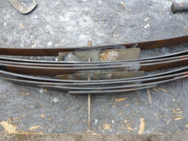

I do this all the time , generally I use the old main leaf & just trim off the rolled ends & put it up to the main leaf in the new set , it will raise the rear approx. 1 " , you will need new center bolts , I use a c clamp to hold the pack together & you need to use a clamp on the front end , I typically use a bolt on clamp , this will stiffen the front section of the spring pack aiding traction
That is exactly the method I used for mine and worked very well. However I didn't want the ride height increased so I lowered the main springs (now two on each side) by a set of calibrated belts with a large hammer. There is a technique I was given by somebody and you can measure the difference with a tape measure and it is quite accurate. Made the driver side 1/3 inch higher to compensate for driver body weight
