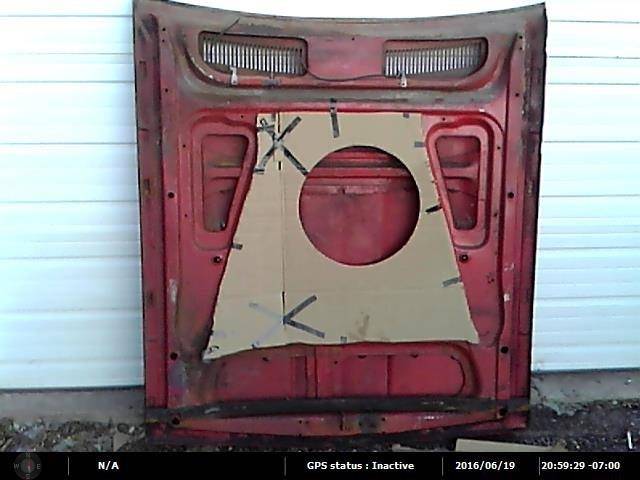

Well i'm not a fabricator but. Here i go! Went to Wal Mart today and got some foam, got there largest cookie sheet,(for the base plate) and some weather adhesive to glue the foam together. took some cardboard and made a template to cover the large hole in the hood, cut a round hole off set to the right of center. Now I will need to seal up the other two braces. Test fit it and see if i got the air clean hole right.
Then i will take it to a fab shop and have them make my cardboard into aluminum sheets. Then screw them into place.
If i didn't run an air filter, it would be a lot easier to build this thing, but a air filter is a must for me!
My current filter is a 14"open element air filter. I think i will have to go down to a 12" one to give me the air space around the air filter and the foam seal around the hole.

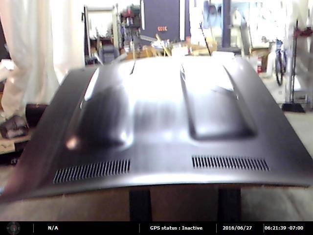

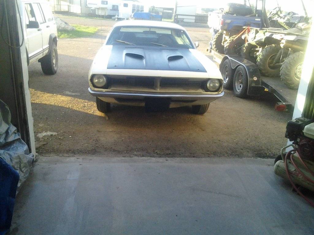

Well after priming the hood inside and out i found out the this hood really sucks and flat black primer won't even hide it.
No body man, and spent 3 days on this hood
Yes you can see that i rattle canned it, and it still doesn't look that good. but i will have to pay someone to get it better(won't happen, would have to tap into my new converter fund LOL)
Today is the day for a fresh air system.

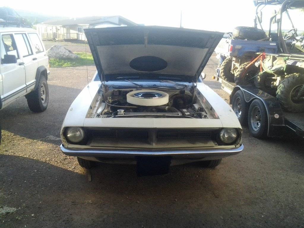

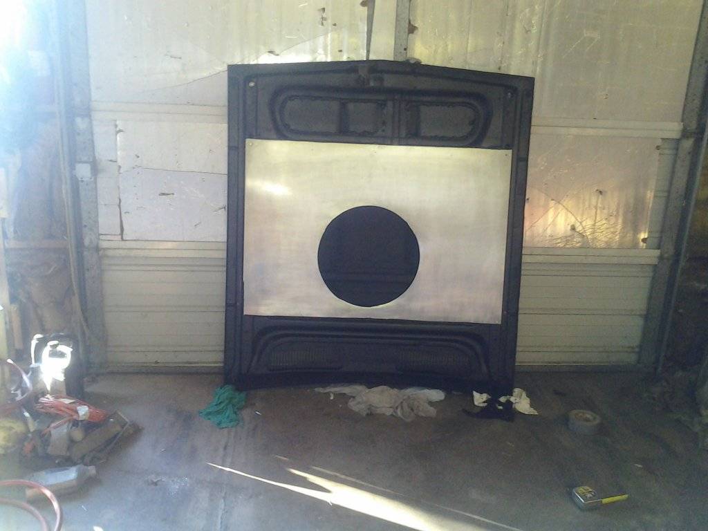

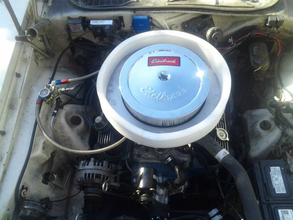

Well here is my first twin scoop fresh air system. Went away from the more complicated triangle shape and made it square..sort of.
had a hole cut into it 18" in diameter. had a BIG washer made out of alu with a center hole a 11" and out side diameter at 20" screwed it to the air filter base plate. glued some one inch by 3" tall foam around the outer end of new base plate.
My air filter is 14 inches so that give me 2 inches of air space all the way round my air filter.

Yeah that is one thing that i have not addressed. A drain hole. Rain and High humidity is not going to be good on that paper filter.
Although it is a street car with full interior, it never goes anywheres that it's not on a trailer. Haven't licensed it in over 10 years. It lives in my garage when it's not at the track. but still i think it needs some kind of a drain hole. Just haven't figured out where to put it.
The front of the hood is sealed with expanding foam, but the backside, up next to windshield(fresh air for the heater/AC box is not. So when i raise my hood, any moisture should drain out.
That leave the air filter box. may have to find the lowest spot and drill a small hole.

My shaker has two holes. One on each side in front with a short hose pointing down. Each is about where the intake meets the valve covers.

Hadn't thought about a hose to direct the water away from eng....thanks!:cool:

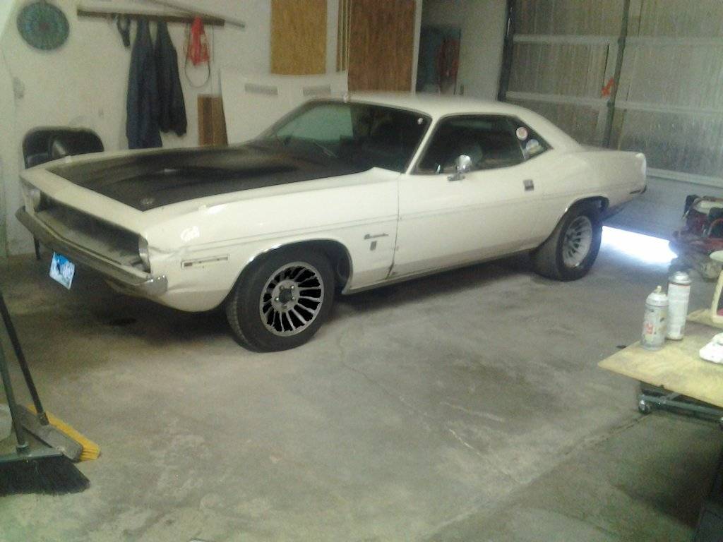

So, it just don't look right...... Maybe i have been looking at a white flat hood for to many years......o_O;)

Here is another picture. I think i will paint the inset of my rims black. what do you think.
Not to good with paint program and a mouse for a paint brush......But you get the idea.

You could paint the fender tops and the header panel black like an AAR.
Cudafever
Dec 23, 2010
146
11
You could paint the fender tops and the header panel black like an AAR.View attachment 28039
I have been pondering that as well.
I when threw all the pic of cudas in the Photo Garages and it seems like most were just painted body color. So thoughts of that, have been crossing my mind too.(white hide a lot of body work)
Maybe just a factory black Hockey Stick on the back that says 408;)

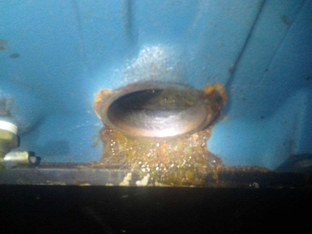

Mounts will be here friday. pulled the motor because i have a troublesome coolant leak. Even the expandable rubber plug wouldn't stop the seep.
Anybody been down this road and have a good idea how to get it to seal?
