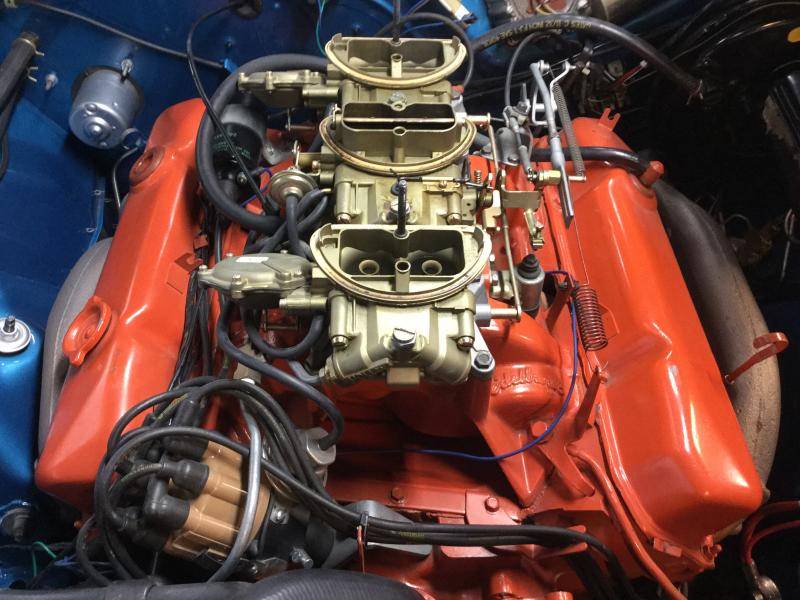

I have a 340 Six pack and I cant feel anything or tell if all three carbs open It just feels flat no pull. I checked everything linkage carb opening full throttle just don't see anything It feels like a two barrel. The weired thing is I have a spare set of carbs and they do the same thing so Im thinking something is preventing there opening like springs maybe. The engine also falls flat at 4800-5000 rpm that's getting worse. But the carbs just aren't impressing me. I had a 440 Six pack and you could hear and feel them when cracked wide open.

Might not be a stock vacuum setup. We don't know what he has other than a six-pak setup. In 40 years someone could have made changes that is why I wanted to see what he has in a picture. My crystal ball doesn't work that good.
FYI we had another member with a similar problem and a prior owner had blocked the outboard carbs with a solid gasket under the carb bases. You never know.

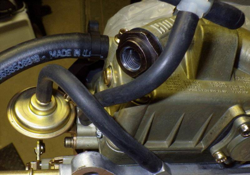

Ok I went out and pulled the vac hose and checked for vac engine running. I have had the hose installed on the lower vac port and there is no vac signal not even ported vac. The upper port had straight vac when I attached the hose there was a vac squeal very light amost hard to hear. This location is opposite of my manuals have I missed something these are on new carbs.
72ls5fla
Dec 2, 2014
38
Tallahassee FL
the hose for the choke pull-off should be attached at the baseplate by the corner bolt and the hose for the end carbs attached at the nipple on the metering block up top (will have a slight bend to it).
the upper port might have a very slight signal at idle, depending on idle speed and how you have the throttle plates and idle mixture screws adjusted.
but once you slam open the throttle, it should build up to where it pulls max VAC.
switch the hoses around and take the car for a ride - bet you will get that kick in the butt you are expecting.
You had the hoses on correctly. The upper is distributor advance. Just below is the outboards diaphragm port. Hope you didn't compromise a diaphragm to get that squeal. Sounds like a leak though. I'd use a vacuum pump on each outboard separately.

Well I originally had the hose correct and couldn't get the outboards to open switching the hose to the upper curved port on the metering block and then the outboards work.
72ls5fla
Dec 2, 2014
38
Tallahassee FL
hey --
what Daves69 is showing is correct. He is right about the upper port for VAC advance.
the port right below it (with short straight tube) is for the end carb signal source. I mis-spoke in my post.
so if you connect the vacuum line to it and don't get any feed, then there is likely a clog in the bleed hole.
I would spray carb cleaner in the port tube on the side and see if it will flow out in the throttle bore.
if not, then there is an issue.
The good news is that the secondaries are opening - so all the vacuum related parts on the end carbs are in working order.
If you leave things as is, with working secondaries you will not get any vacuum advance signal to the DIST. so you will be on mechanical advance only.
