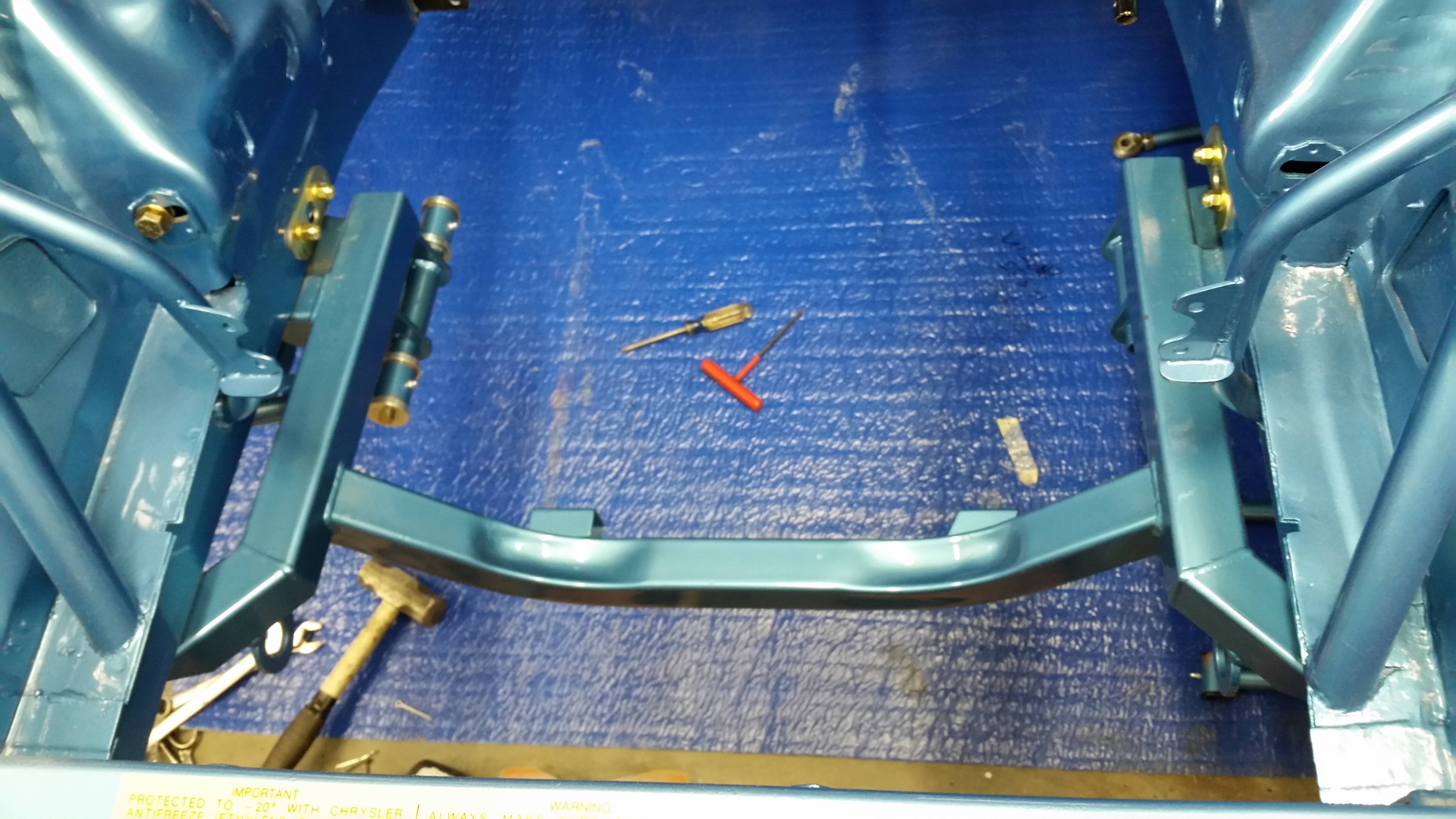

To the OP (FIchallenger), I'm currently running the same suspension as you, and considering a 4 link for the same reasons.
For me, QA-1 will be the choice. RMS Street Lynx doesn't allow tailpipes with a Dana 60. QA-1 does have room (barely) for up to 3".
