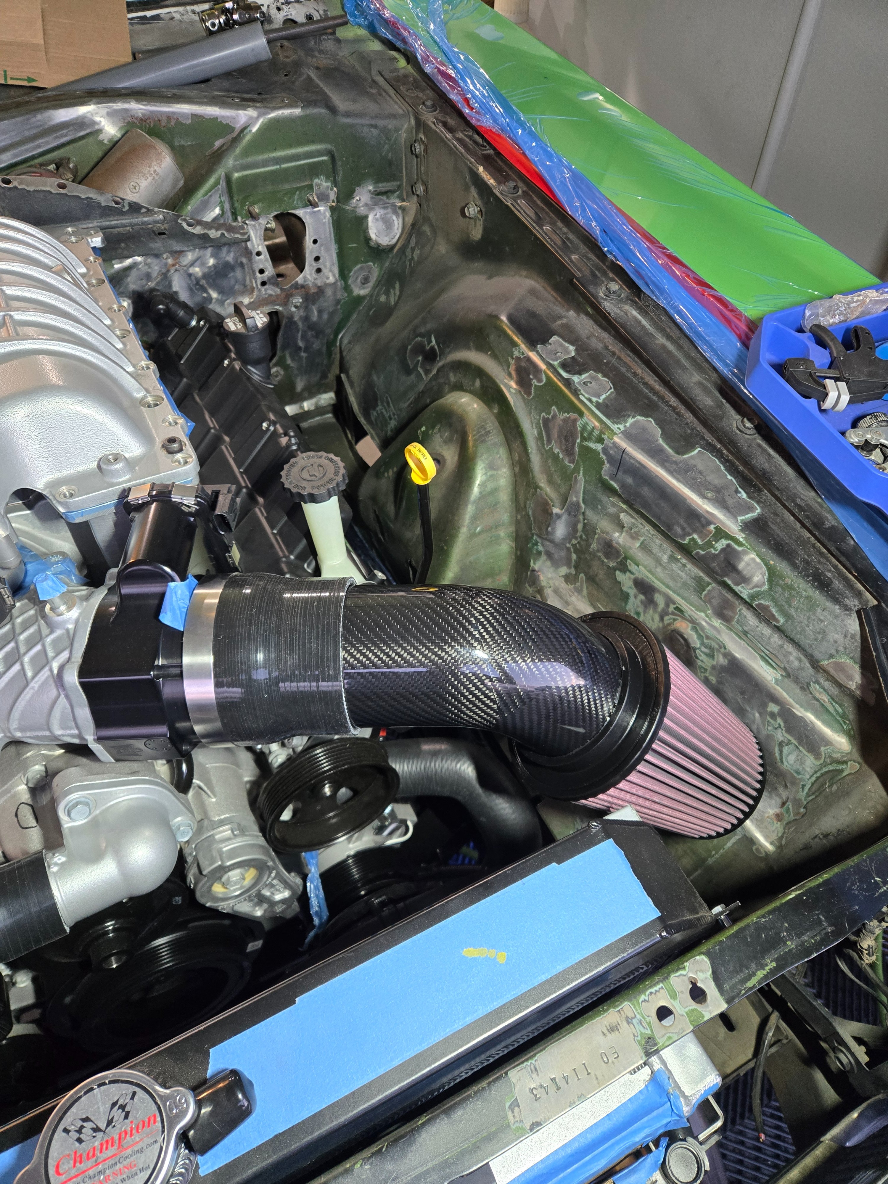

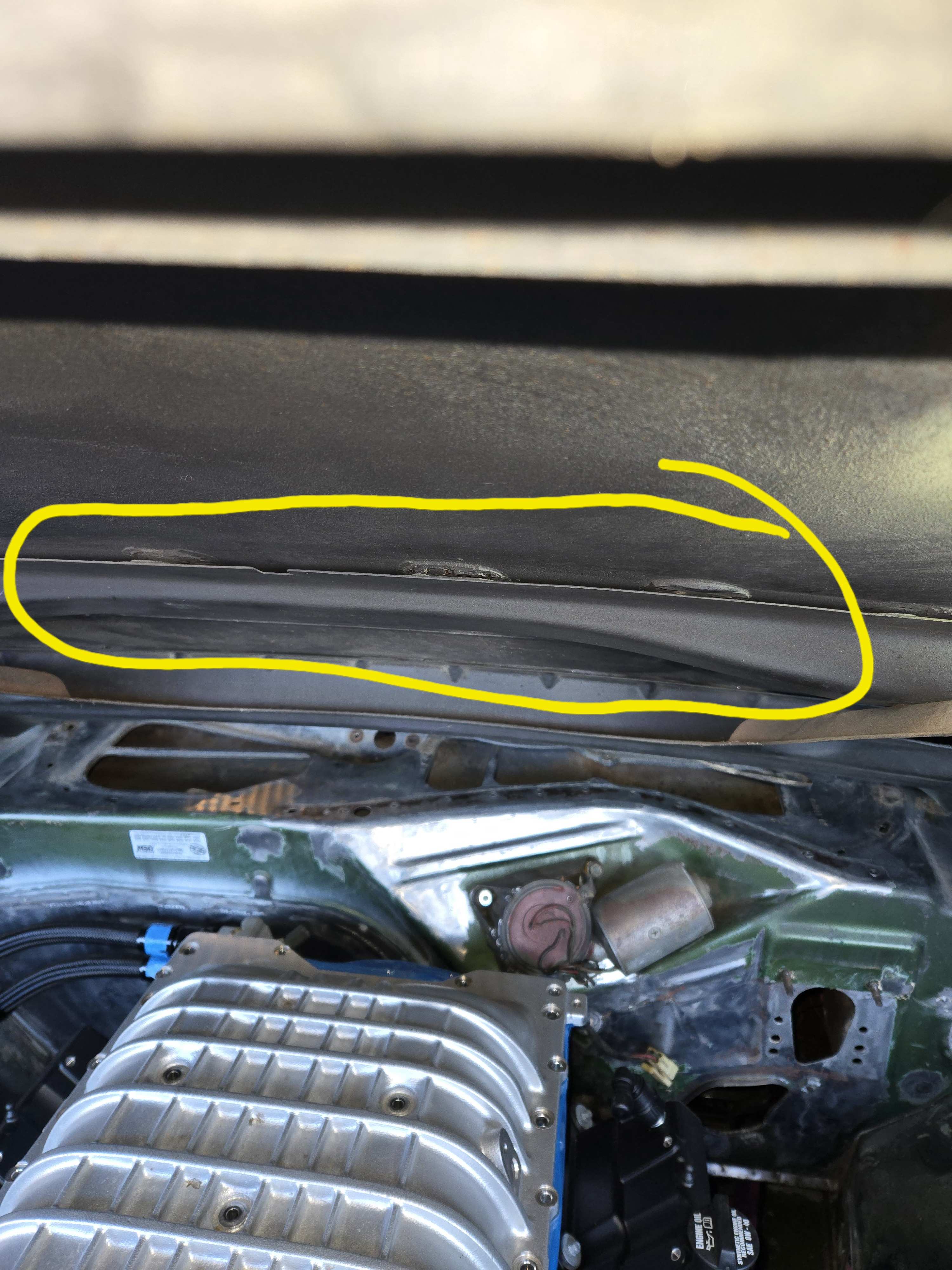

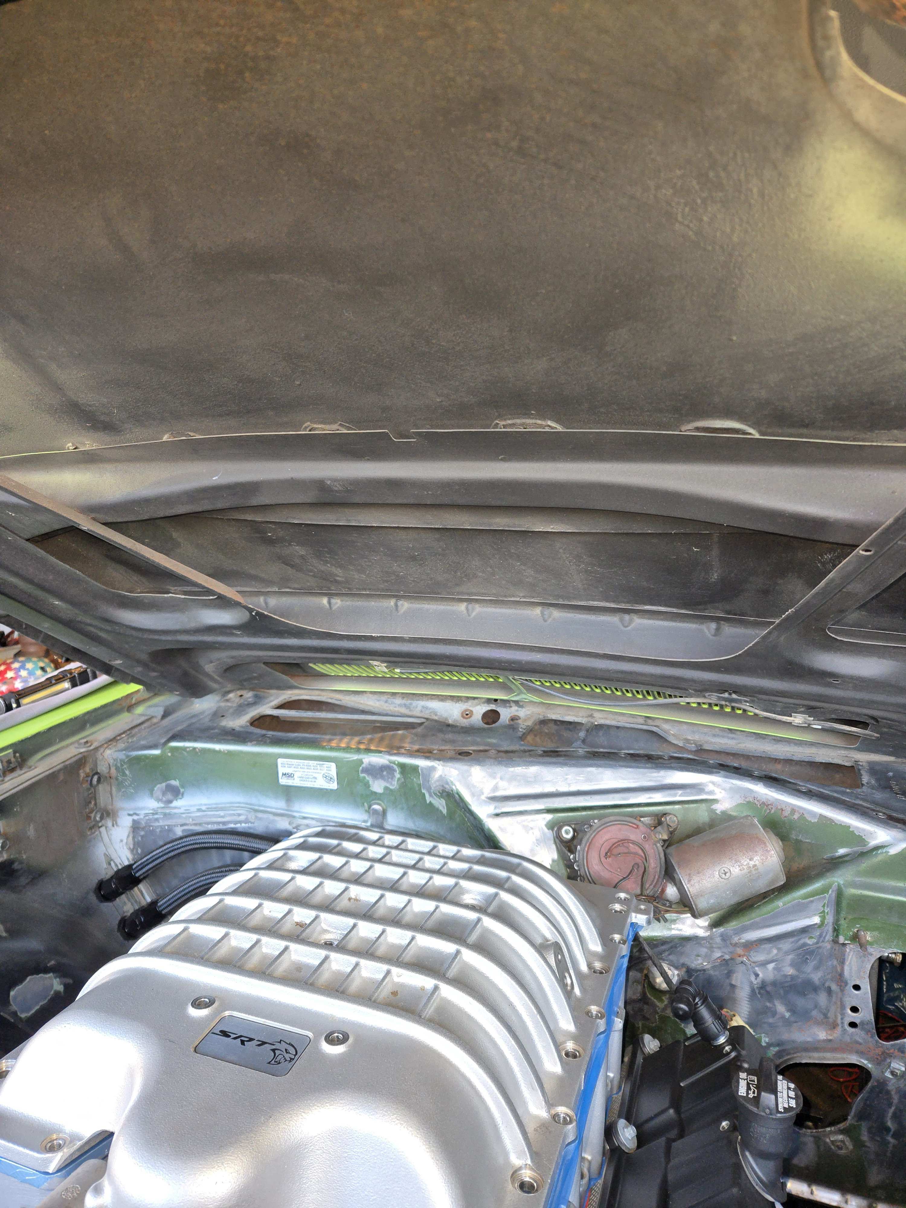

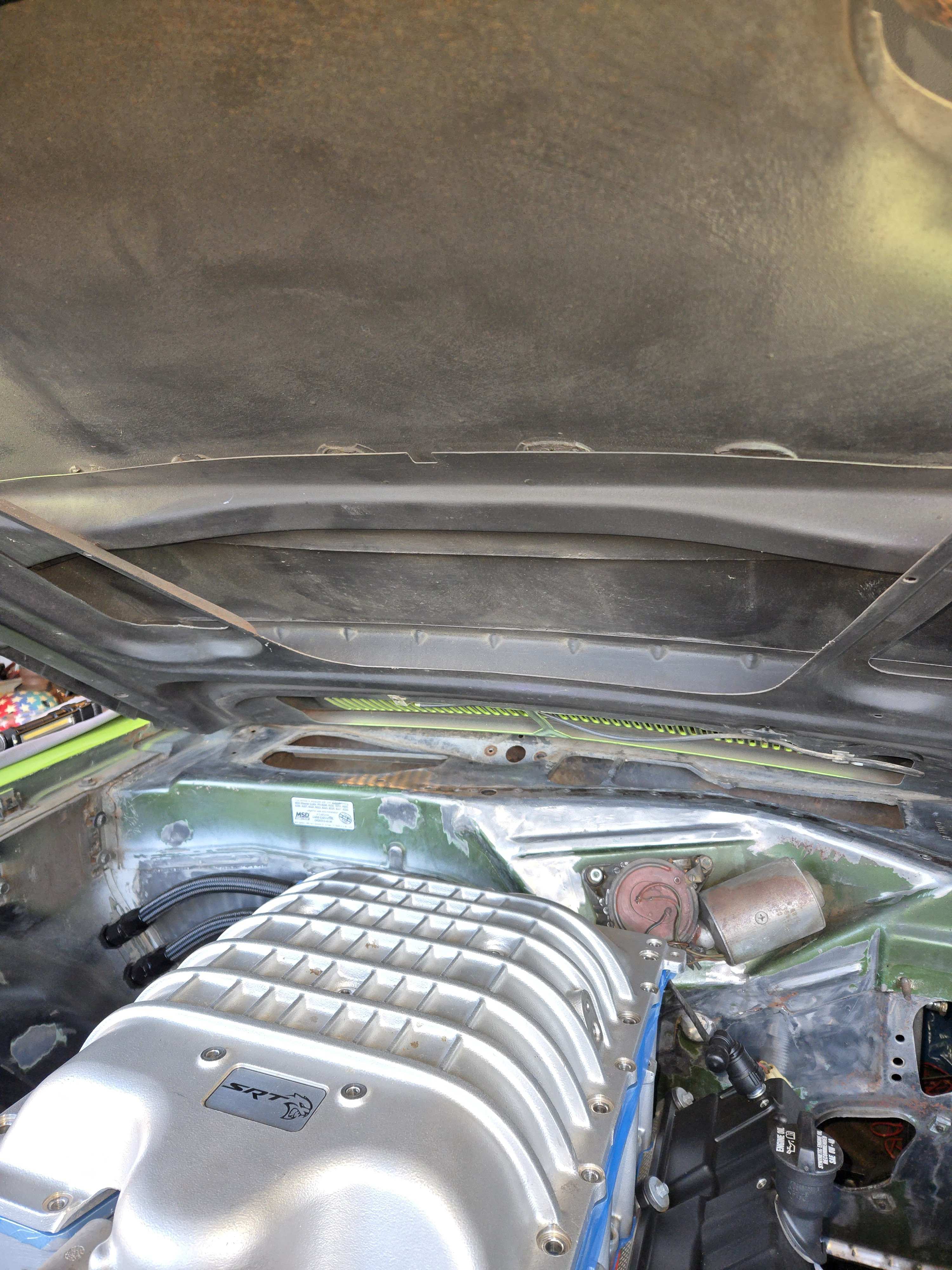

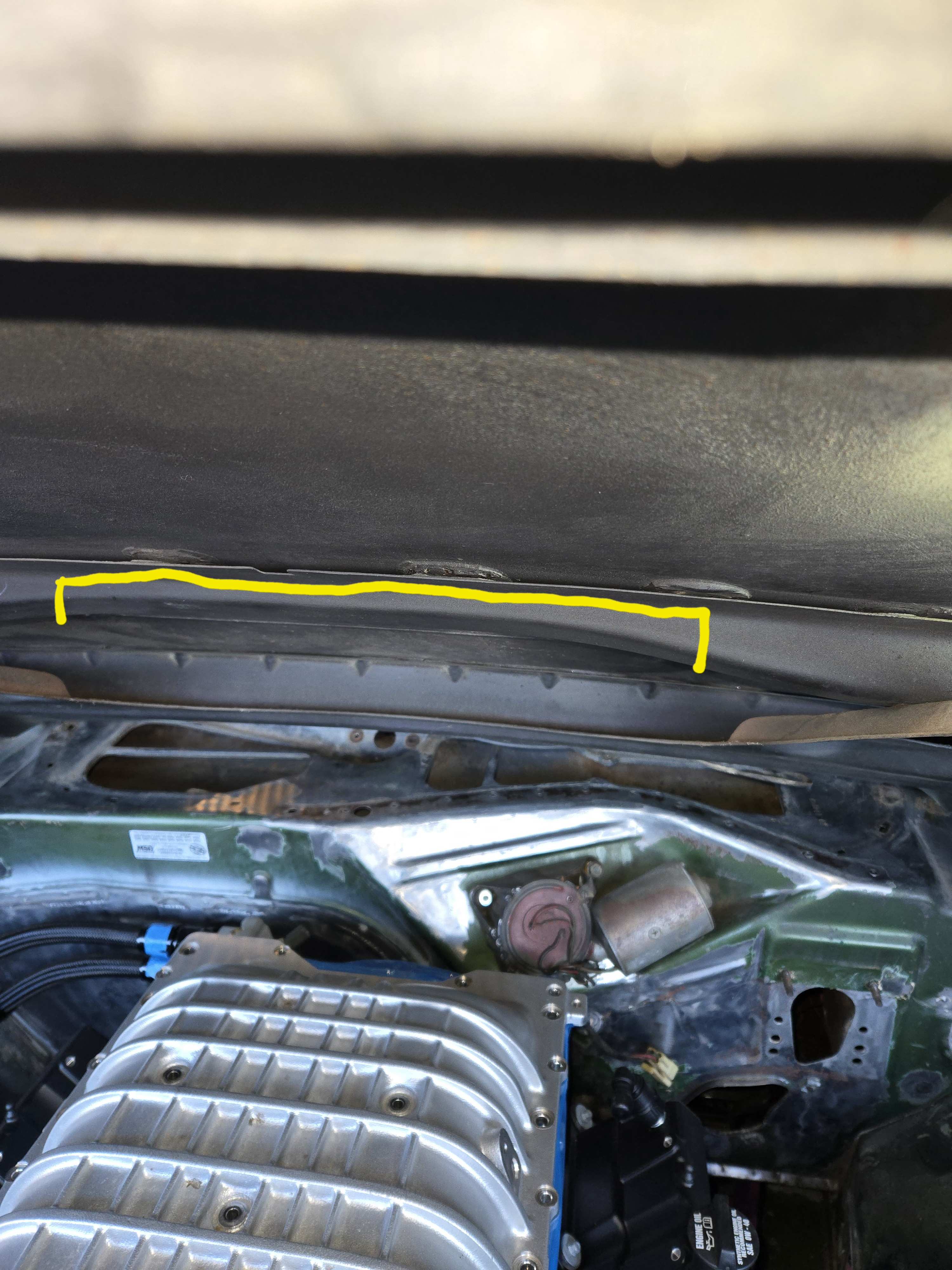

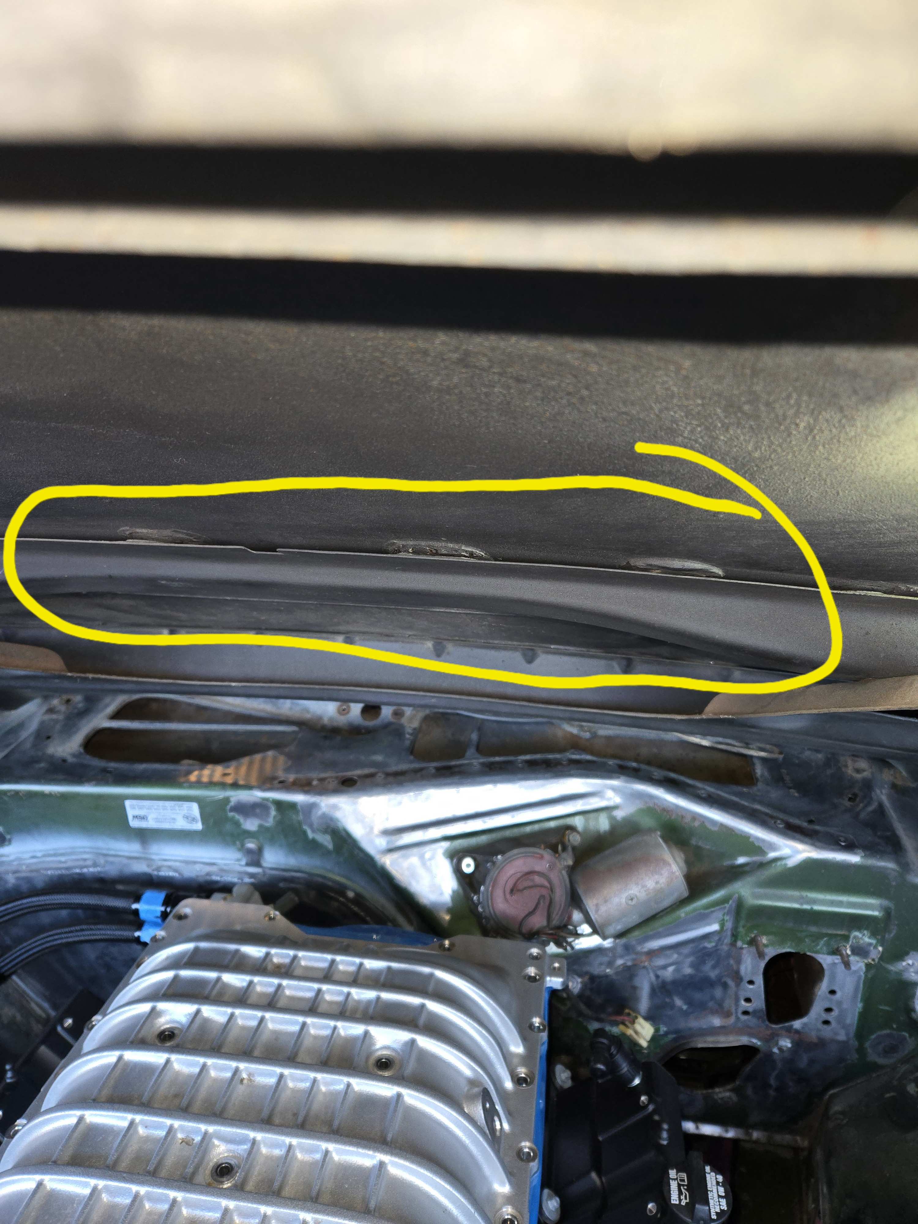

Hey all, been a while since I posted here. I ran into a little snag and need some advice. I want to run blower spacers to help reduce heat soak and IAT temps. I cut some blocks that are the same height as the spacers and the middle hood support hits the supercharger. It really only needs a 1/2" to clear. Does anyone have any suggestions on how to cut out where needed but still keep it somewhat rigid? Wondering if I could cut it flush and maybe tack weld a thicker piece of steel to reinforce it.
What have you done for extra clearance?
I would put 1/2 inch spacers on the K-frame and call it good. Especially with RMS front, you aren’t even messing with torsion bar angles. Only thing is, I don’t know if you already drilled all the holes for the RMS setup.

Everything is in and mocked up.
