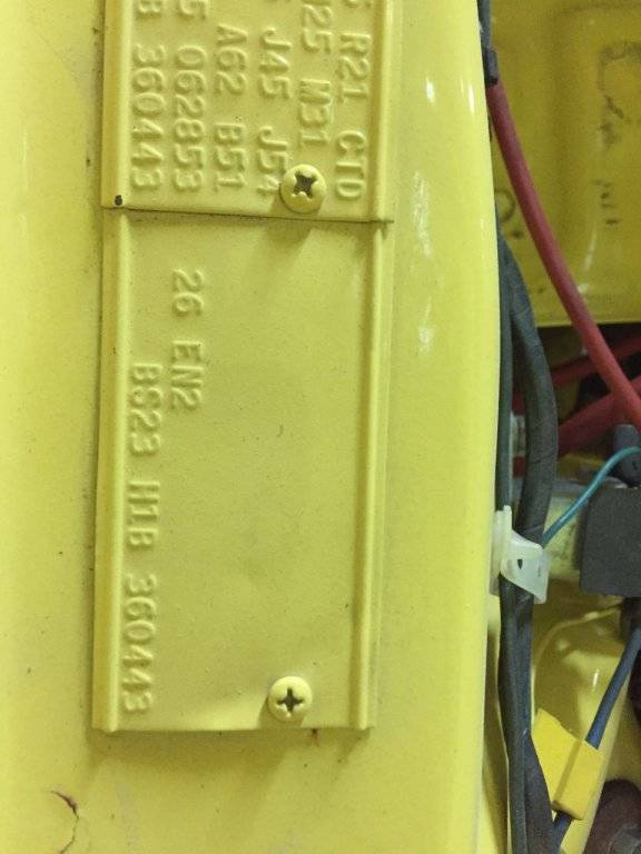

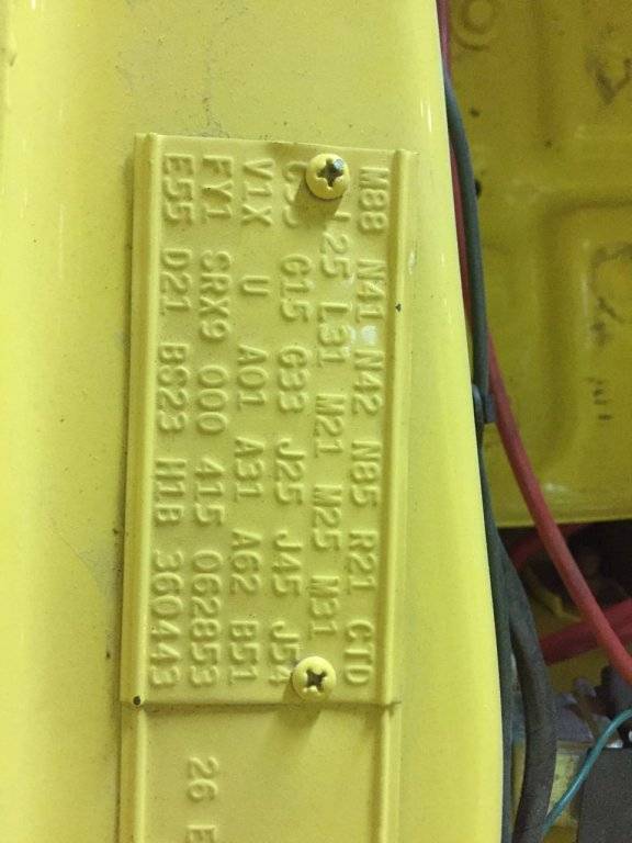

Also check the fender tag for N85 (tacho) or A62 (rallye instrument panel cluster) my Challenger came from the factory with a rallye dash and has both of these codes on the fender tag.

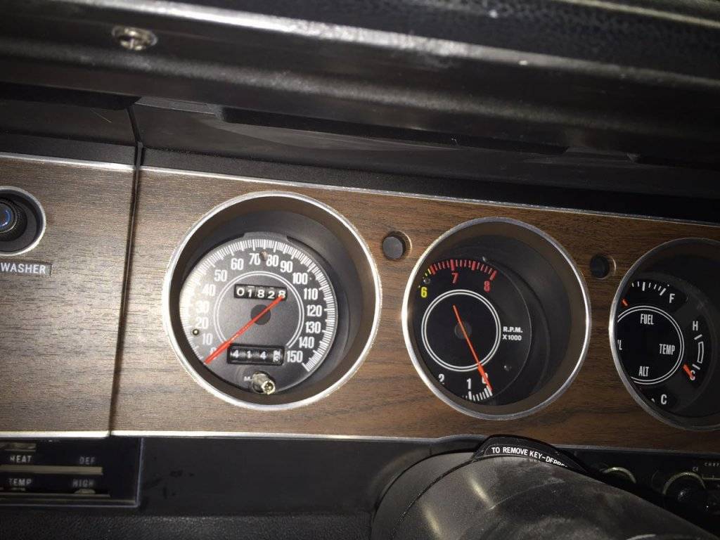

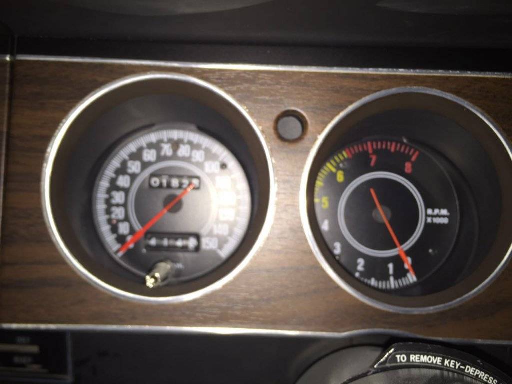

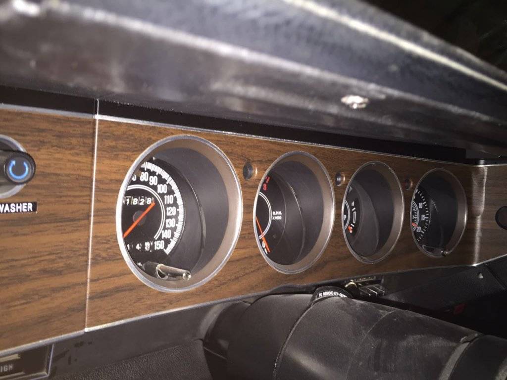

So is the dash completely missing and you just have wires ? If you have any pictures of the dash or heater controls we can give you a positive answer instead of a guess.
the complete dash is there on the car with the original wiring,just want to replace the dash wiring,i will upload pics in the evening
js29
Aug 5, 2012
671
152
lee center ny 13363

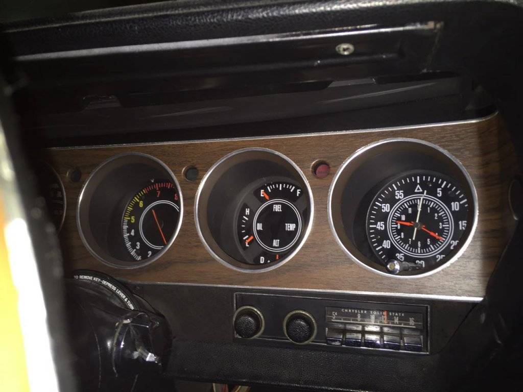

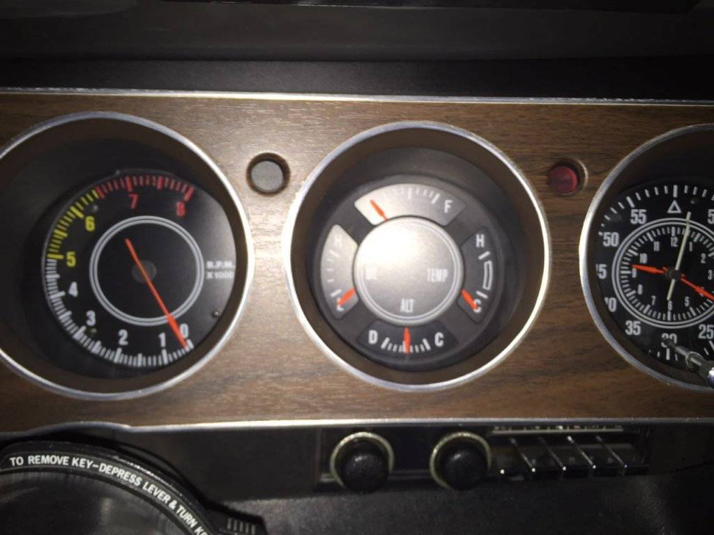

That is A nice dash cluster, but it for A 1972-74! reset knobs in the Wrong location, seat belt warning lamp in right corner. 70-71 reset knobs protrude through the bezel and no seat belt warning lamp.

any way i can confirm this mate?was told this is all original car
