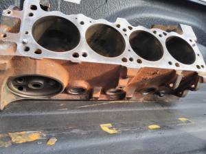

So, the Dakota blocks won't work? I am sourcing through a private party...and I think it's from a 1999 Dakota. Had 138k on it...but std bore. If I bore to .030 over what will the Cubic Inches be?Thanks for your help as I am a newbie to Mopar.

I am very confident that any Magnum will work in your application. I am not sure about the Dakota engines being different; not impossible but doesn't make a lot of sense but stranger things have happened. Even if this is the case, a Dakota 360 can be used in your car.

The only difference is the Dakota used the mid mount provision. It only an issue with the exhaust manifold, or headers hitting them. They can be ground down if clearance is a problem.

in your picture you can see the 3 bolts around the center frost plug for the mid mount but that block also still has the front mount provision , I am not positive all do have the front mount also . If the front mount is not there it will not bolt into your car using the mid mount .
The Ram truck 360 would be fine , the .030 over bore would only gain you 4 ci approx & if you go to a stroker I would keep the bore as small as possible to retain wall thickness .
