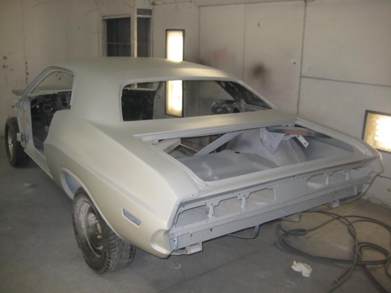

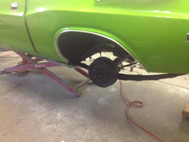

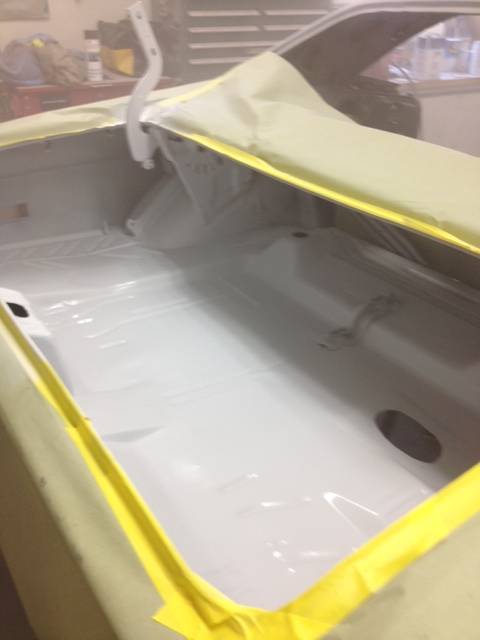

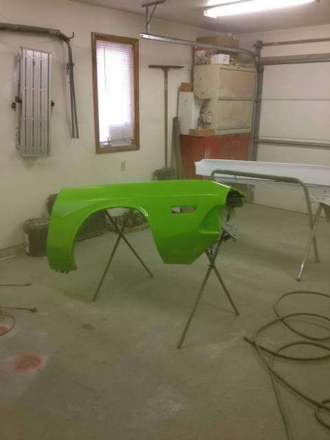

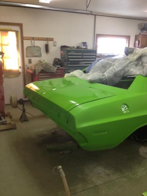

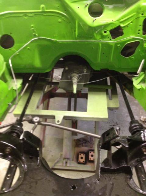

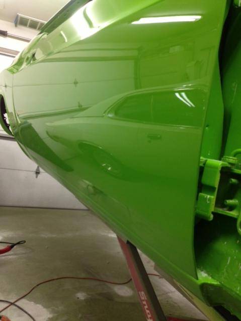

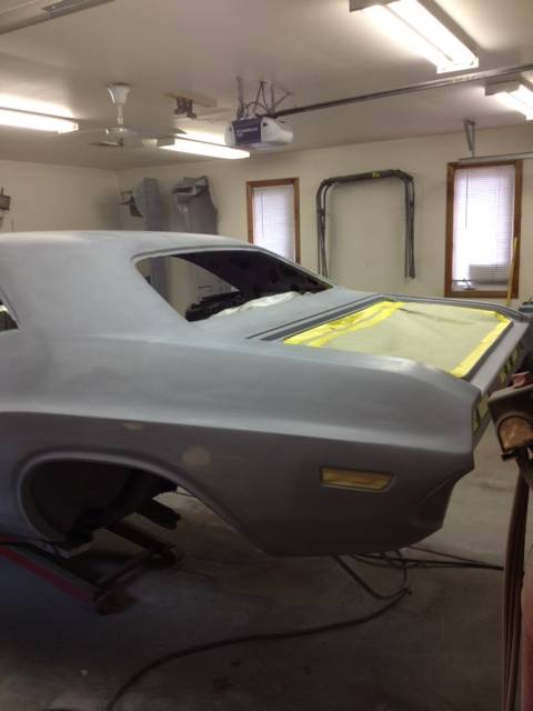

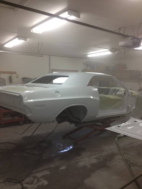

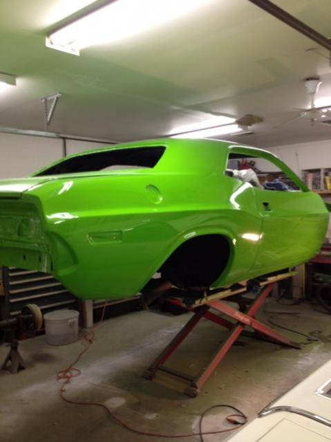

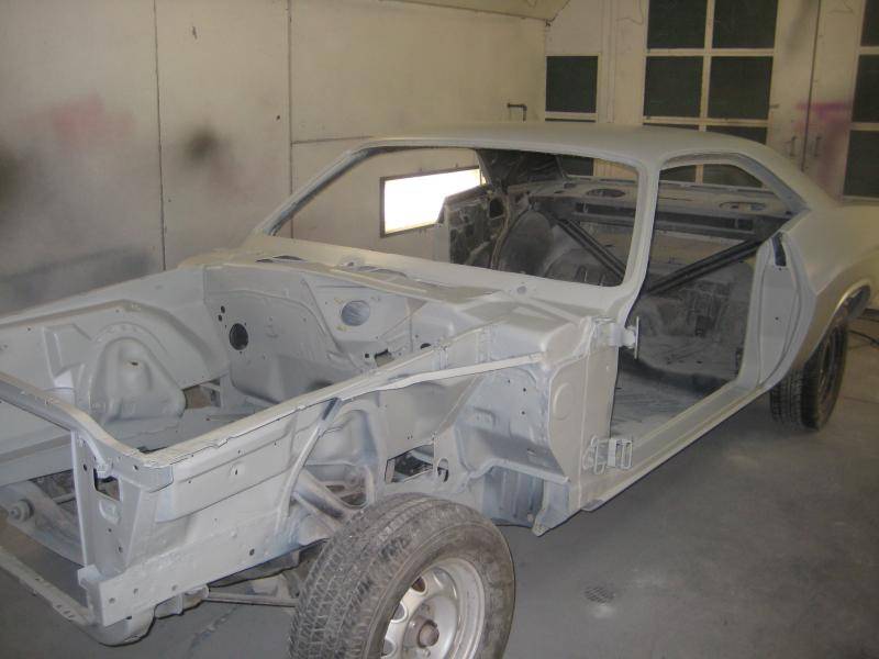

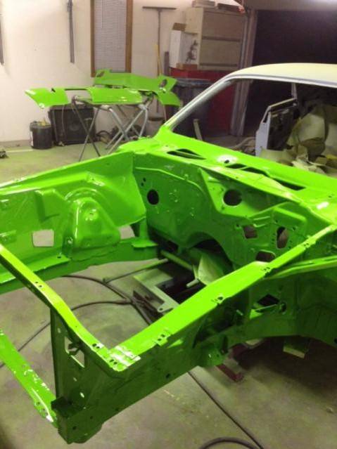

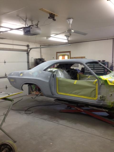

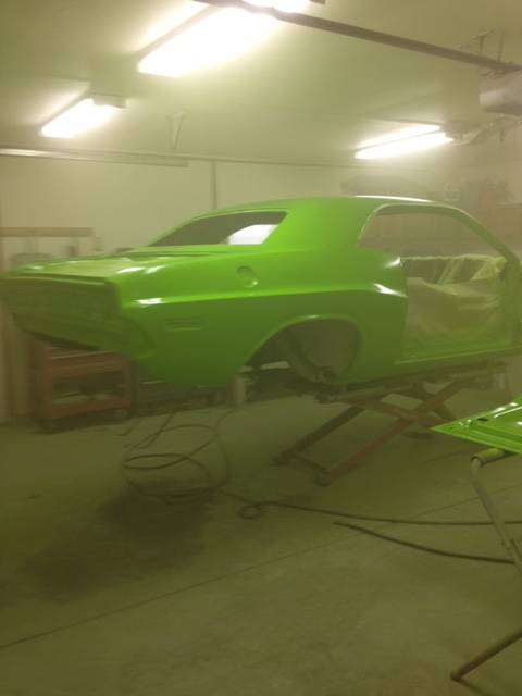

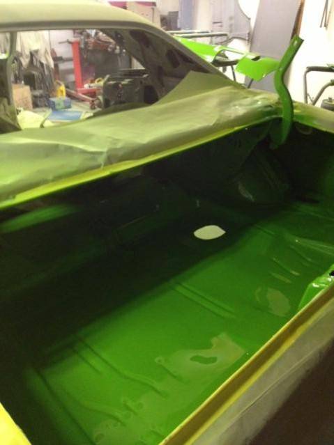

Well I am starting this kind of late in the build. Here are some pics of my 71 Challenger. I had already done all the metal work including floors, trunk floor, trunk gutters, dutchman panel, and rear quarters. Once all the metal was welded in and ground down, I leaded all of the seams and just had to do a smooth coat for any small waves, or low spots. Once that was done, the car was 2k primed, blocked, polyester primed, blocked, 2k primed again, blocked, and finally sealed with white sealer. Then the green was laid down with 4 coats, and 5 coats of clear was applied, and then blocked down. Now I am putting the body back together.

All the pictures are rotated for some reason. They are not rotated like this when they were saved. Not sure what the problem is.
Give me a little while and I'll edit the post so that all the pics are upright.
Love to looks of the paint. Really pops

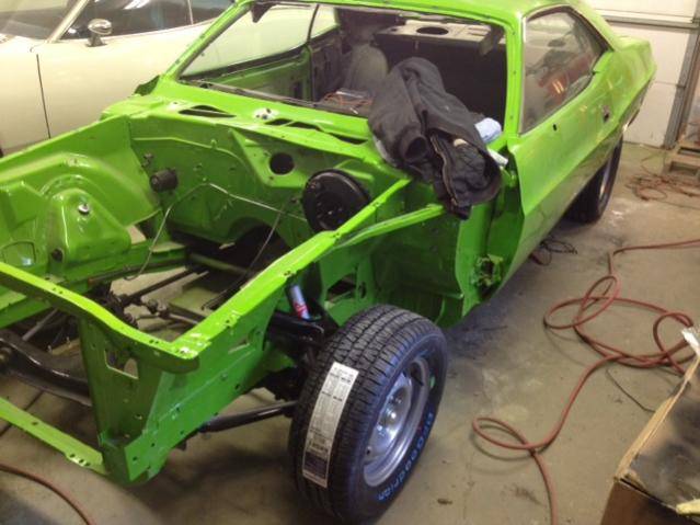

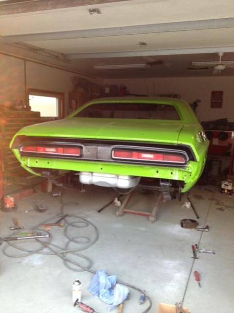

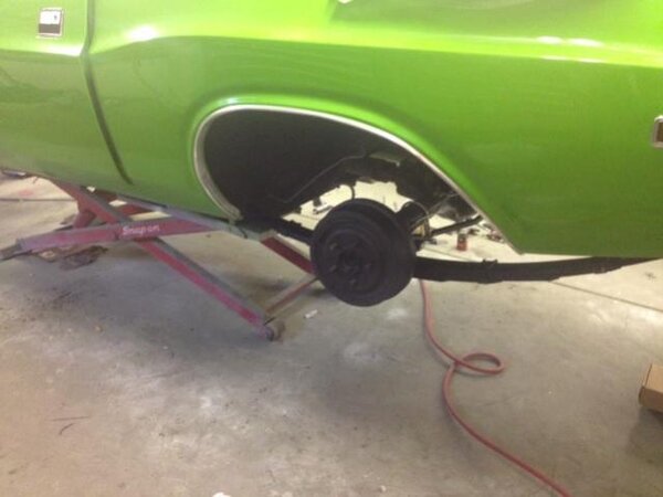

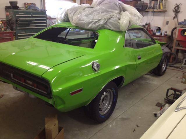

Here are some more. Got it back on the ground and the dash in it. Tomorrow will be the steering column and prep the motor for install next week.:icon_pidu:photo-15.jpgphoto-16.jpg

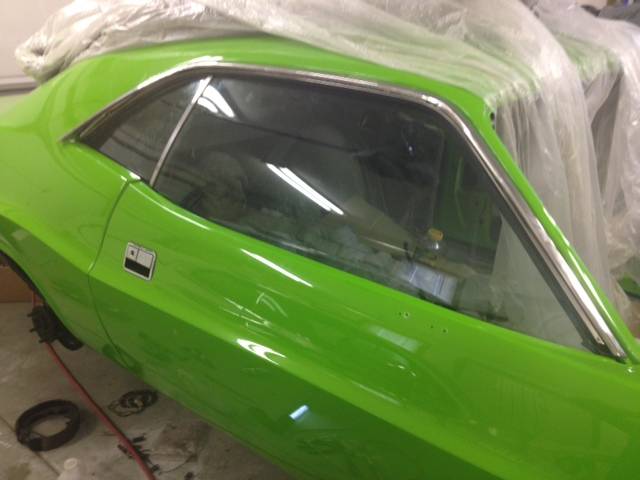

Didn't get to the engine as planned last week, but did get all the glass, window trim, package tray, rear quarter interior panels, sun visors, rearview mirrors, and the engine electrical all put in it. This week, gonna pull the trans and bolt everything up to the engine so I can put it all in at once. Anybody want to help?
