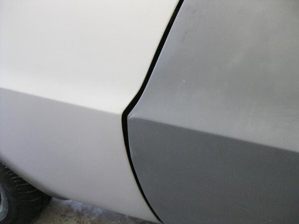

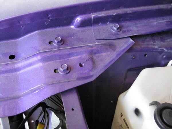

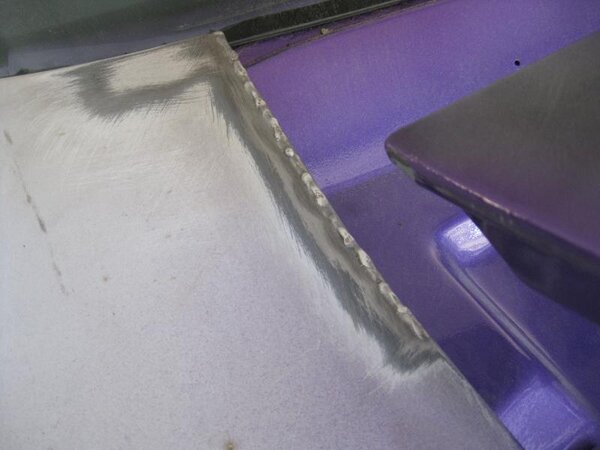

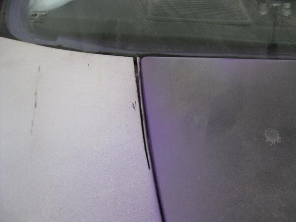

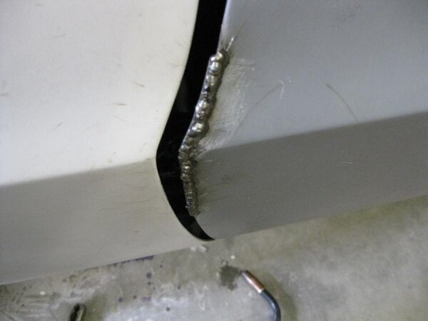

I used AMD floors, trunk pan & lid, roof, left door skin, firewall, wiper cowl, & hood, on my Challenger. I expected all the panels to need some massaging, and they did (the roof skin was excellent). I used Goodmark fenders (I dont remember why). Anyway both fenders did not match the contour of the doors at the body line (one door was factory the other was AMD) see pics. Also these fenders do not have a factory style thread insert for the hood height bumper bolt. Lastly, my driver's fender was bowed out along the hood gap at least 3/8th making the fender too short to use... Ouch I hate wasting $500. for nothing. I recommend you guys use only one brand for all the parts and inspect them very, very carefully... my build http://ImageEvent.com/adamell/wiperparts IMG_2918.jpgIMG_2921.jpgHood gap 2.jpgHood gap 8.jpgHood gap 5.jpgHood gap 13.jpg

its been my experience that one should use a single supplier. either way. im not partial to any one or another. thier respective r&d departments usually do a good job of making thier own parts match up pretty well. just my experience. and ive used em all.
sounds as though your fenders have been your biggest issue at this point. I believe you said those were from Goodmark? Yeah, I agree if your using aftermarket body panels, at least try buying them from same company. I'm hoping AMD has some decent stuff when I am ready to buy from them.
