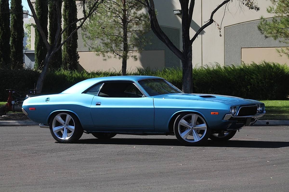

I wonder how they mounted these 20x9 Srt8 rims on this e body?

moparroy
Dec 25, 2020
16
7
Rockwood, Ontario
So also interesting to note that the center bore on the late model Challenger SRT wheels is very very close to the 70's e-body. Late model is 71.5 mm and the '74 for example is 71.6 mm - that's 0.004" difference only. So if you put these wheels on - being aluminum - the center bore might fit tight enough to properly center the wheel. And like I said above - although not the same - I suspect the lugs on a '74 will go through the late model wheel (I only did it with a brake disc). I would think you could likely tighten the lug nuts too - but they would not seat properly. Although the lugs would not center the wheel themselves - the center bore might so it might even drive fine for a while. I would think lugs would be at high risk of coming loose being not fully seated - certainly could be done for a photo op - but I would not drive it! (short of proper adapters maybe) My opinion - they really should have stuck with 114.3 or 4.5" pattern - or chosen something very different like my wife's 2013 T&C at 127 mm - which is also exactly 5". Having them so close ... invites trouble to me.
