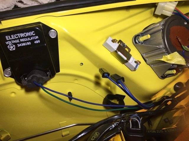

    Extra hole between the Ballast Resistor and Regulator. Did a quick check of other E-Bodies online and don't see it. Not sure why I'm just noticing this now.....
    1970 Challenger Convertible. Built April 27 1970.
    Hoping it's factory, but who knows with Mopar......
    Thanks

  3. doubleyellow
    doubleyellow Well-Known Member
    Messages:
    151
    Likes Received:
    13
    Joined:
    Aug 3, 2015
    Location:
    Metro Detroit

  6. doubleyellow
    Messages:
    151
    Likes Received:
    13
    Joined:
    Aug 3, 2015
    Location:
    Metro Detroit
    Thanks guys.....looks like I have to take care of that.......

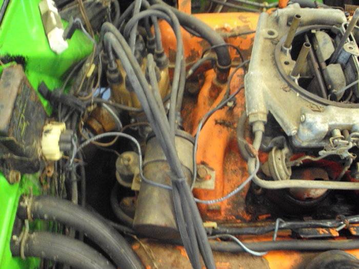

  7. aussiemark
    aussiemark Well-Known Member
    Messages:
    897
    Likes Received:
    239
    Joined:
    Nov 29, 2014
    Location:
    Perth Western Australia

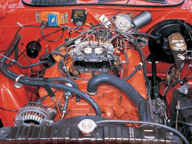

    I think I can see it in the EV2 340 engine bay in the last picture looks like it is for a wiring support. I will check my cars and get back to you.

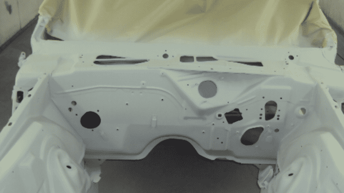

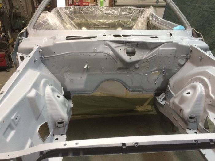

  9. RJHJR
    RJHJR Active Member
    Messages:
    42
    Likes Received:
    16
    Joined:
    Oct 14, 2013

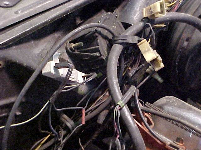

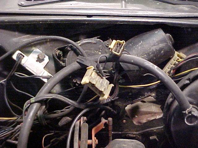

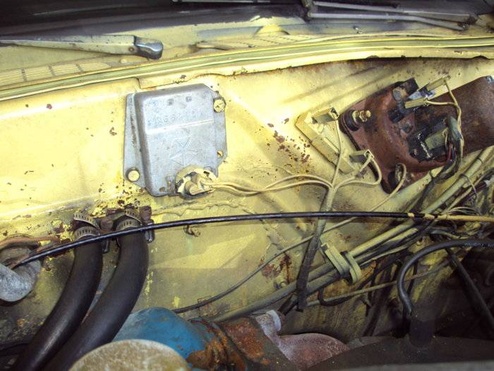

    It is for the black loop wire strap. Wiper fluid hose and heater control go through it among other things. My non AC cars have it plugged but I don't think its original. My AC cars do have the black loop. These pictures are of two 70's and a 71 form before they were touched. 9Dec2010 043.jpg DSC04175.JPG MVC-186F.JPG MVC-188F.JPG 9Dec2010 043.jpg DSC04175.JPG
