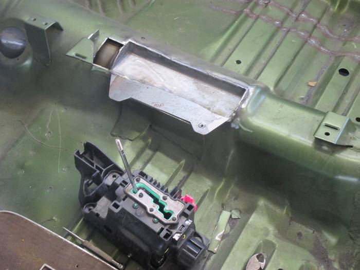

Everything has been re-engineered/modified. The shifter is already recessed into the trans tunnel, with welded mounting points.

What have you decided for the start button? The ign switch in the column won't work. If you turn to on, and then crank there is a short delay that will wack out the computer. It needs 12V to stay on uninterrupted. I was looking to use a separate pushbutton to crank the motor. Any better ideas you have would be something to consider. I did the NAG1 also so I know about the sensors and extra modules. What a pain. Also what rear end gears ratio are you using? It needs highway gears for the nag1 unless you want to be in 3rd gear before you get out of the driveway :)

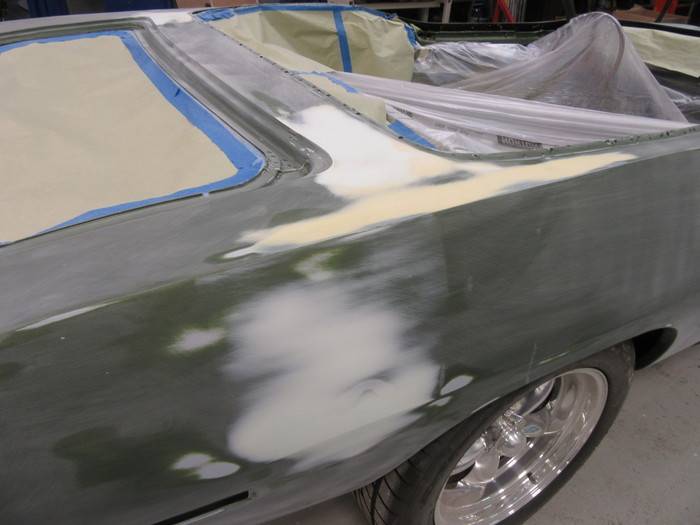

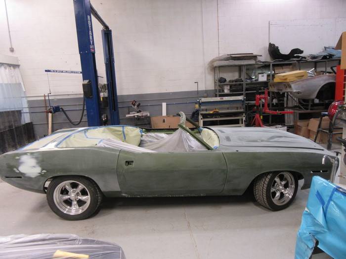

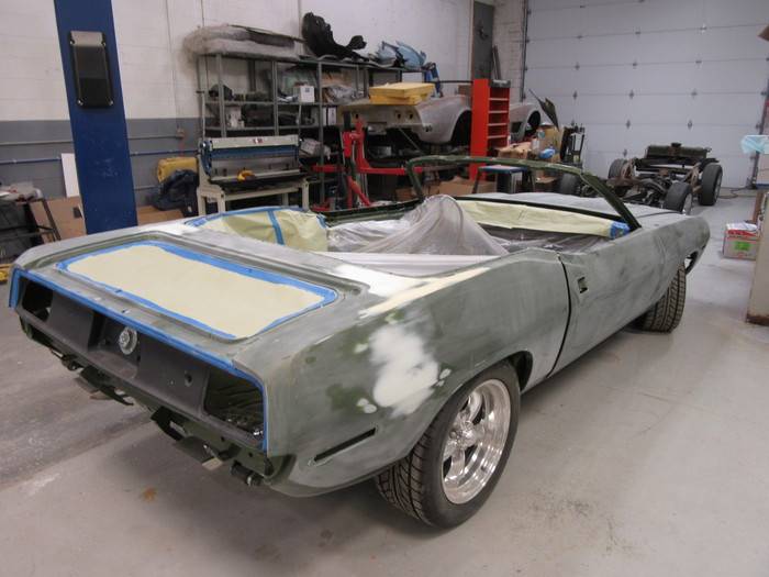

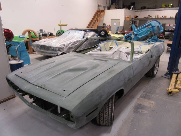

Well, the `cuda didn't hit the paint-shop till 2 weeks ago. I just left there a couple hours ago.....color, next week. 12 years of sitting and moving the car around, took it's toll. My head wasn't into the car....then I decided to update the mechanicals. It really got my creative juices flowing again.
