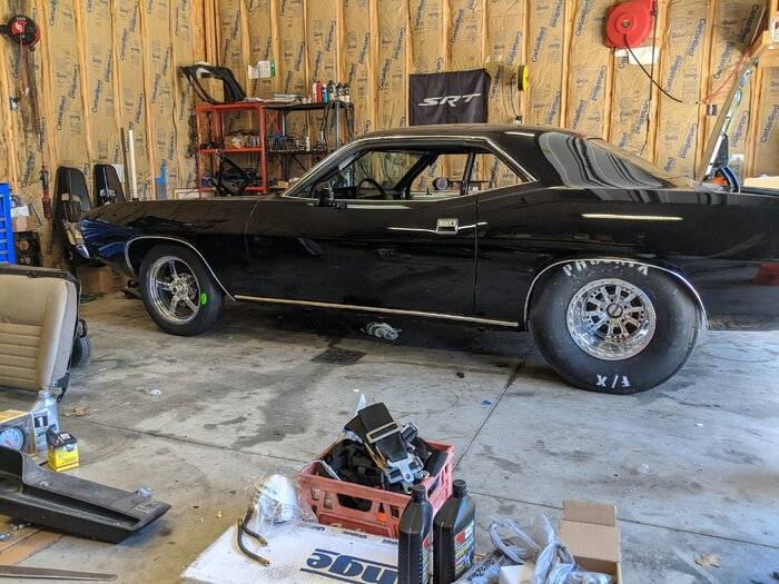

My? Body is a 73 Cuda. I've owned it since 1979. Drove it on the road and raced for many yrs until in a moment of stupidity decided to back half the car and turn into a dedicated race car in 1988.

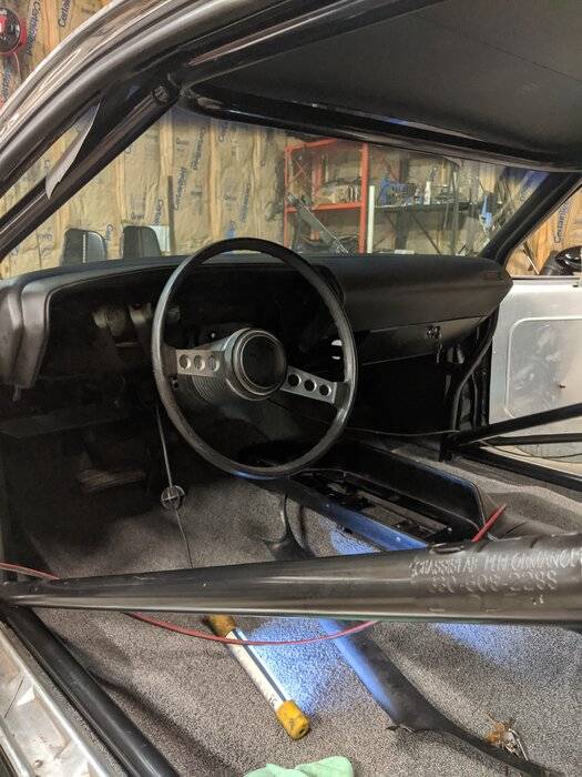

Fast for ard 20 some yrs and I'm now putting rhe stock dash back in and while still racing the car putting it back on the road.
Th vehicle has a new chrome moly cage, replaced aluminum dash with a factory one, replaced my old auto drags with RC Components wheels, adding a KB wedge 553 with Indy 572-13 heads which is going together at Marsh Performance. Its been a long road but it's coming along nicely.

Nice ride man! Definitely got those fender wells stuffed. That's the way they should look. Gonna be 1 hellava pro street machine.

Sweet paint! Love that fat rear end look! More details on the car if you would please.
Car was a 340 when purchased in HS. Purchased for $500. Replaced both 1/4's, and found a replacement trunk lid at a salvage yard. This was all completed in the summer of 1979. There was no other rust on the car.
I drove the car in nice weather until 1984 when I started college. I continue to race the car thru 1987. Then decided to add subframe connectors and SS springs. Well the shop that did the work crushed the frame rails. These were nit available so I back halfed the car, installed a cage, aluminum interior and dash. I regret this to this day. But in 1988 these cars were still worth next to nothing and there really wasn't any aftermarket support.
Fast forward 30 yrs, put factory dash back in, kept most of the aluminum interior but it is now carpeted and the aluminum side trim is wrapped in a carbon fiber wrap(still have ro do the doors).
Mechanically it will be a KB wedge block, bored 4.50, stroke of 4.35. The crank is callies, rods are Oliver Ibeams, 7.1 with 2.20 at the crank. The cam will be spec'd by Todd Marsh and will be around .800 dor rhe intake, unsure where the exhaust lift will be or duration of the cam. Compression will 13.5-14.1.
Heads are Indy 572-13. They are being ported by Larry Smith and machine work for the block at Buck Racing Engines. All told this combo typically ends up in the low to mid 900hp range.
The rear is a dana with4.30 gears, trans in in the air but may end up being a glide with either a ATI case and bell or a Ried. I'm tire limited to 30.5" and won't cut the wheel wells.
The rear rims are RC Components 15x12.5". I have wilwood brakes on all corners. The front rims are also RC Components but 17x4.5 to clear the 12.19 wilwoods.

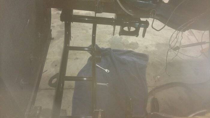

The car has a gerst tubular kframe. Thats about it for now.
