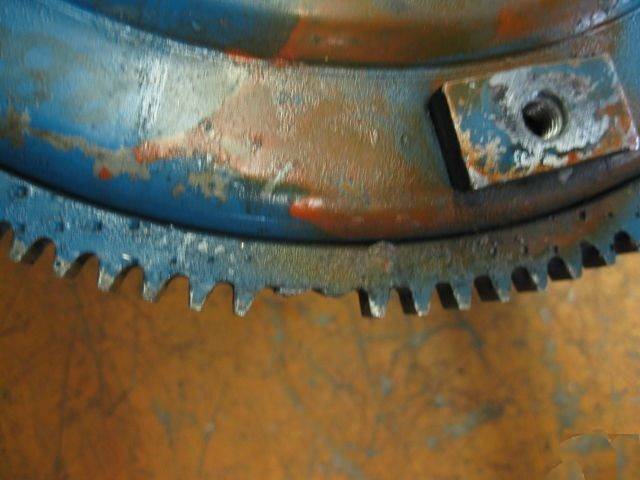

Ha, I thought this only happened to me. Had a Remy starter (25215 I believe) on the car at that time.
