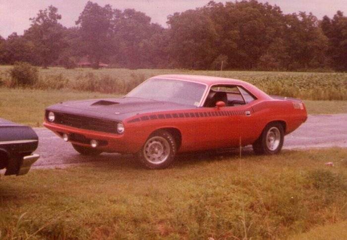

New to the site, I am restoring AAR cuda, Need some advice on what manufacturer of sheetmetal have you found to work best. Looking for 1 pc floor, 1 pc trunk.
Late 70's thanks for the inputWelcome aboard , general consensus would be AMD. When was the picture taken ? Looks nice
Thanks for the input!Challenger
